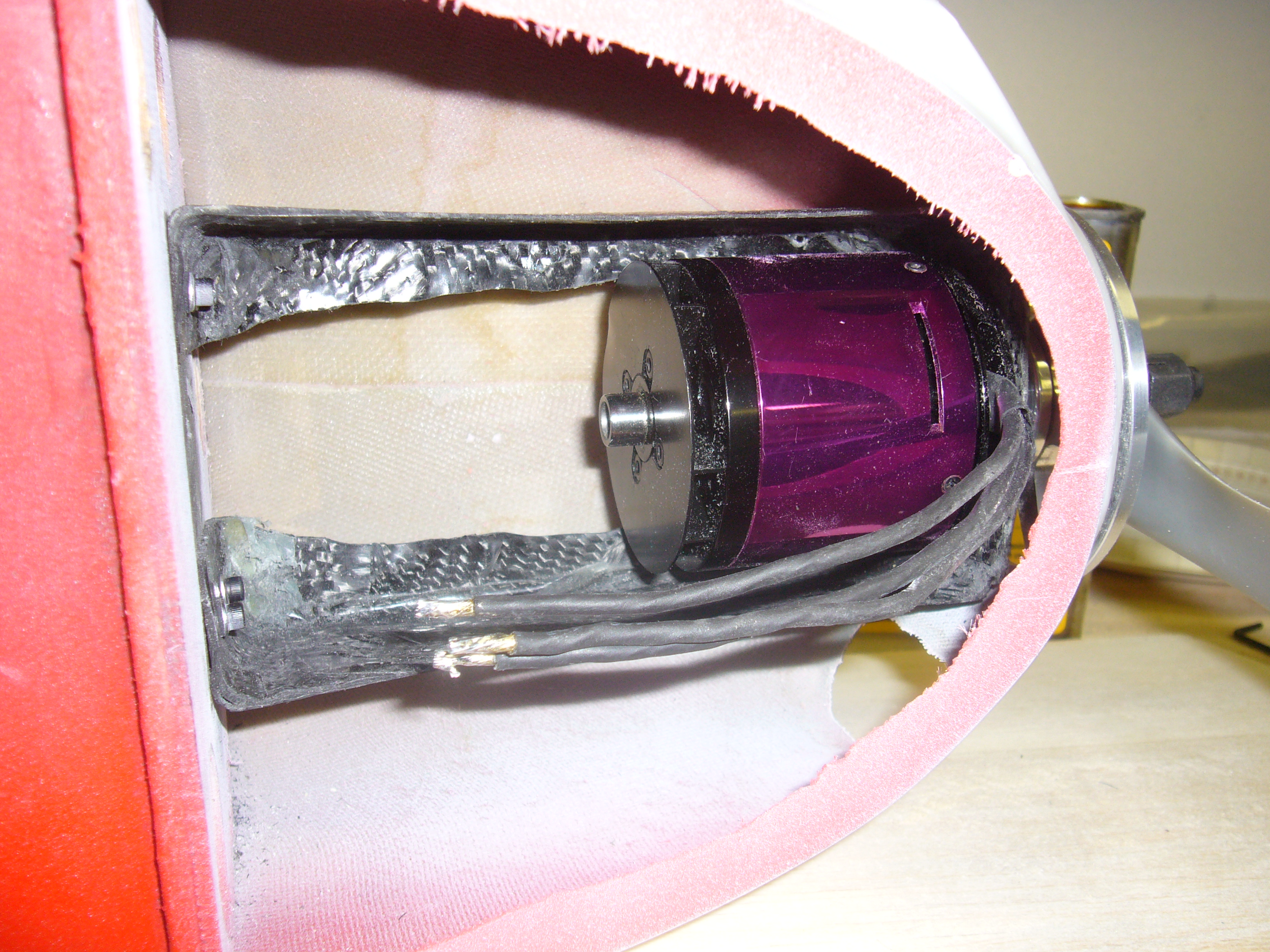

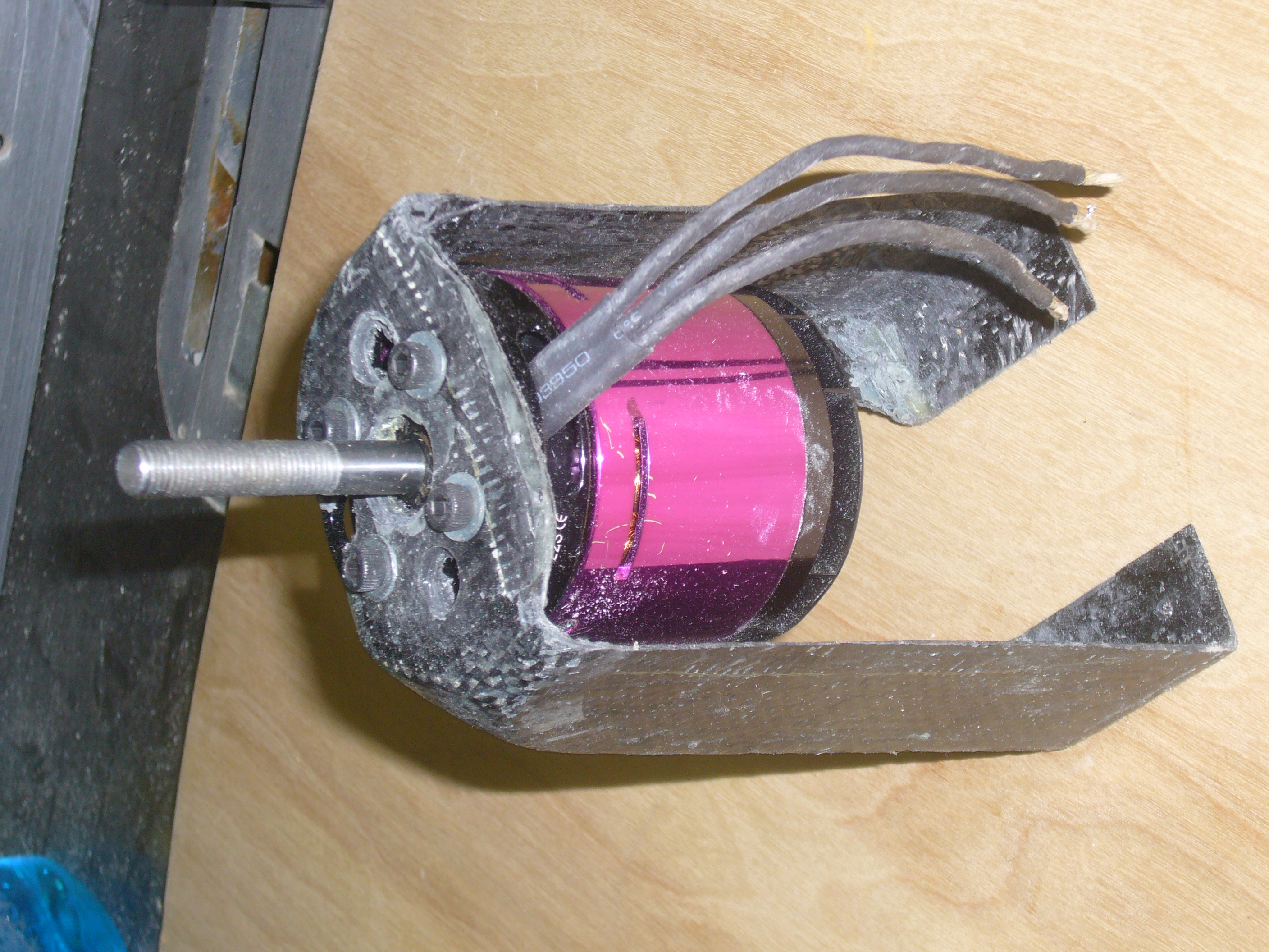

Here are some pics of the CF mount with the Hacker in it and also mounted in the plane

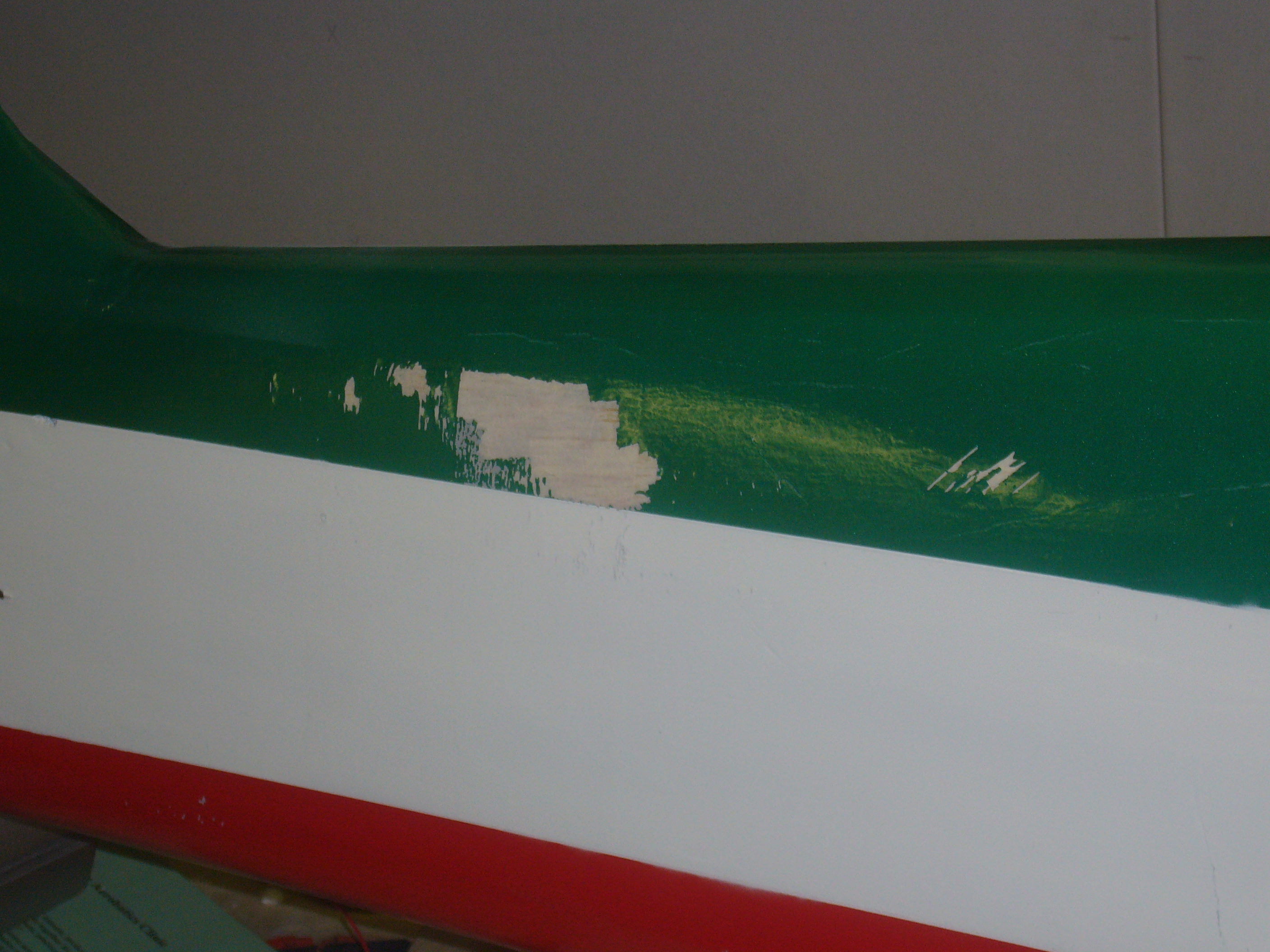

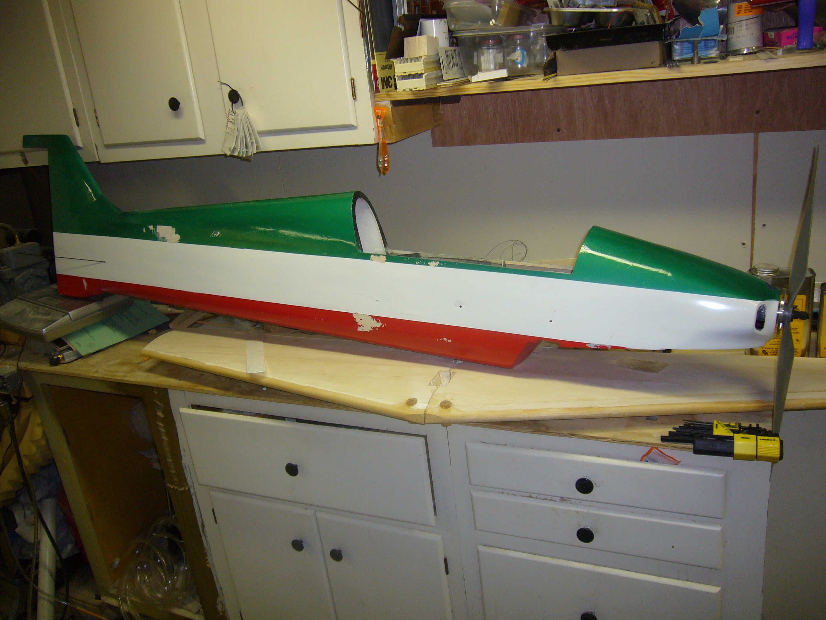

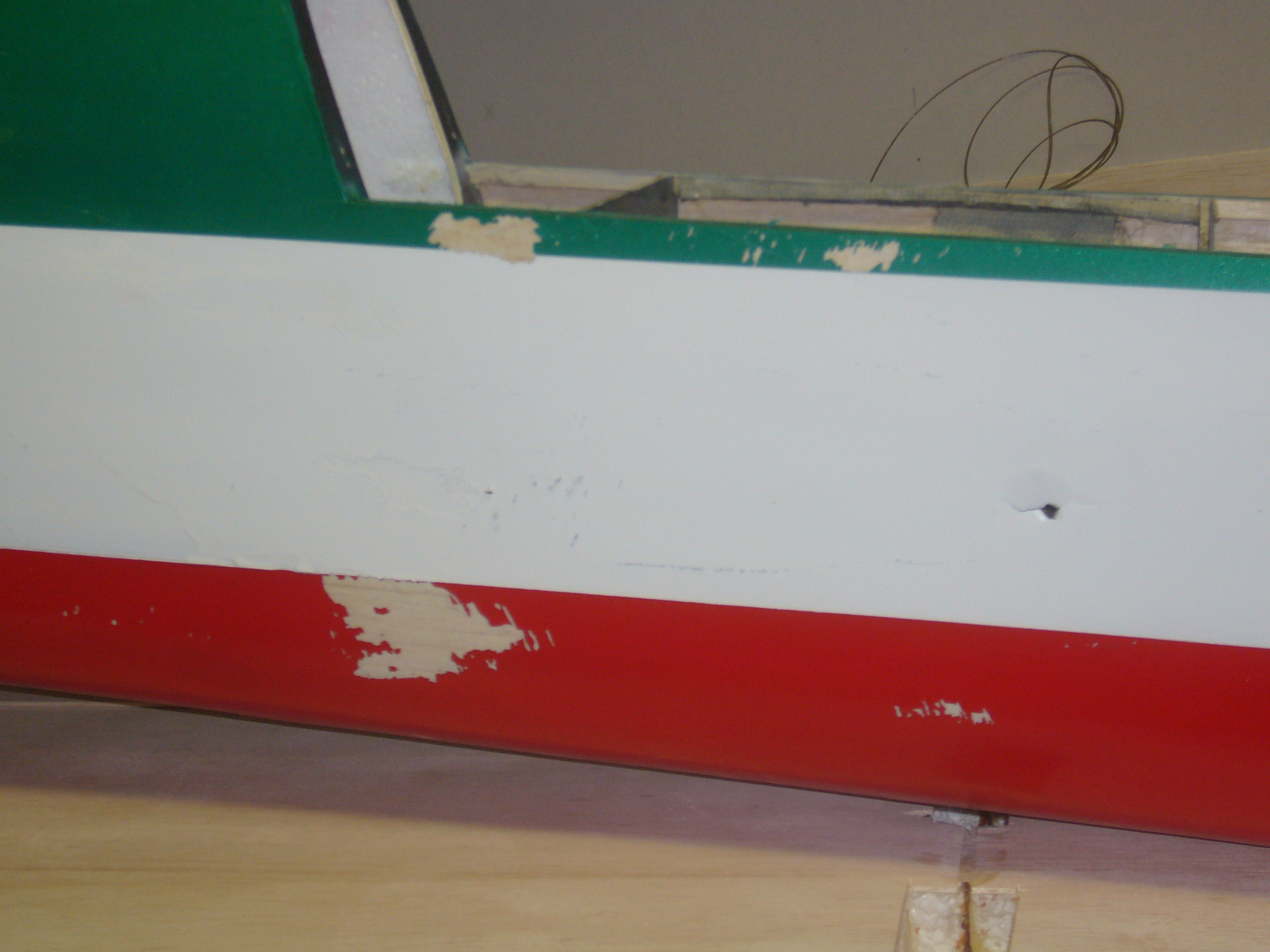

This what happens when you use masking tape that isn't fresh....now th echoice as to whether just cover up th edamage with some quick spray work and fly or take what will amount to a month and sand and fix it properly.....

Yea Chuck, it does....I'm really unhappy about it. I think it's going to be a quick paint cover up and fly job. At 150 meters no one will be able to tell. I am feeling rather disenchanted at the moment.

Default RE: Black Magic VF3 E build thread!
did it Take the glass with it? Also, Unless you are in a big hurry to get it finished I would just re- shoot the bad spots where the paint lifted. What masking tape did you use?

Pete, as other friends have told me.. put that part to the side, then come back and get it done, it will go quickly!
Keep yer head up and get it done!
