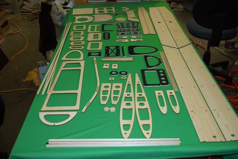

Items needed:
This is what you need to complete the framing of the kit.
-PBG C/F 7/8x30" wing tube and socket
-PBG C/F 7/16" stab tube and socket
-2 gator style wing adjusters
-2 Gator style stab adjusters
-landing gear of choice (ES long gear works best, alternative is Comp ARF Integral or Impact gear)
-Wheel pants (small)
-2 BVM style hatch latches
-motor mounting system (Esprit/cambria or "X" mount)
-36 pieces 1/16x4x36" contest balsa (LIGHT!)
-2-3 pieces of 1/16x4x48" contest balsa (LIGHT)
-3 pieces 1/8x4x36" contest balsa (LIGHT)
-2 pieces 1/4x4x36" contest balsa (LIGHT!!!!)
-2 pieces 3/8x4x36" contest balsa (you get the idea)
-1 piece 1/2x4x36" contest balsa (ditto)
-1 piece 1x4x36" contest balsa (getting the picture?)
-1 piece 2x4x36" contest balsa (this one can make or break ya)
-1 piece of 1/8" light ply for misc stuff
-West system 105/205 resin for sheeting OR
-polyurethane glue (You BETTER know what you're doing with this stuff!)
-various CAs (mercury adhesives makes some really good stuff for composite bonding, M100XF)
-Straight, flat table
-72" straight edge (available at any hardware store)
-various sanding blocks, permagrit files, etc
-Fuselage jig (optional, but VERY nice!)
Now that I have been using the perma grit files, I don't know how I ever did without them. Especially the round and flat files. They can REALLY make life easy.
I use a small hard piece of 3/4" MDF board wrapped in sticky back 80 grit paper for general building, as well as various blocks, bars etc. use the hard 80 grit blocks and the flat perma grit file for general fitting. For sanding sheeting, I use 220 grit paper on a 3m block. I also have a special 90 degree block I use for truing the edges of the wing and stab cores. I'll show you this later....

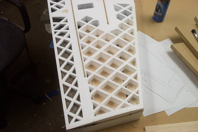

Prepping the cores
Foam is a funny thing. it has internal stresses and 'wet" spots that make life difficult. All you need to know is that the cores were cut weighted on a flat table bottom side down, so always do sanding, weighting etc with this in mind.
When foam is cut, a hairy melted foam crap is left on the surface and the surface is glazed. This needs to be sanded off, but not yet.
First prep the Wing, stab and rudder cores by marking and cutting away the TE 1/4" back and sanding it flush (CAREFULLY) with a sanding bar.
Now install the false ribs and run the wing/stab tube inside and check to be sure the hole is centered and clears the tube. Sometimes the hole for the socket is a bit tight, so wrap some sandpaper around the tube (not the socket) and twist this inside the hole until the hole clears the socket. it should slide freely, but not really sloppy.
Now locate the balsa insert point for the hard points. Cut them out and install pieces of balsa to fit.
Now glue on 1/4" contest balsa strips for the TEs, glue in the false ribs, and glue in the balsa inserts with polyurethane glue. This stuff needs to be FRESH and thin. Wipe off the excess with a paper towel. It should only appear damp. tape the TE in place with masking tape and let dry overnight (or while you're making the skins.)

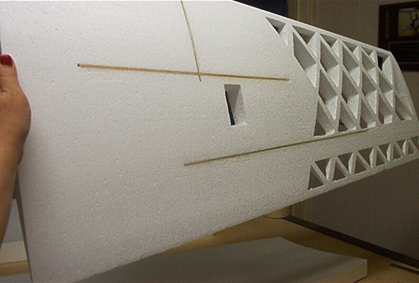

On to the wings.....
On an electric, every gram counts. You don't have the vibration of an engine to worry about, so you'd be suprised what you can get away with.
I like to honeycomb my panels on electrics. I use a different technique on my glow planes, but for the electrics I build, honeycombing the panels saves at least an ounce per panel and shows no ill effects. I know some who swear they can feel the ing twist in flight (I'm not saying they can't, but this plane doesn't seem to care). At any rate, I think it's worth doing.
We can do this for before we ship for a small fee, but it's easy to do yourself if you're well versed with it. Basically you use poster board templates and a small hot knife and just cut away voids in a geodesic pattern. You need to leave at least 3/8" at the edges, and don't get over into the load bearing areas like the wing tube or spars. A little acreful planning though and it's not too bad.
Next, sand the TEs flat with the foam core. be VERY careful and patient with this step so as not to dish the foam surface. What I do is use an 80 grit bar and get it close, then sand it flush along with the entire core surface with a hard 220 grit block. This is the point to sand all of the cores. just break the glaze and get it even, don't go crazy.
The spar slots should be marked. The easiest way to do this is to use a straight edge guide (like the side of a level) and a dremel with a router cage. Use a 1/8" router bit set a hair deeper than the 1/4" spar and just guide it down the straight edge. be careful and patient when you hit the false rib. After this is done, use either your perma grit file or better yet a standard 1/8" steel file from the hardeare store and run it down the slots. Test fit the spars and they should be snug but flush with the top pf the surface.
Sand ALL cores with a 220 grit block and then blow them off with an air hose or vacuum. Keep them clean for the sheeting process.

Old 07-26-2007 | 06:27 PM
Joined: Jul 2003
Posts: 315
Received 22 Likes on 18 Posts
From: Montevideo, URUGUAY
Default RE: Black Magic VF3 E build thread!
Hey Mike, nice color you choose to paint your thumb nail. LOL
Yust kiding, no offence.[sm=biggrin.gif][sm=biggrin.gif]
ID:	730440   Click image for larger version
Old 07-26-2007 | 07:04 PM
MHester's Avatar
Posts: 2,707
From: Woodstock, GA
Wife's hand
Arrgh didn't ntice that, used an old stock pic from the V2 thread for that one.
-M
Old 07-27-2007 | 07:34 AM
woodie's Avatar
Joined: Jun 2002
Posts: 1,148
From: Absarokee, MT
ORIGINAL: MHester
Wife's hand
-M
OH NO!! you weren't referring to your wife as 'old stock' were you? Man, are you in trouble........ ;-)))

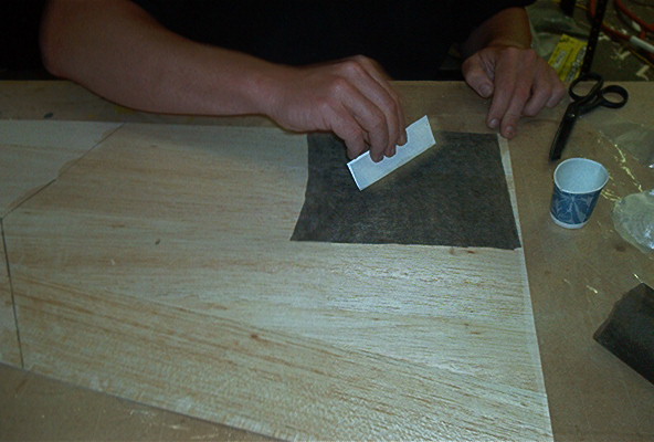

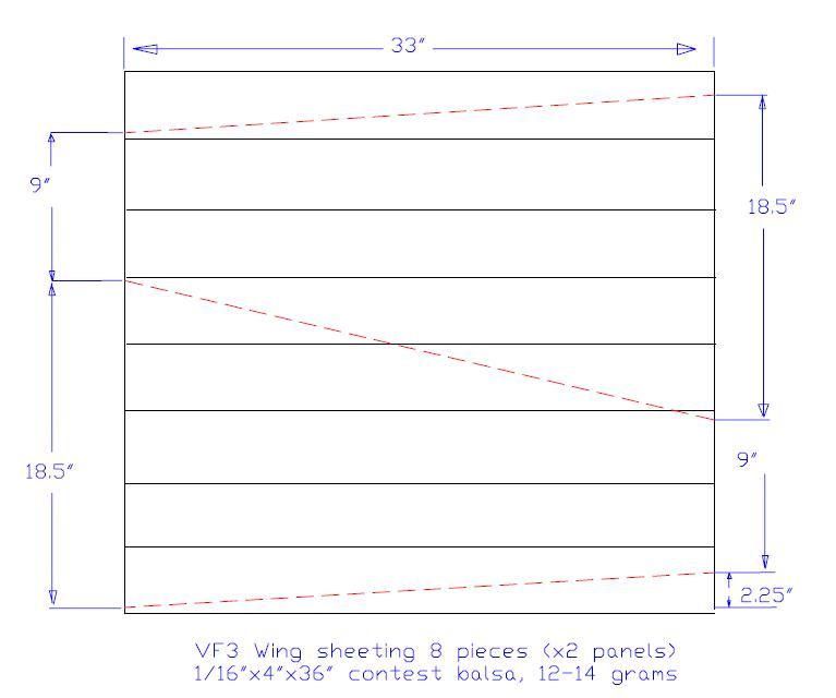

Making the sheeting
True up the edges of the sheeting. I ususally use a long straight edge and trim the edge straight with a new (very sharp) Xacto blade. Do this to all edges.
Next with a block sander (or preferrably an edge sander if you have one), stack the sheeting about 6 pieces at a time and sand the edges true.
Using the atached drawings as a guideline, trim and glue the sheeting together.
Place a piece of sheeting on a flat table. Lay out a piece of masking tape sticky side up and place the edge half way onto the tape.
Next, lay the glued piece onto the tape, taking care working all the way down the seam to ensure a tight fit with no gaps.
Lay the seam over the edge of the table, so the exposed piece drops over the side and exposes the seam like a hinge.
Run a small bead of elmer's white glue down the seam and make sure there are no dry spots.
Close up the seam on the flat table, and wipe off excess with a paper towel. The less glue left on the surface of the wood, the better.
Repeat until the skin is completely glued. Weight down the skins with whatever you have available so it doesn't bow up and open the seam.
Let sit for about 20 minutes, then sand the seams LIGHTLY with a 220 grit block. This creates dust as a fliier to close up the seam. Do NOT try and sand the skins perfectly flush at this time, only create dust and work into the seam if needed.
After the skins sit for about an hour to an hour and a half, carefully remove the weights and flip the skin over. Carefully peel back the tape.
Place the blocks down again, and after about 10 minutes, dust sand this side as well.
Let the skins dry overnight before final trimming and sanding.

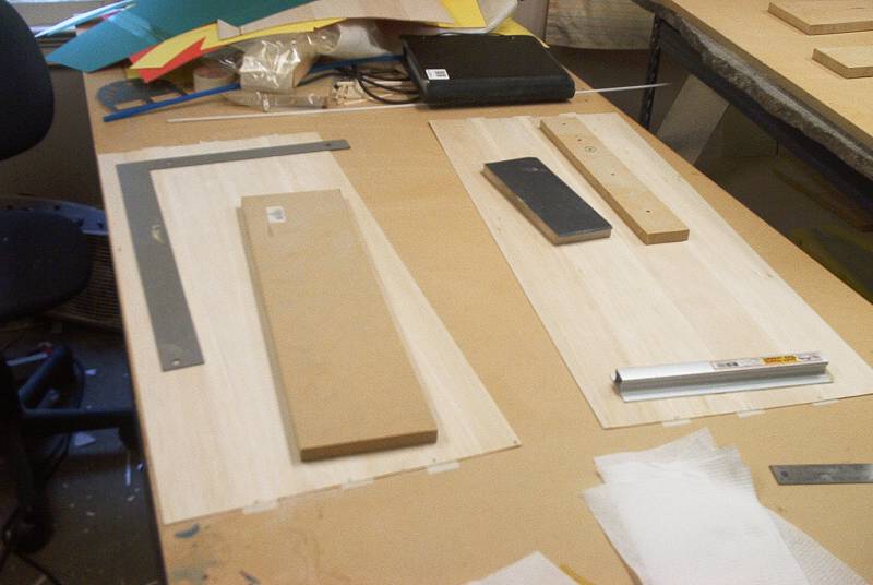

After the sheeting has dried, trim to final shape and sand flat.
Sometimes thicknesses vary, so you have to match this. The side the tape was on should be down against the table, and sand the exposed side first. Only then flip the skin and sand the other side.
After you have sanded the skins smooth, blow them off with an air hose or vacuum, but get all of the dust off the skins.
Next, spray the skins with aqua net hair spray (just regular old hair spray in an aerosol can). Don't spray them soaking wet, just damp. The skins will curl up and bow like crazy, this is normal so don't freak. let them dry for at least 3-4 hours or longer.
Block sand the sprayed side with a 600 grit block just enough to be smooth to the touch (only knocking down the high spots). After cleaning the dust off the skins, you're ready to sheet the cores.
Old 07-30-2007 | 09:56 AM

Do the rudder and stab cores the same way.
For the turtle deck cores, these are a PITA.
I have started using polyurethane for sheeting these parts. However, there are a couple of things you need to know or you will mess up big time.
First, when using polyurethane for sheeting, use ONLY fresh glue. Use elmer's ultimate, and make sure you have JUST opened the bottle. Why? because this stuff thickens as it's exposed to air.
First wet the outer side of the Tdeck skin with ammonia and water.
Flip the skin and weigh out 15 grams of polyurethane.
using a spreader, spread the glue into a thin layer on the skin. It will appear almost dry, but that's ok. If it looks wet or shiny, there's too much glue and hence, too heavy.
After the glue is all down, soak up any excess because it doesn't evaporate, it's there to stay forever.
Place the cores in the shucks and weight them down. Use folded poster board, playing cards, clamps and/or weights to make sure the skins are contacting the cores and there are no gaps. This can be tedious the first time you do it, just be creative here. The moisture from the wet skin will kick the glue nicely so don't spray it.
let this cure overnight. When you remove the sheeted cores from the shucks, if the skins are still wet the core will be slightly bowed. Don't freak out, let it dry and it will assume it's normal shape.

Mike,
Are the measurements on the sheeting diagrams accurate enough that I can go ahead and cut the surfaces out of the sheets? Should I add any "overhang" or cut to the exact measurements on the diagrams?
I thought I'd glue up the sheeting while waiting for the foam to get to you.
George
Old 08-05-2007 | 01:23 PM
MHester's Avatar
Posts: 2,707
From: Woodstock, GA
Go ahead and cut the sheeting, it's accurate enough. leave a good bit of overhang, and then when you get the cores, just trim it to about 1/8" around overhang.
-Mike

ORIGINAL: MHester
-Mike
Mike,
Sorry to be dense, but I can't decipher your answer Are you saying that the dimensions given on the sheeting templates include adequate overhang, or I should add additional overhang to the dimensions shown?
My Dad always said Measure twice, Cut once!
George

The overhang is adequate, as far as I know.....I've done quite a few of these, and those numbers work...some require a good bit of trimming but just follow the diagrams and you'll be fine!
PS yours will ship as soon as I get the new foam and get it cut, one day this week. ALL of the electric kits are getting the new foam which will shave an additional few ounces. This is stuff I couldn't get until last week. So I ordered it, they cut it up and now I have to get the trailer and go pick it up and cut it. Foam foam foam!
At any rate, I'll get down hard and heavy on this thread pretty soon, but I have to get these kits all shipped before I have any real time....
-Mike
