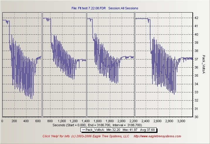

After discussions at a recent contest and on the thread about props for the DualSky 12T, I decided to run some tests on the 11T with the hope of getting more power. I originally selected the 12T to replace the Hacker C50 14XL with a 22x12 APC. The trend now is to smaller props and faster flying and that suggests the 11T might be better. I installed the 11T in my Abbra with some difficulty as it was an early model and wasn't exactly the same as the 12T. Anyway I tested it statically in the garage with the 20.5x14 APC and a True RC 5000 10s pack. The results indicated an increase of about .5 HP (366 watts) output at the expense of 507 more Watts input for the 11T over the 12T. I knew that meant more heat in the motor and battery packs as the increase in input power is the result of more current. I was also concerned about using more capacity during a given flight.
Today I took the plane out to Sepulveda Basin in 107F weather. I took one flight and was quite concerned with the temperature of the motor (146F) and Battery (126F) when I landed. The Jeti controller said it got to 85C, the highest I have ever seen, 73 Amps, which I know is lower than actual but a lot more than the 56 I see on the 12T, and 6740 RPM way up from the 12T. The RF link on the Eagle Tree was intermittent so I didn't have any other data to go by at the field. I decided my old TP Prolites couldn't handle it so I decided to quit for the day. i was kind of discouraged and figured I'd just put the 12T back in the plane. By the way the power increase was very noticeable in the air and I can see why it is desirable.
After I got home I looked at the data in the Eagle Tree and was pleasantly surprised. The peak current was 77.7 Amps at 34.46 volts (2677 Watts) and the cumulative mAh used was 3775. When I recharged the battery it took 3862 mAh. Unfortunately the tach didn't work but the Eagle tree and Jeti were always pretty close on peak rpm. I was over 70 Amps, just six times for very short durations. Most of the uplines, loops etc., were just under 70 Amps. All the numbers looked very acceptable.
I decided the high temperatures were driven primarily by the ambient temperature which was 30 degrees higher than my normal practice field in Camarillo and that the increase due to the motor change was minimal. The whole thing is looking good and I will test it again in Camarillo.

Jim, your results are very similar to what I have found with the 11T vs the 12T. Basically, I find the 11T to be almost the same as an AXI 5330/F3A. Same amps and rpm during my tests comparing the two. Only difference is the DS is 2 oz lighter. With the higher rpm, you can also back off on the pitch for the 'calm' days and the amps and usage will go down. For really windy, strap on a 20x15 and 'hang on'. ;-) I still prefer the 12T because of the lower amp draw, I can still get plenty of speed out of the motor with more pitch.

I put three more flights on the 11T on Friday. Looks like it consistently uses more energy than the 12T even though I'm trying to manage the throttle. Capacity used was 3870, 3932, and 3994 mAh on the three flights. The motor temps after the flights were in the 125 to 130F range. The batteries 120 to 125F. Max currents were 72.4, 69.8 (on the old Prolites) and 74.48 Amps. Peak Watts were 2434, 2288 and 2517 respectively. All flights had peak altitudes over 900 Feet at least four times. As I was trying to fly a pattern I'm not sure where the throttle was at any given time. I was trying to stay away from full throttle so I'm not sure what it will ultimately be capable of. During one tall Top Hat with three of four up I climbed from about 125 feet to 978 feet. The rpm just before pull up was 6423 at 60 Amps. About half way up the rpm dropped to 5893 at 71.5 amps. It was then fairly flat in both rpm and current until I throttled back on top.
Next time out I'll do some full throttle up lines and some downlines with and without the brake. I'd expect to see current more like the 77 Amps and rpm to go with it like I saw Wednesday.
Right now I'm thinking I'll stick with the 11T as the numbers look like the motor and batteries should be okay. The increased performance is noticeable.

After looking at the data, I decided the high current of the 11T was probably going to mean short life for the batteries. I could see my True RC 5000 with about 60 flights was showing signs of degradation. I know the first day I flew the 11T in the heat the battery got very warm. The 12T with good batteries performs adequately but I can see that with old batteries and wind I would not be satisfied. So right now, unless you get free batteries, it would seem the 12T is better, because the 11T will make your batteries old pretty fast.
Ultimately, two airplanes might be the answer. One with each motor. Fly the 11T only when you really need the added power.
I've attached data from 4 flights. The packs are 1) original TP Prolites 2) TP v2 5000 3) new True RC 5000 4) old True RC 5000- now 69 flights
You can see the old True has lost a step.
Jim O

I was hoping some battery guy would tell us that his 5000 mAh 25C packs could take 80 Amp peak currents without degrading the packs. Perhaps this is the reason the 25-30C packs don't last very long. They really aren't 25-30Cs? I'm not picking on the True RC packs because they only claim to be 10C. But what about the rest? Any data to show they can take 25C and last for a few hundred flights?
