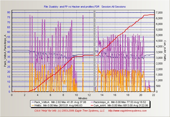

Hi I flew with f3a05 so did a comparison between Dualsky 11t with cchv85 and FP evo Lites versus Hacker C50 and pro lites. Both planes using a 20.5 x14 APC prop
The dualsky was 6000 rpm and the Hacker 5600 RPM. There was approx 100 rpm drop on the Dualsky on a full power test at the end of the flight.

Oops I duplicated the attachment while on the phone. The left part of the graph is the dualsky and the right part the Hacker

Many Thanks Nigel (Hairy Flyer)-I couldn't have managed much of that myself!
Just to add-the Dualsky flight was: Static test to check WOT rpm,fully charged volts and amps, then straight into a F09 schedule, then straight back down to the ground, and another static WOT rpm, volts,ampsthe single vertical long line at the RH end of the trace,I think?

Thanks Nigel, the Flight Power pack looks like it is doing the job. Unfortunately we can't see the voltage under the peak current load. Maybe you could give us the same chart with just the voltage so the minimums can be seen.
I would expect that packs used on the Hacker would last a lot longer than those used on the 11T based on my experience but I may be wrong.
I've flown over 600 flights using the Hacker C50 and DualSky 12T and the only time I exceeded 65 Amps was when the C50 had a "slipped rotor" problem. I believe that pulled some extreme currents and degraded my three TP Prolite packs but four of the six 5s packs are still going. I had about 60 flights on a True RC pack, all on the 12T, and never saw voltages below 34 volts under peak loads. After a few flights on the 11T with currents in the high 70s, I saw minimum voltages below 33 volts which I consider bad for pack life. I don't have enough data to back this up so I guess I could sacrifice a pack and see how long it will last at these high currents. How old are your FPs used in this test? Have you seen any degradation since they were new? Thanks again for the good work.

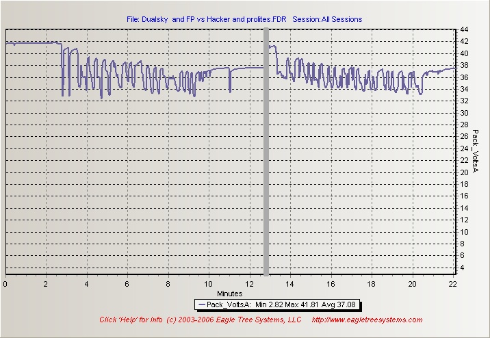

Jim O Hi. As requested voltages only. Looks like the data supports your view! The FP's are F3A05's so I dont know how many cycles they have done. The pro lites have done over 150 cycles now.

The FP/DS11T combination looks like it is doing well. I bet you can feel the performance. The only question is how long will the batteries last. If we could get 150 flights it would be great. Keep track of them and let us know.
If one was into big time competition I guess you wouldn't care. Just replace them when they need it. I keep trying to hold the cost down while getting adequate performance. The 12T with batteries that haven't been abused seems to be the way.

Right now I give you the bragging rights for having the best batteries. It is difficult to read but it looks like 77+ Amps at 33+ volts at the end of flight after 70 flights/charge cycles. We'll wait for someone to top that.
It is interesting that they actually appear to recover a little after landing as opposed to during maneuvers late in the flight. Cooling?
It's easy to lose me in leccy technology, but,from what little I've seen, the batteries seem to get a bit warmer after landing,don't they? So perhaps that explains the slightly higher watts on that single vertical bit of the graph at the end.
That would be the WOT rpm check after landing.
The F09 schedule is quite power-hungry in the second half(big triangle from the bottom, stall turn with point roll up,K/E loop,climbing/rolling1/2loop,big hourglass with K/E/rolling45s climbs etc),and although I don't use all the throttle,the graph seems to reflect the schedule's demands quite well,I think?
