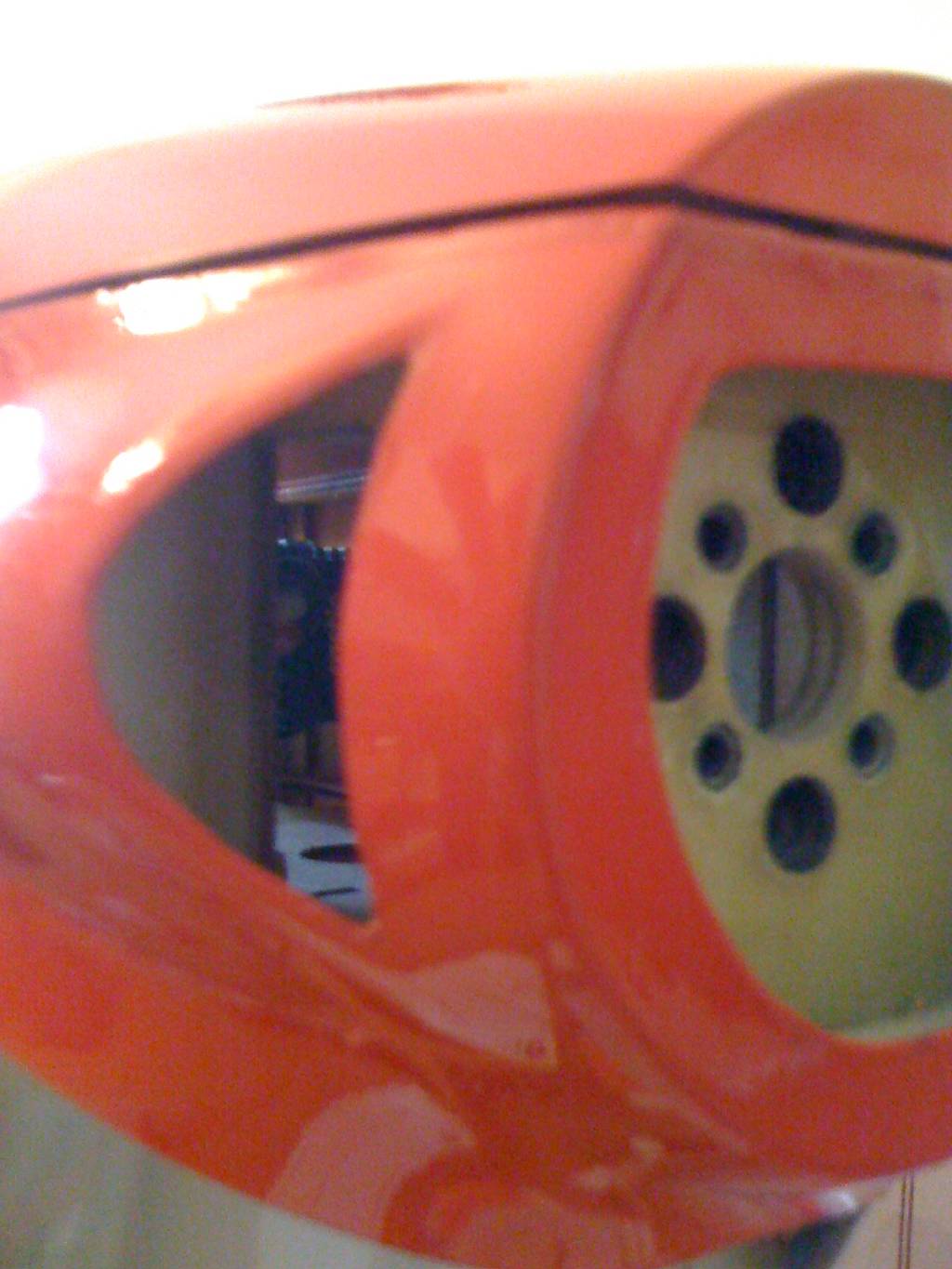

My Feedback: (8)
pics of the opened cooling holes; it is best to draw the shape with a sharpie, then cut the line with a blade. the paint will chip but not chip past the line. rat tail files, and small wooden sticks with sandpaper CA'd to the ends for different shapes and good workability.

garcfield thanks for the photos!</p>
</p>
What hezik wrote, the only thing that really matters is the motor temperature. One thing that also should not be forgotten is that all lab measurements are done at 25C degrees, so if you fly at 35C degrees and you are already on the limit with your prop that should be taken into consideration.</p>

Hi Guys...........just an update on my Wind crash.
The plot thickens. I just looked at my flight pack and it was showing 71% capacity and 3.97 & 3.96 V on the cells. I charged it to my usual 95% and I only put in 175 ma. I then cycled it just to make sure and it is normal. There are now two possibilities for the complete radio link loss. The malfunction occured right after my snap on the 45 degree downline and after the recovery it was completely dead and very precisely coninued on the 45 line right into the bush. One of the possibilities would be a flight pack battery disconnect from the system. The other would be a complete loss of data link to the receiver (blackout?). I always run my JR9303 with the antennea vertically. Would this cause a loss of signal?? Should I be running with the antennea at 45 degrees instead?? This is my first problem with 2.4 ghz that I have come up against and has me baffled and POed. I thoroughly tested all the radio equipement and all is normal. I am going to use another receiver in my new one so hopefully I will not have the same problem. Any
