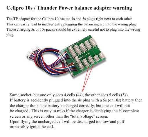

This weekend I ruined a $550 battery due to a simple mistake when using the Cellpro 10 with a Thunder Power 10s Extreme. I felt compelled to share this experiance to help others avoid this easy to make, but costly mistake. This post is not a slam of the Cellpro because otherwise I've been extremely happy with the charger, however, I do feel strongly that the design of the balancing adapter should either have one plug for 5s/4s, or some other method to help avoid this. Certinally having the plugs right next to each other is a bad idea.
Note, in my case I was using the Thunder Power adapter, but looking at the other adapter sockets I believe this could happen with other brands of batteries as well.
The attached image details the problem.

I cut little squares of 2mm depron and plug them into the sockets I don't use to prevent the mistake. There's a similar potential problem between the 2S and 3S connectors. The depron has just enough grab onto the pins that it won't fall off and I just leave them in place all the time since I only use 2S and 5S packs. I guess if you use more than that, you'd just have to be extra careful. The universal charge adaptor is the only part of the Cellpro setup I don't like. I'd prefer individual connectors even though it costs more and now have them for my 5S packs. I only use the universal one for my 2S packs.

Does the Cellpro not look at total pack voltage (across the main leads) and compare what it see's to the balance tab voltage? If it does then it should immediately know that something is not right since it would be "missing" a cell...this should prevent this type of failure.
I dont have one of these chargers so I am not sure, but all my other chargers do this sort of compare logic and it works good if say the balance lead is damaged etc.

The Cellpro charges through the balancing taps up to 4 amps, beyond that it requires the main leads to be plugged in. In this case I was charging several things at once and didn't want to pull more than 4 amps from the power supply anyways so I wasn't using the main leads. Guess this is a good reason to use them anyways!
BTW, after this occurred I found a couple of old TP taps from another application, removed the wires and inserted the bare taps in the 4s socket so this won't happen again. My point here is to warn others.

There's one other thing to be watchful for with the Cellpro-10 charger. If you are charching two packs at a time, and you mix up the two center power leads, you will blow a component inside the charger. If this happens you will still be able to charge a single pack, but two packs will no longer charge.
This has happened to me twice so far, and each time I had to send the charger back FMA for repairs. Each time I did it I kicked myself for being so stupid, but it's easy to do, especially if you're rushed and you aren't aware of this failure mode.

I wanted to give kudos to Thunder Power. I contacted them today and explained what happened to me and they offered to replace the pack for 1/2 price. They no longer carry the 10s Extreme V2's (the replacement is 30C) so I'll be trying out the new TP Prolite V2 5300 (two 5s packs).
It still stinks that I lost a perfectly good pack (it was my newest 10s V2) due to a silly thing like this, but I really appreciate the guys at TP softening the sting a bit.

R/C toys sells an adapter cable, from the Cell Pro 10s to TP (5s), so I just eliminated the need for these adapted cards. The leads on the new TP packs were so short, these adapter cards were cumbersome.

The easiest way to avoid an improper hookup is to always charge using both connections to the Cellpro 10S, the balance connector and discharge lead. The charger will error when it does not read the same voltage from both connections.

It does perform this check and will not allow the charge to start if the operator does not connect his pack to the proper connection (which is clearly marked).
