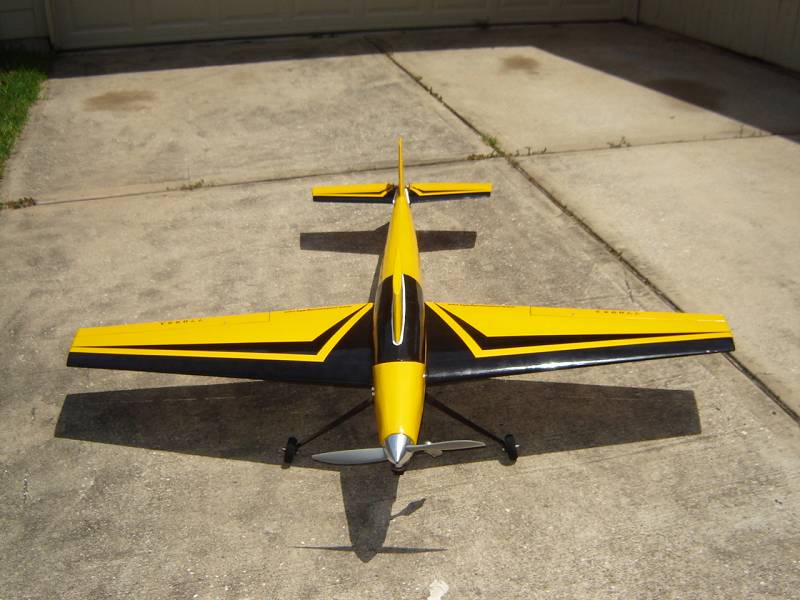

Hey guys. Not sure if yall have followed my scratch build thread in the regular pattern forum but I'm considering converting my plane to electric. I have had several "small" electric planes (3 cell lipo), but this would be my first heavy-duty set-up. I'm still considering getting a YS 140 unless I'm convinced otherwise. The plane weighs a little more than 8 lbs dry with the YS 110s engine. Reason for wanting a new power plant is because this airframe has a lot more drag than I had anticipated and needs more help on the up lines. I'm looking for a rather cheap set-up since (1) don't have a job (2) will be full time college student starting mid August (3) don't have the time to fly as often as I would like. I've been looking at the Hobby City stuff but see that every once in a while there is someone who gets a dud. If I could get help from you guys that would be awesome!

Hey guys, sorry to revive an old thread here but I figured posting in this one would be better than posting a completely new one. Anyways, it's about that time to do the conversion of my plane. Need to figure out what to order so it will be here when I come home from college for the summer.
So after doing some more research I think I've narrowed my motor choice down to:
EFlight Power 160 (650g) [245Kv] $150
Himax 6330 (610g) [200Kv] $200 (If preordered - List: $250)
MonsterPower 160(645g) [245Kv] $50 Link: [link=http://www.hobbypartz.com/mo1602brmo.html]Here[/link]
Hacker A60 (Not sure which version to get)
I would like this setup to last a few years so i can use it with newer planes. I figured trying it out on my GT Express would be a good test bed. Let me know what you guys think.

Thanks to underdw, I now have an AXI 5330 F3A. Now I'm just waiting for my Castle HV-85 to come in. I still have some modifications to do to the plane before i can install anything. And that can't be done until I move back home. 4 More weeks of school left.....
