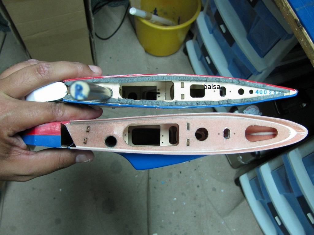

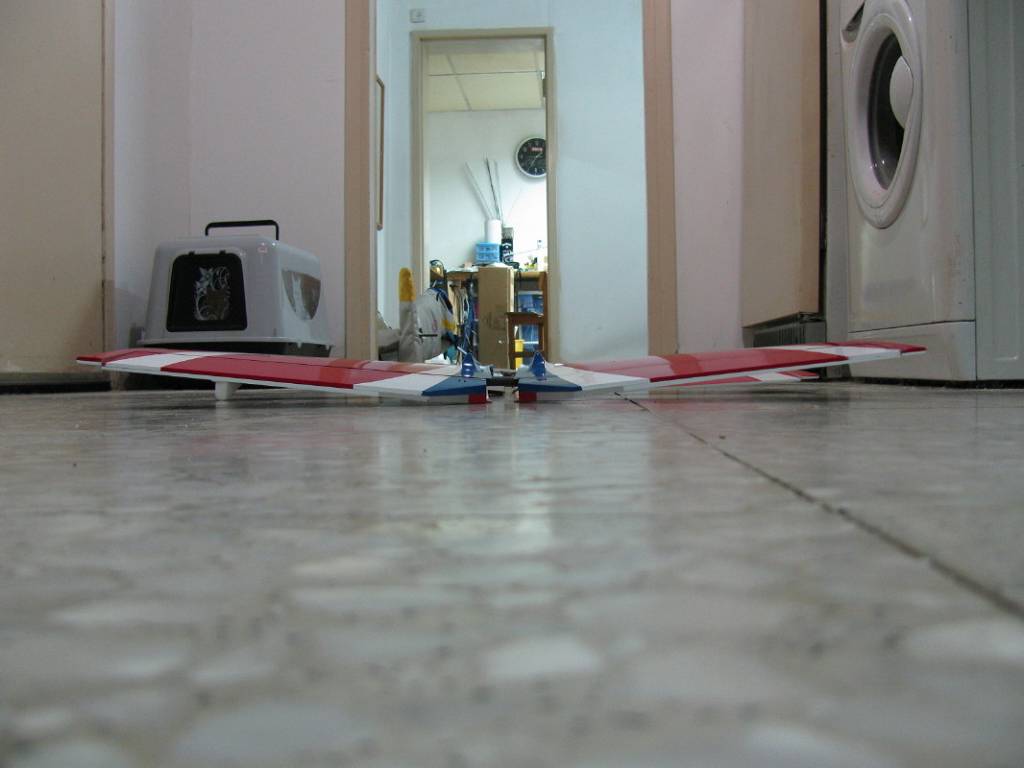

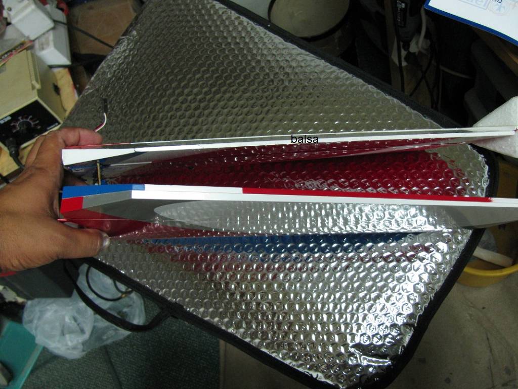

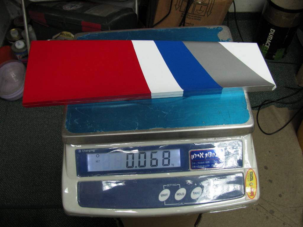

Hello
Finally got the Composite Wind S Pro
You can feel the changes and some can actually see
Wing pulled back more
Larger Aileron surface
It includes flow fences and accurate installation place
Decreased thickness of the wing section
Difficult to measure the difference of the wing root area,it is thickns end not aligned with the rest of the wing, it is noticeable
the horizontal stabilizer Increased thickness
Larger tail Anahdrl
Aileron and horizontal stabilizer hinges are Skin hinges but the lower slot / gap is closed as F3J, F5J Style
Coverage of Servos so that only the pusharod sticking out (F3J, F5J style)
THE LUXORY BAG UNFORTUNATELY ARE NO MORE INCLUDED
IN THE PRICE
THEY ARE OPTIONALS... (SEBA words)
