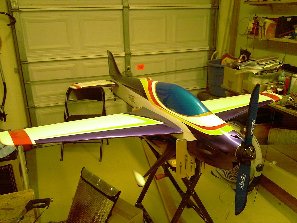

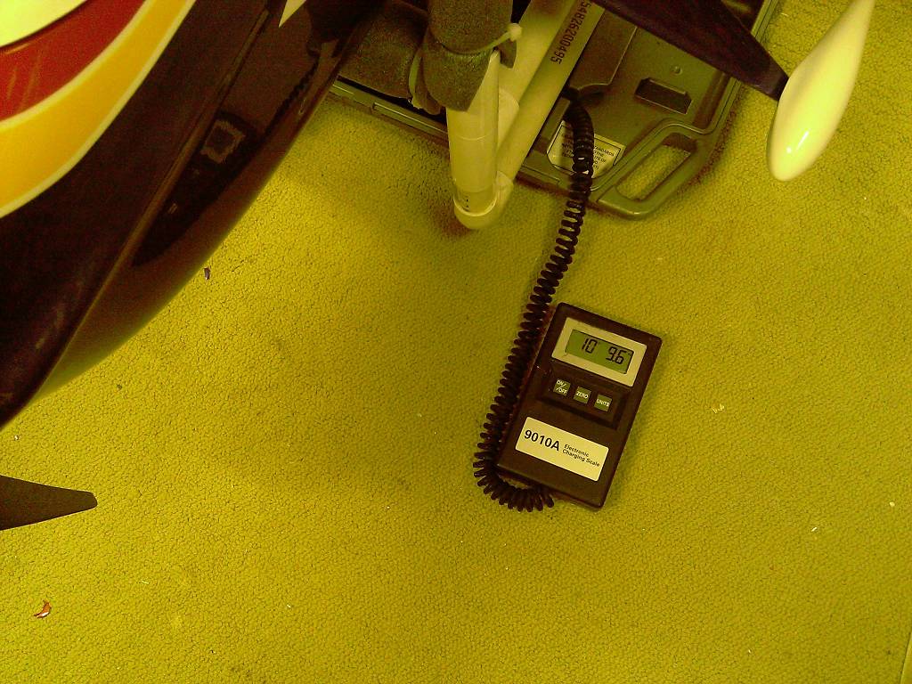

Old 10-29-2011 | 07:30 AM
  #435
vquick's Avatar
My Feedback: (71)
Joined: Sep 2003
Posts: 633
From: Gracevill,FL
Default RE: Sebart Wind S Pro
Well this is my Wind S Pro finish it came in 10:10 install Dualsky 6355 with a PT 20-13 world model spinner carbon Castlle 85 controller futaba 9650 on tail 9252 on wings for now planing to change to JR 9411 and 8411 for rudder. Futaba 12FG
