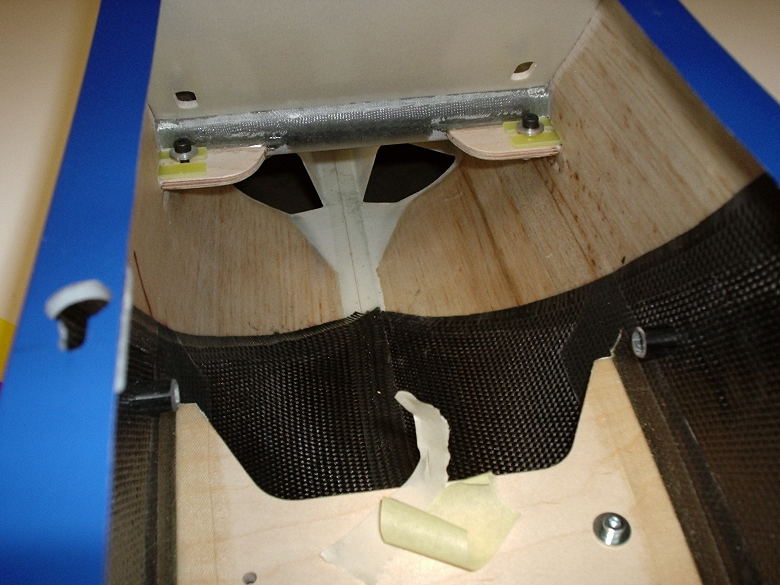

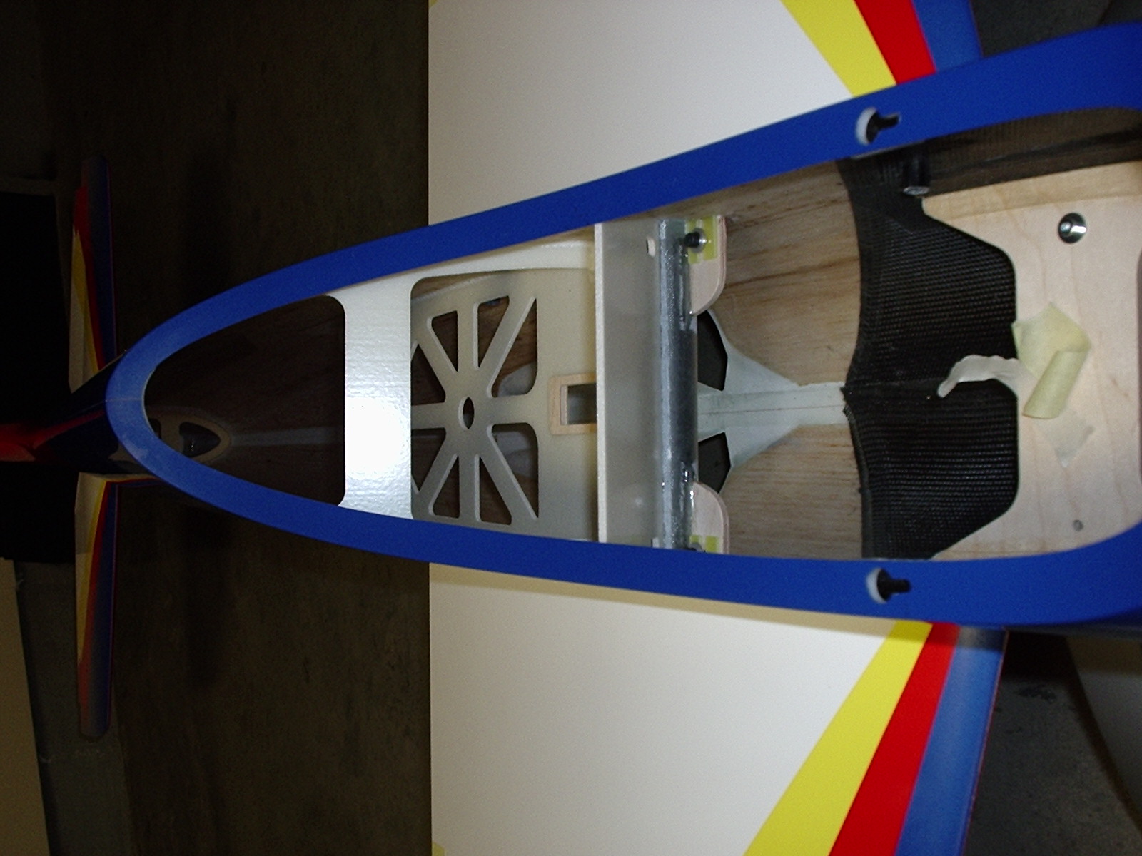

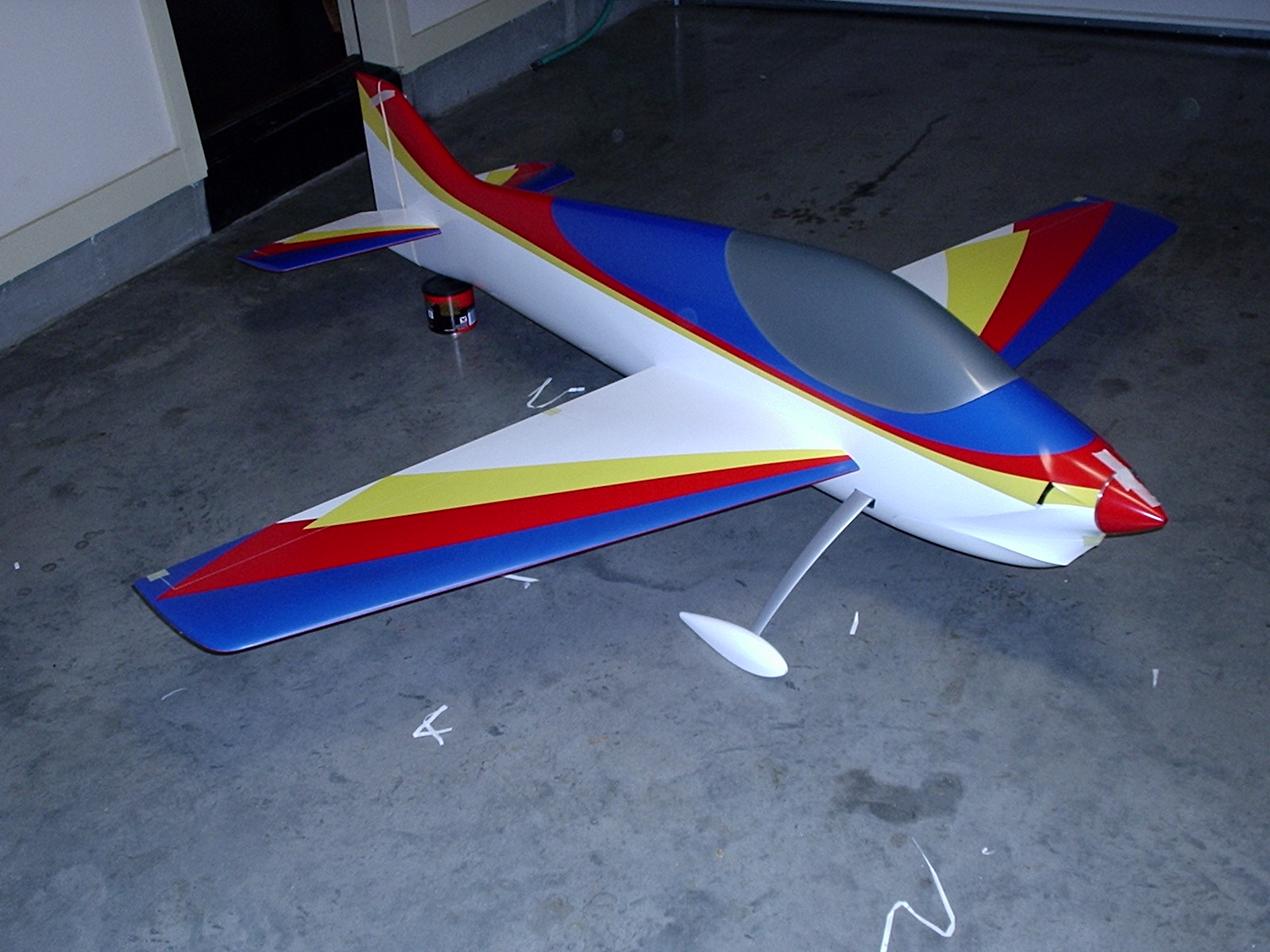

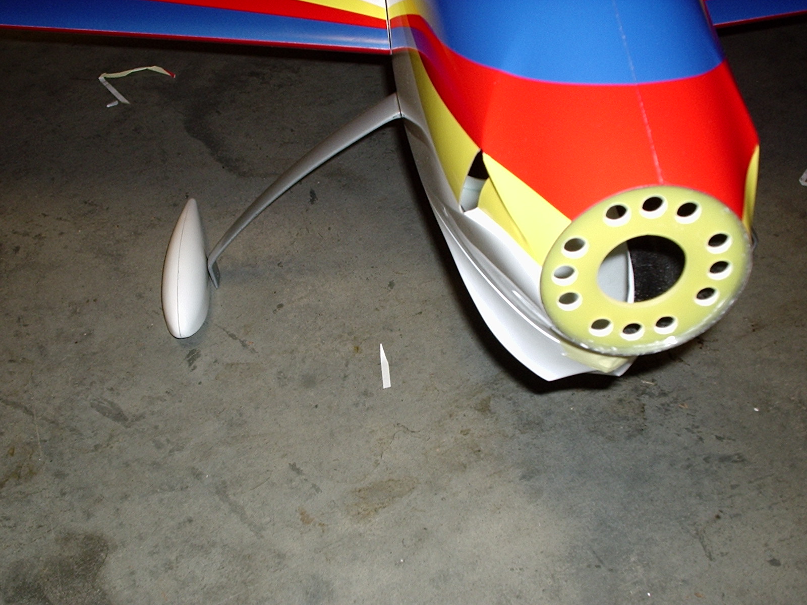

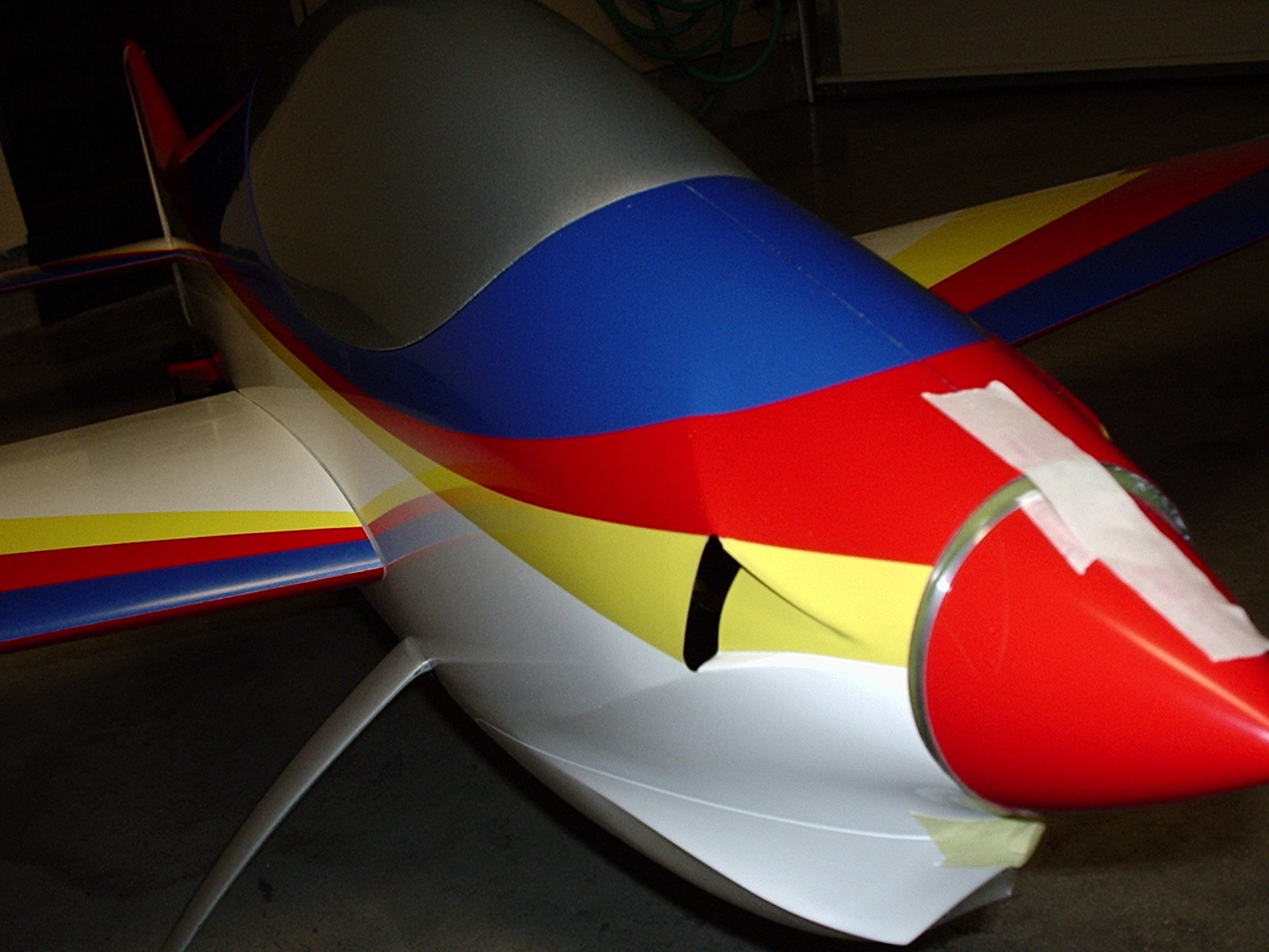

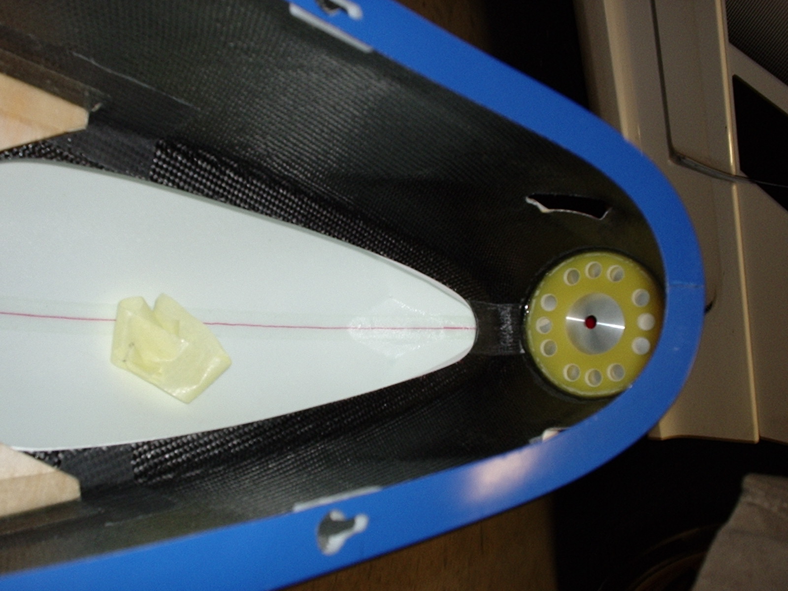

Theres not much to do to put this together but I will post here as I progress, it might be slow going though.
As shown model requires addition of firewall if you choose to firewall mount your motor, elevator servo plates, mounting details for the chin cowl and installation of canopy clip are requred, as is a battery tray. I think thats about it. So less these items fuse weight as shown in pictures is 1764 grams.
A good hardware kit is included with light wheels and axles, surface horns, harch latch; wheels at 18g each are included in weight above.
Finish shines up nice with some automotive cleaner wax.
Pictures are as received. I just taped pieces in place.
My plan is firewall mounted Plettenberg and Jeti ESC.

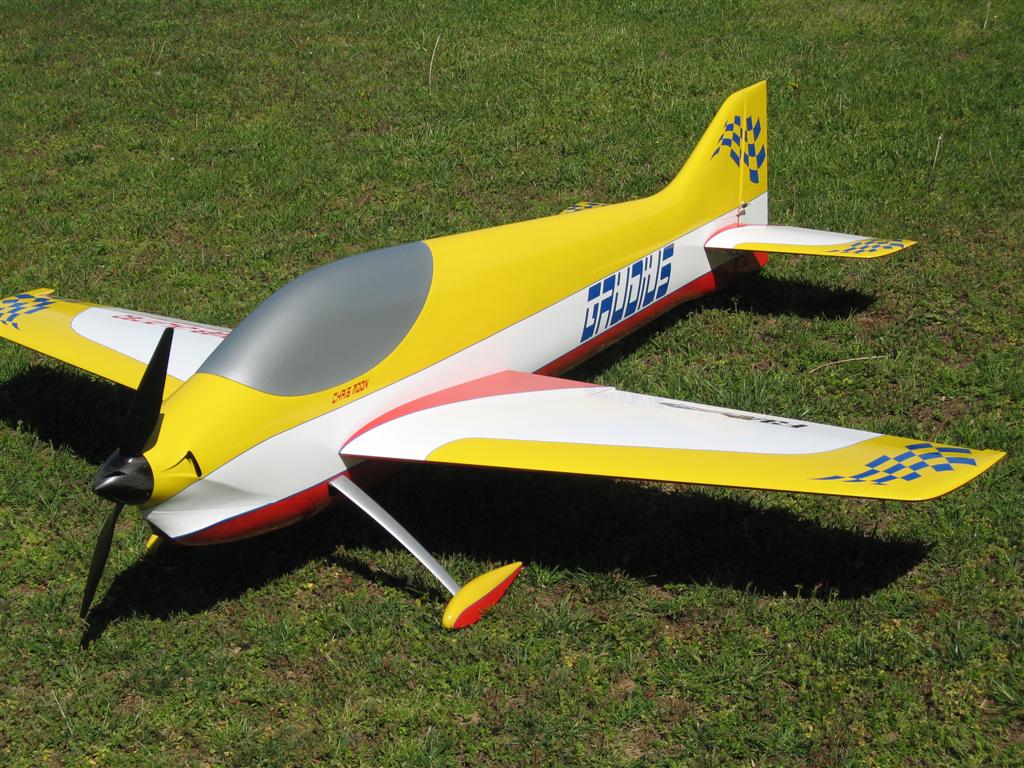

I can't stand it anymore. I'm not sure if I'm allowed to share this so I'll pretend like I don't know where this comes from, but with a RTF weight of 7 lbs 14.5 ozs and killer looks, I think someone should be shouting from the rooftops.
How's this for eye candy!
Still waiting for a complete flight report . . . hopefully after this weekends competition "down south" we'll hear more from the owner

2 Sunny you know you need one of these once you fly it. Wow I got a chance to fly it @ Green Sea's contest. Best plane I've flown, Chris let a couple of guys fly it. Very easy to fly great round's, vertical up and down straight. I hoping to fly it again this weekend at Wilson Salem contest, just Chris doen't know it yet. [:@]

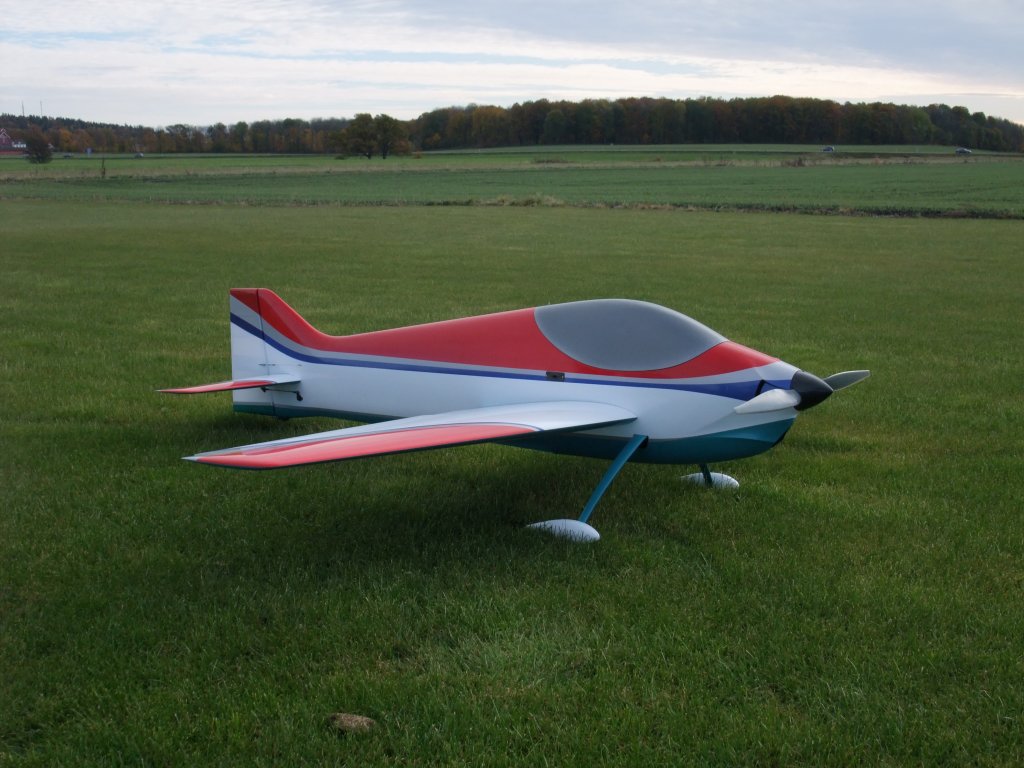

With the vectorthrust that I have to remove due to the regulations

Hans,
Looks outstanding!
Is that the factory paint job, and assuming you have a Plettenberg 30-10 in there do you restrict the throttle curve at all or just use your fingers to limit thrust?
How would you compare the Gaudius to other planes you have flown?

Hi Joe,
It is the factory paintjob. Did do the T-Can myself and a new rudder thats less deep to compensate for the extra lenth by the vector thrust.
Some notes about the vectorthrust. Have spend some time now to get aquianted to it. Had it mixed with an adaptable curve to the throttle and had it mixed to the rudder.
My conclusion is that a correct fixed side thrust is all you need. Some kind of power - sidethrust mix is not needed for this model (and perhaps all models)
The Gaudius so extremely rudder sensitive that rolling level is very easy.
With only a small percentage (10%) of vector mixed to rudder it moves like a snake through grass. So not only the tail that swings but now the head swings too. It did not make me fly better. So the Gaudius does not need a rudder -vector mix too.
I do not regret it that much that the rules are explained in a way that it is not allowed. The device did not help me that much and I will remove it.
Have flown two years competition with a Synergy. It is like an old dog. It perhaps can not do the difficult tricks but it keeps walking besides me even when it is not ordered to do that.
The Gaudius does the figure m with ease. It does everything with ease, but you have to stay on top of and keep steering or it will do its own thing. This is perhaps in general the difference between the newer designs and the older designs.
Until now i'm happy with it. I know and feel it has great potential, but we still have to become a team.

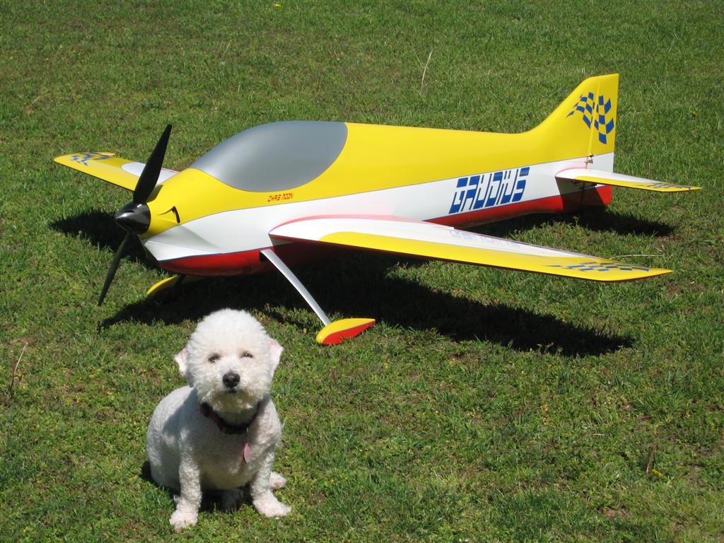

More pics and one of Lotto for Jason too!

Chris, Lotto looks like you just woke him up. Disinterested and bored.
Nice plane. I like the Czech R board vinyl.
