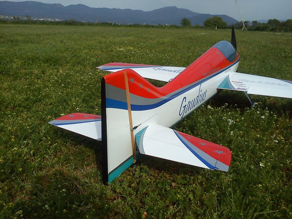

After about 20 flights i decide to put on the new rudder with thicker TE, the problem was that yesterday we had strong crosswind at our airfield. So from what i was able so see is that the model is now much slower and the rudder authority i believe is better. I will wait for a calm day to see some more details.
The final weight of the new rudder is 65gr instead of 80gr of the original and i can change it in about 15 minutes.( just pull out the 0.8mm steel rod i pass through all hinges and put it back in place).

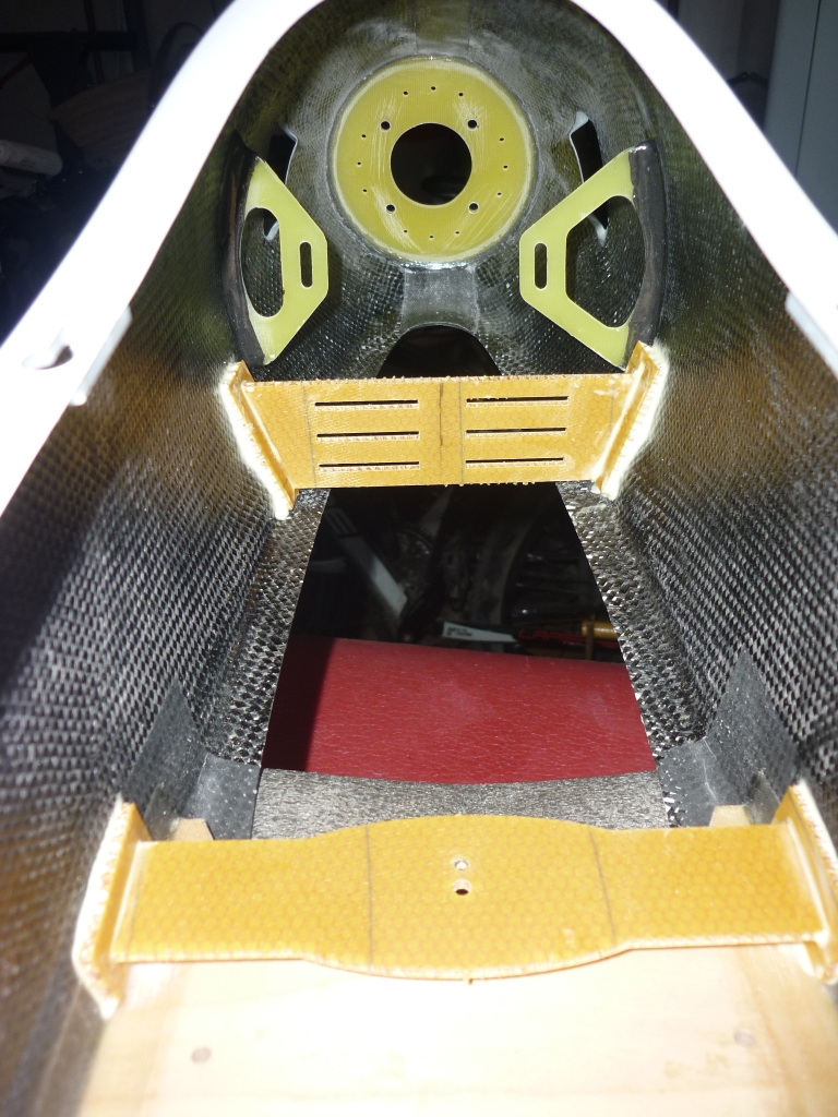

Hello
Thanks to Hans, Alex, Harris. Yours comments and pictures help me.
So my friend gave me nida plate he bought in Modelltecnik-Lorenz to install on his plane.
Batteries are fixed on the plate. The plate will be slipped in slots and screwed (pictures are better than my explanations !)
May be it's quicker to move batteries !
