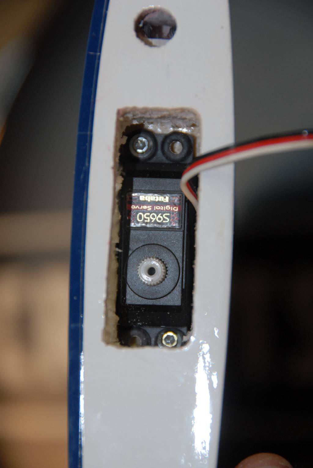

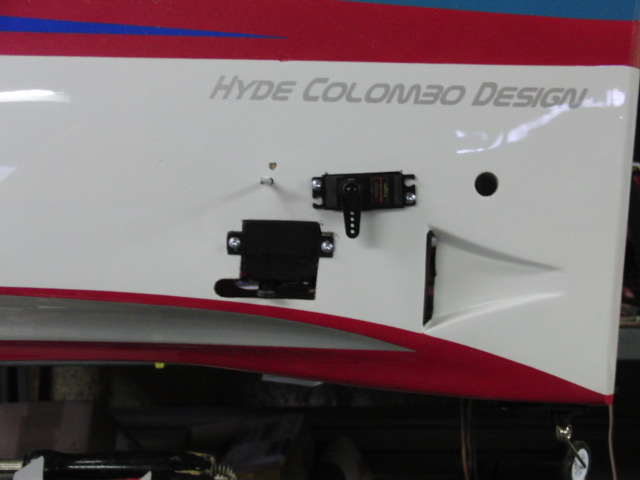

Congrats Todd! Ican't wait to receive mine.
In earlier pictures it looked like you mounted both rudder and elevator servos in the tail, is this correct?
Would you mind posting some pictures of your servo installation?
Keith
Keith
#290
My Feedback: (8)
Kieth no problem on mounting your servos in the tail as yours has the new laser cut split rudder which is an ounce and change lighter then the foam version. I only moved mine forward because I was wanting to be able to run the 4350 packs and they are so much lighter then anything else. Turns out I settle on the 5000 TP
Chip

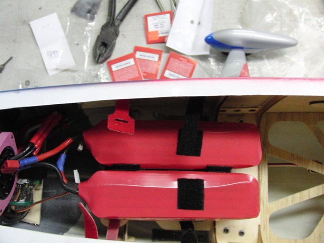

Here are the pic's just let me know if you need any more. I wll also show the battery and rx setup.

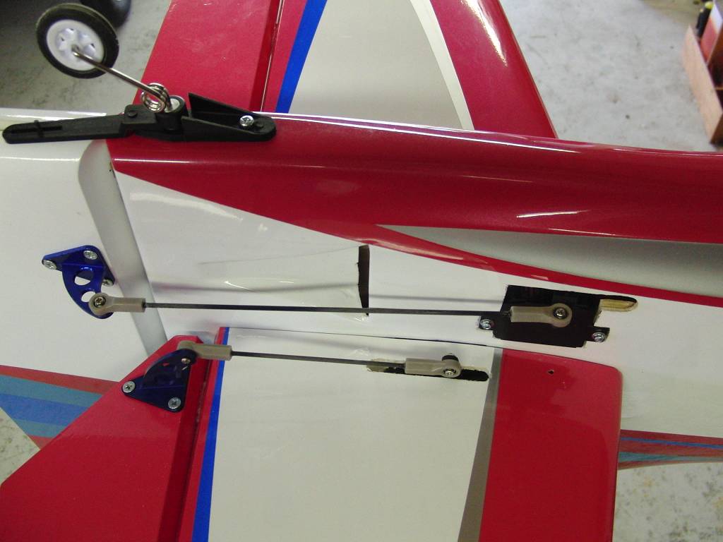

Chip -
Can you upload a pic of the bottom of your tail section so that we can see where the rudder servos are mounted in relation to the elevator pushrods? I know Todd said something about his rudder servos being an obstacle to moving his elevator servos up front, so I wanted to see what you did to avoid that. Of course, I have the advantage of not having installed my rudder or elevator servos when learning of the move to the front.....Todd is much quicker about assemblying his planes when they arrive, so he was already committed. That said, Todd sounds like he is loving the plane and he has no balance issues.
Pics would be a great help. Thanks Chip. Have you passed your citizenship test over in Argentina yet?

Ditto that. I am at the same point you are. You can kind of see the alignment of the pushrods in a photo a few posts up. I was going to hinge the elevators and put the control horn on then use the laser to project a pushrod line onto the side of the fuse from where the control horn clevis mount hole is at with elevators at neutral. I could then mark this line and project another at the bottom from the control horn to the area where the servo will likely mount and see where it intersects the fuse wall for a straight line (or slight angle from the clevis to the servo depending on where the intersection point is). Once I have that marked I was going to compare this with the location of the rudder servos that I see guys are installing on their Visas. It should have clearance, but it's worth a check. I'll probably check that several times before I take a knife to the side of the fuselage. Doing that always makes me nervous. I might chicken out and mount the servos in the stabs, but I think the best way is to move them forward. I want to be able to run lighter batteries for calm P11 flights and larger ones for wind and F11.

Steve -
Pulling out the cool tools.....the laser idea sure beats using a bowed piece of spruce as an alignment tool :-) I was busy modifying my plane rack system in the car last night so that I could take my new Passport to the field this weekend, but I will get back at the Visa in the coming days and try to figure this front mounted elevator servo thing out. I like your idea of how to locate where to put a fuse exit for the pushrods. I am trying to figure how to know where to put the holes in the support cross-pieces. I guess that I will just guess and do some trial and error until I get it right. It is probably much easier when you actually sit down to do it than when you try to think it through.
Maybe the best way is to stack a couple crossmembers and drill them together for the pushrod supports, then start shaving equal amounts off each end until the rods follow the line you want toward the exit hole?
