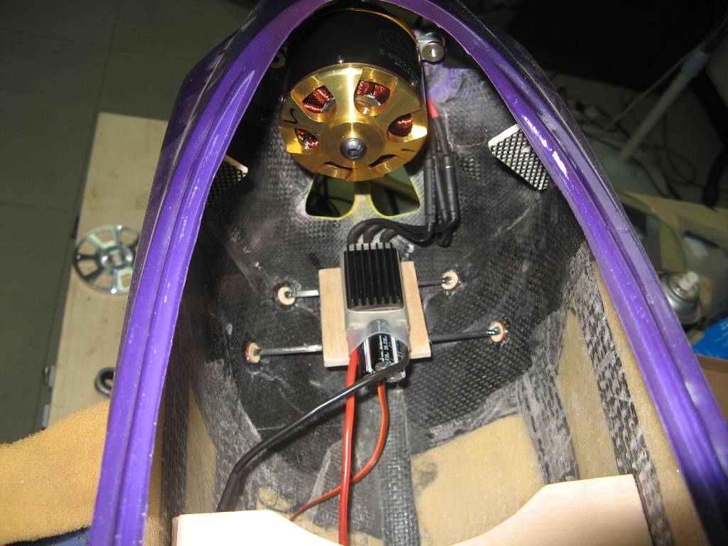

Anyone with pics of their motor, esc and battery mounting? I am just finishing my E-Neptuno now. Since this is my first electric pattern plane, I would appreciate some pics to guide me. I will be using a 14xl and a spin99. Thanks in advance....

How is life ? Maybe it is late, but here some pics of my installation. I am using a Scorpion and Schulze 32.55 ESC. I made a new battery tray which was lighter, stiffer and larger so it enables me to move the batteries a bit more as I am planning to try some different motors.
