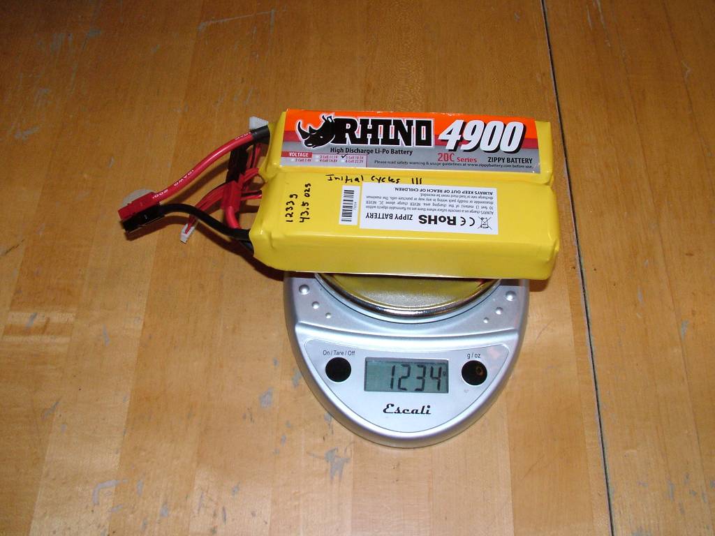

Hi All,
I have to renew my battery stock,
I have doubts between a pack made of:
1. 4+6 cells 20C – 1,240 gram
Rhino 4900mAh 4S1P 14.8v 20C http://www.hobbycity.com/hobbycity/s...0C_Lipoly_Pack
Rhino 4900mAh 6S1P 22.2v 20C http://www.hobbycity.com/hobbycity/s...0C_Lipoly_Pack
2. 4+6 cells 25c-1,226 gram.
Rhino 4900mAh 4S1P 25C http://www.hobbycity.com/hobbycity/s...5C_Lipoly_Pack
Rhino 4900mAh 6S 22.2v 25C http://www.hobbycity.com/hobbycity/s...5C_Lipoly_Pack
I would like to hear pros and cons opinions about using:
A. 4+6 cells (lighter then 5+5 cells).
B. 20C versus 25C.
Thanks in advance,

I use the 25C 4+6 s Rhino configuration.
Two cables shortened for the serial arrangement, and four 4mm bullets soldered to them and taped together it is 1214 gr.
Performance is very good.

We don't really need more than 20C for our application. Some data shows the high C packs don't have as good cycle life.
I can charge two 5s packs on my charger but I can not charge a 6s and a 4s together.

I allso had gut feeling that the high C packs comes at the expense of cycle life, but I am mot electronic engineer.
Can you explain that in professional way?

I am not an EE either so I can't explain in a professional way. Were I make this hypothesis from is the experience of others with the TP extreme packs. Great punch but high voltage drop over the flight and short cycle life. I believe others had similar issues with other Manufacturers high c packs. Not very well documented but I think a valid point to consider.
The newer generations of high c packs may be better but not sure if the cost ($$ and weight) are worth it. Since most of our flying requirements are less than 20c and I don't have the weight budget, that is what I chose. With the cost of the Rhino packs a comparison would not be terribly expensive.
(Reviewing your post the 25C are Lighter? In that case ignore the previous comment.) [X(]

Actually light weight 20C and 25C packs can be made but are not the favorite of the manufacturers because there is a limited market for them (F3A mostly). They simply can't make an economical run in the 1000's of units like they can with the heavier 20C and 25C sport packs. Short cycle life issues with some of the lighter weight higher C rating packs were not the fault of the use but a fault in the design and manufacture of the batteries. In theory, a higher C pack should perform better at all throttle settings due to a lower voltage drop under load and last longer as a normal F3A flight has a rather modest average C draw on the batteries which would lead to lower temps and longer life spans which like Anthony said, it not what many were seeing in actual use.
The Power Unlimited packs for example (shameless plug) are made specifically to our 20C discharge and below 600g requirements while maintaining at least the performance and cycle life of the heavier sport packs which seem to be holding up fairly well but are very heavy. These smaller production runs are more expensive to make - hence the price difference over some of the discount sport packs. We have some 25C -5000 packs in testing (not available so please don't ask) that are the same sub 600g and a real 25C discharge rating. If they work out in our longevity tests, we will sell them but that will be months away and possibly next Spring.

As an owner of all the major brands used by F3A pilots including the newer F3AUnlimited.com P.U. packs here's my thoughts (not that they're worth more than 2 cents, but just some thoughts). TrueRC, Thunder Power, Flight Power, and Zippys simply do not come close to the power of Rhinos or F3AUnlimited PUs, and the only difference between the Rhinos and the PU packs is weight and price . . . BUT . . . . and this is a huge "BUT" Rhinos have plenty of anecdotal evidence to show that a significant number of batteries arrive shorted, puffed, or otherwise unusable and getting them replaced is a major cost and hassle. If you are buying 5 sets or 10 batteries this isn't much of a problem, but if you're buying one set of 2 the risk of getting a single bad battery is HUGE, and worthy of consideration. I love my Rhino batteries, but I bought 4 and then 8 and had 2 bad batteries, one of which was not replaced because it was "lost" and I didn't pay for insurance on the return of the second battery, meaning I am out $65 + $10 + $15 on an order of 8 and one battery is unusable since it has no mate making the total loss $165. So my summary is this:
Rhino's 1 set $150 and 1233g and take a chance on quality.
P.U. 1 set $250 and 1180g and you know you'll get a decent set.
