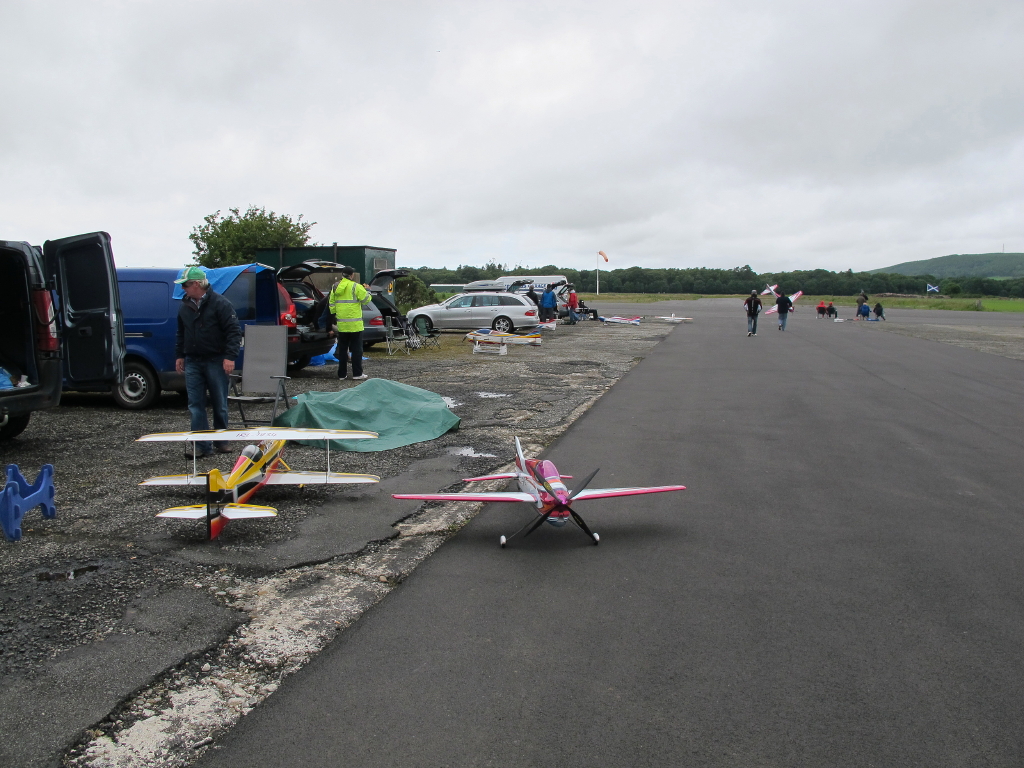

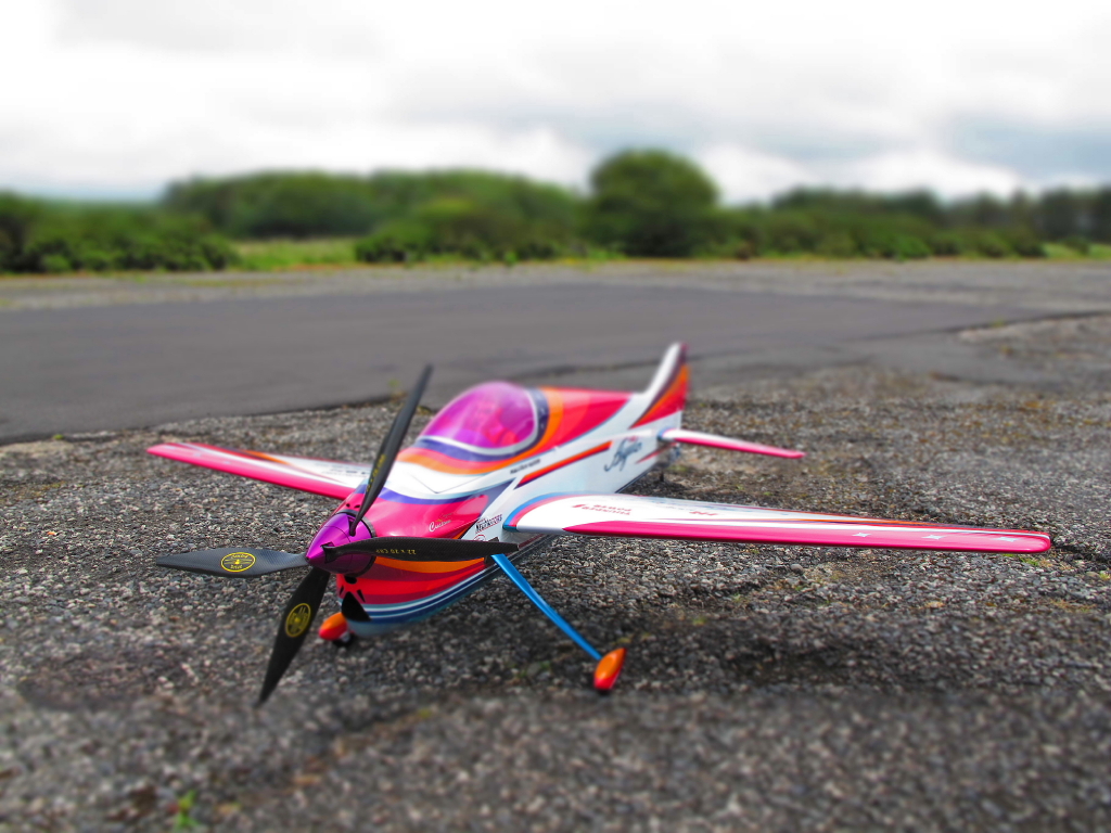

This weekend saw the Triple Crown Home International F3A Competition between England, Ireland and Scotland. Scotland was the host country and the contest took place at Castle Kennedy airfield in the south west corner of the country.
Four teams take part with an International team made up of fliers from each country. Five Contradrives were flown by Steve Burgess and myself from Scotland and Brian Carolan, Paul Houlihan and Niall O' Sullivan from Ireland.
Our "auld enemy" England won, Scotland were second, Ireland third and the International team fourth. The contest is low key with the social side being as important as the serious bit but traditionally it is where the latest pattern innovations and designs show up in our part of the world. Our Contras sparked a lot of interest and I wouldn't be surprised if others now follow.
Pics of the Scottish Team, all the flyers and a couple of ambience shots attached.

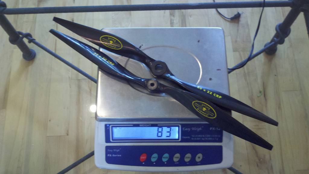

Mike Gaishin has been optimizing his process for making props. Here are some pictures of the latest props that he's made. These props have the same finish, and are as stiff and strong as the props we have been making at 50g. Mike thinks that he can keep the average weight at about 40g, +/- a few grams.
Mike is able to preserve the strength and stiffness through careful optimization of the internal air pressure during molding, the mold temperature, the carbon fiber to resin ratio, and the ratio of cloth to tow.
For now, we will continue to make props at 50g, but we hope to start bringing the weight down in the near future.

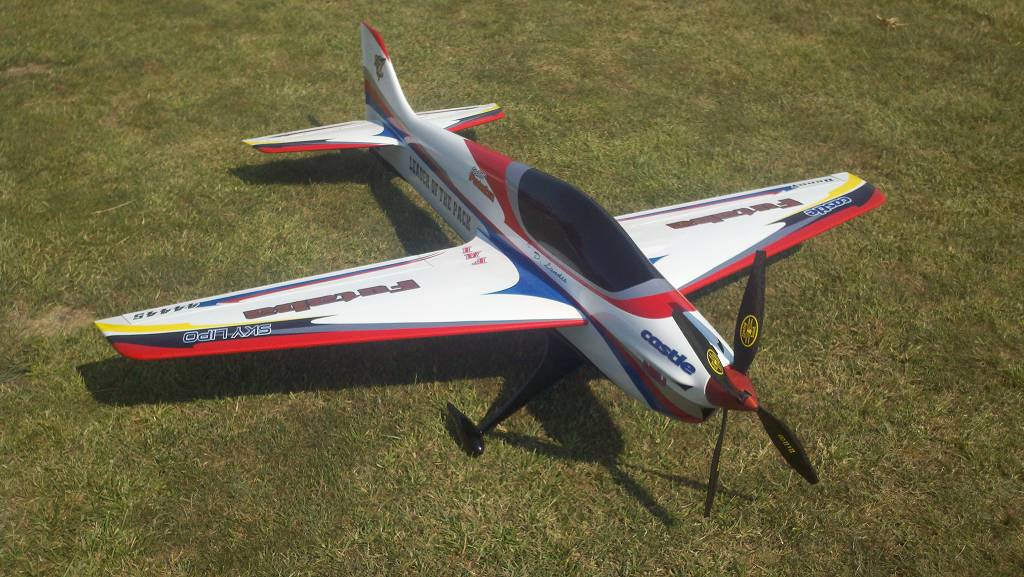

Hey Brenner Thanks for everything. heres a pic of my Worlds Visa converted and it flys so straight and true I love it. I only have 3% down elev mixed to throttle and maybe a .5% mix rudder to ail/elev for the Knife edge triangles. This plane is one of 2 or 3 we built with the elipitical which was considerably slower then the stock Visa but has plenty of speed when need be. Props are reshaped to the APC's as close as I could make them and with the 25C TP 5000's its got plenty mo. Front is a 20.5x20 and the rear is 20.75x22. Here is a pic of the polished drive I am using at this time. I am going to use the painted one with the stars as the back up.
The second pic slithered across my shoes when I was doing the knife edge loop. I came very close to crashing lol as well as something else.
C

Hey Chip,
The polished spinner looks very sharp! I'm looking forward to seeing your setup fly.
