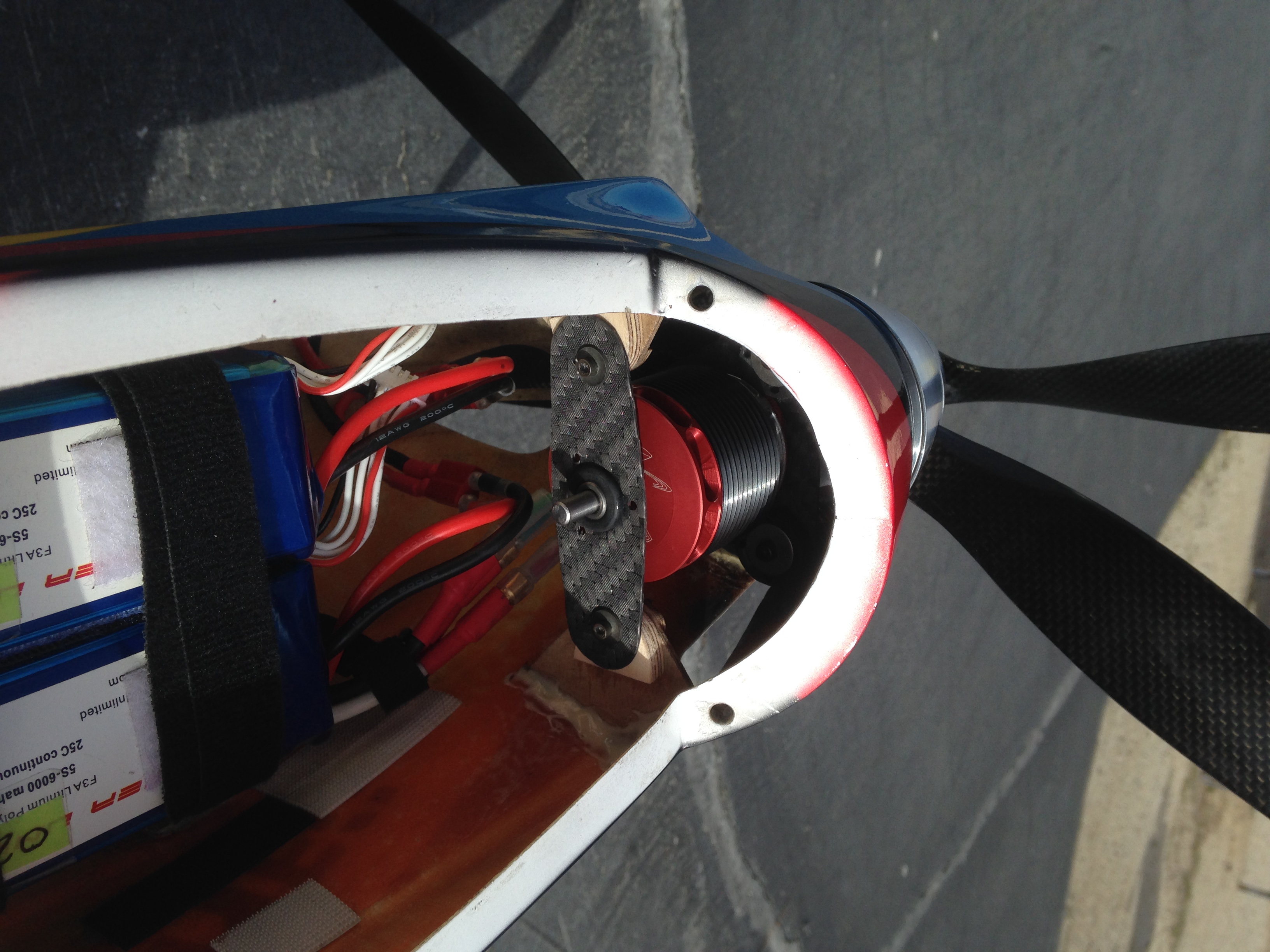

Brenner sent me a V4 and a Kontronik Pyro 650 motor. I installed it in my Episode which previously had a V3/Neu. It was pretty simple to retrofit since I used his mounting plate with the V3 installation with the bulkhead in front of the unit. About a 3/8" spacer and cutting the motor shaft put it in the model. I was able to get 5 flights in yesterday. I didn't weigh anything but this is quite a bit lighter then the V3/Neu. The unit is just beautifully engineered and fabricated. And it is really simpler then the V3.
The V4 is very smooth in the air. Quieter then the V3. The power is maybe a bit better then the V3/Neu but I have the Pyro 650. The Pyro 600 is higher Kv and should make more. But I honestly wouldn't know what to do with more power. I very rarely have to use full.

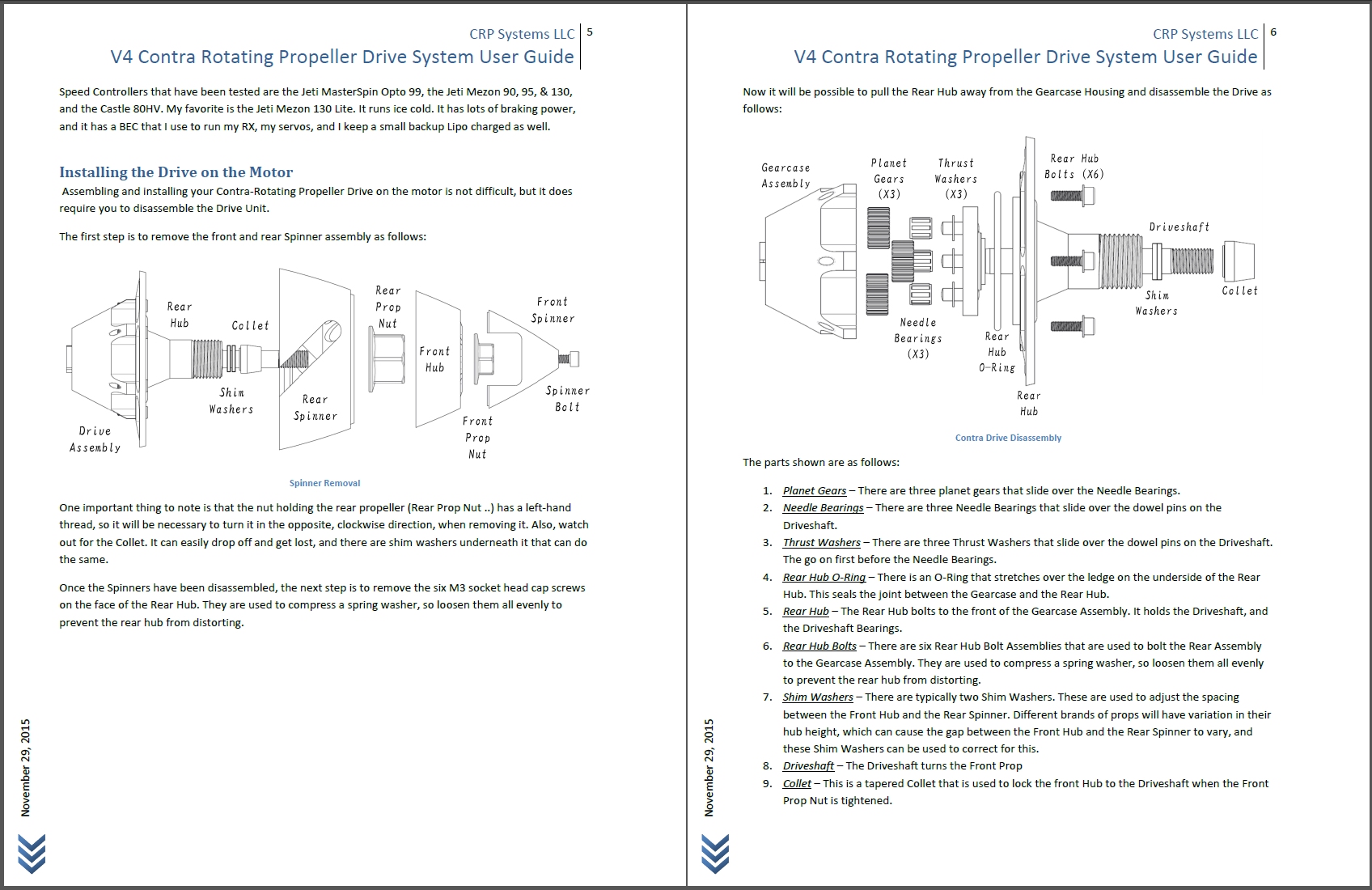

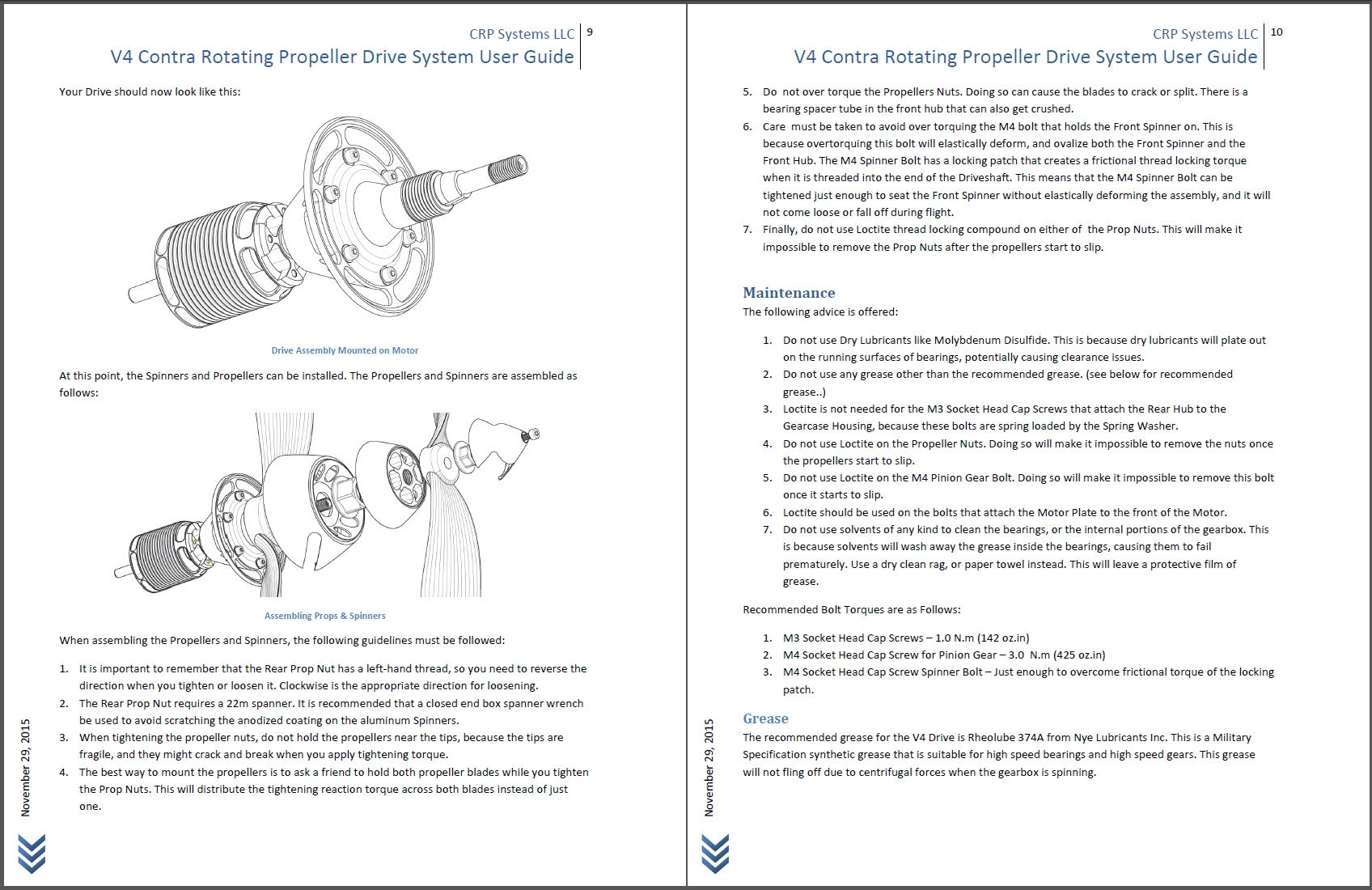

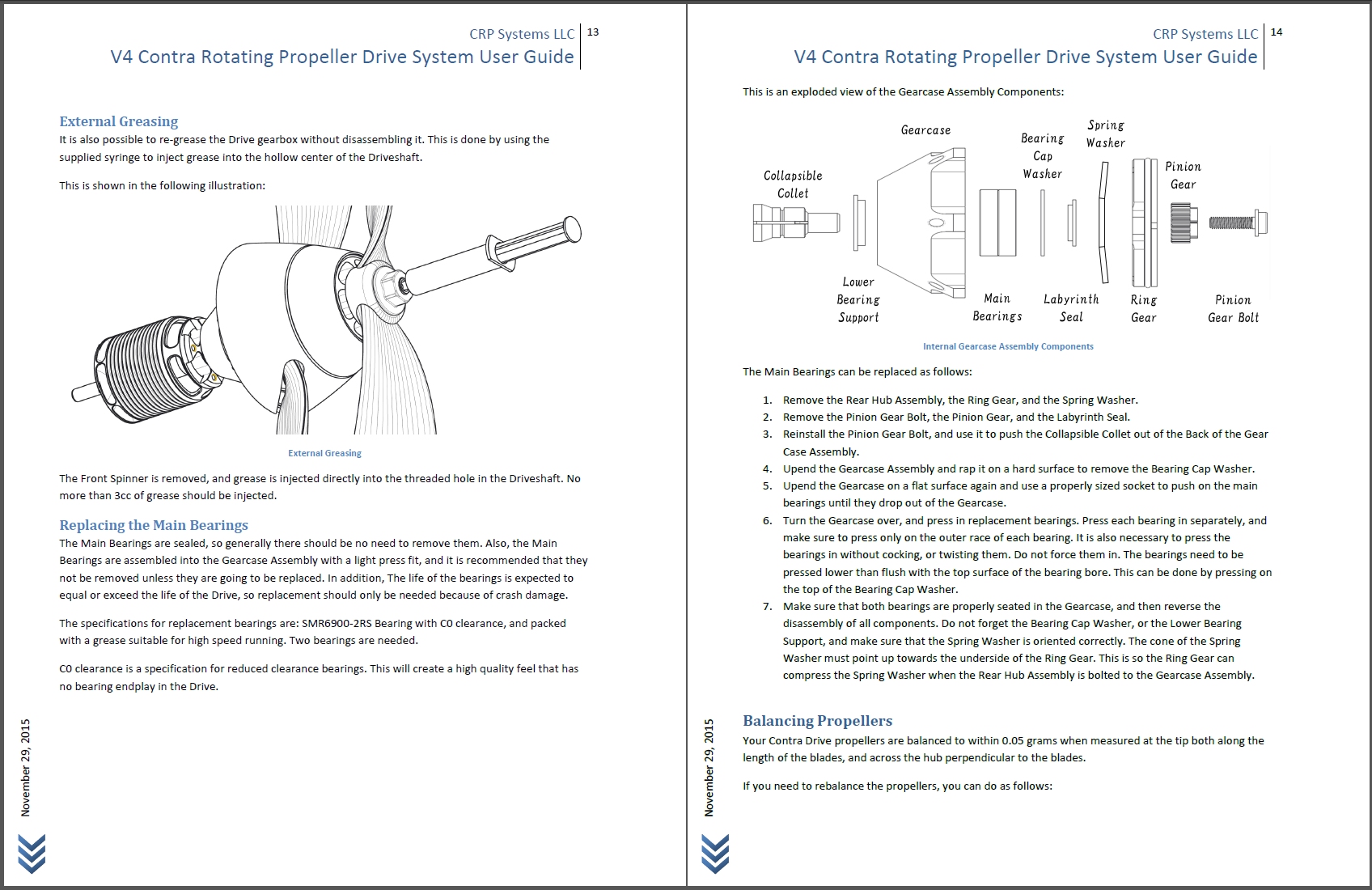

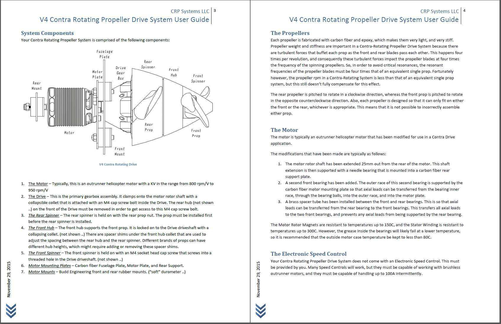

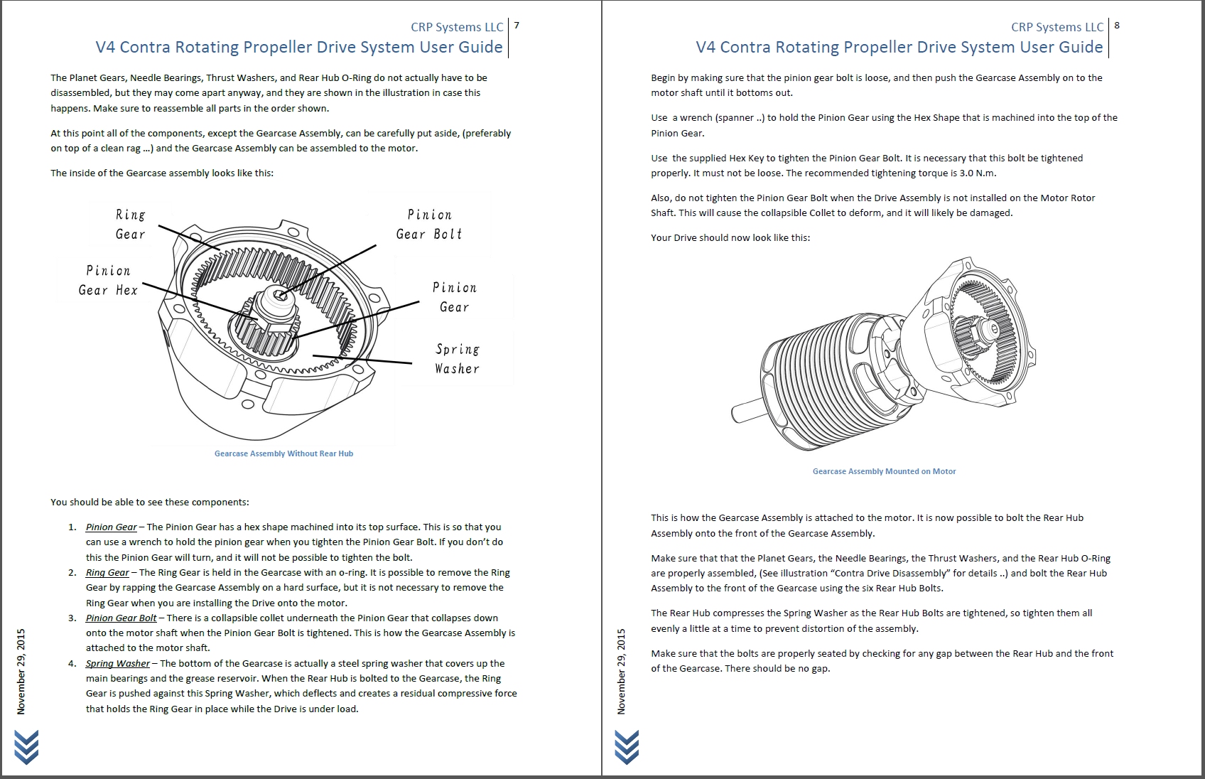

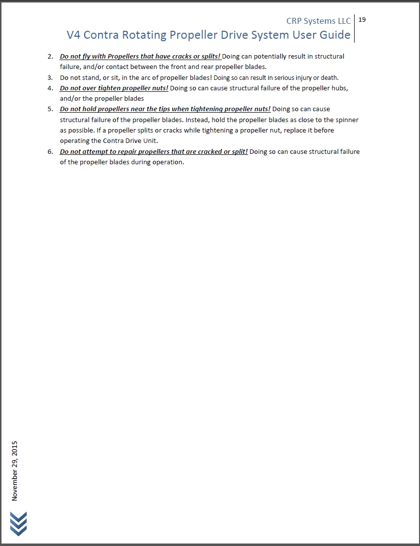

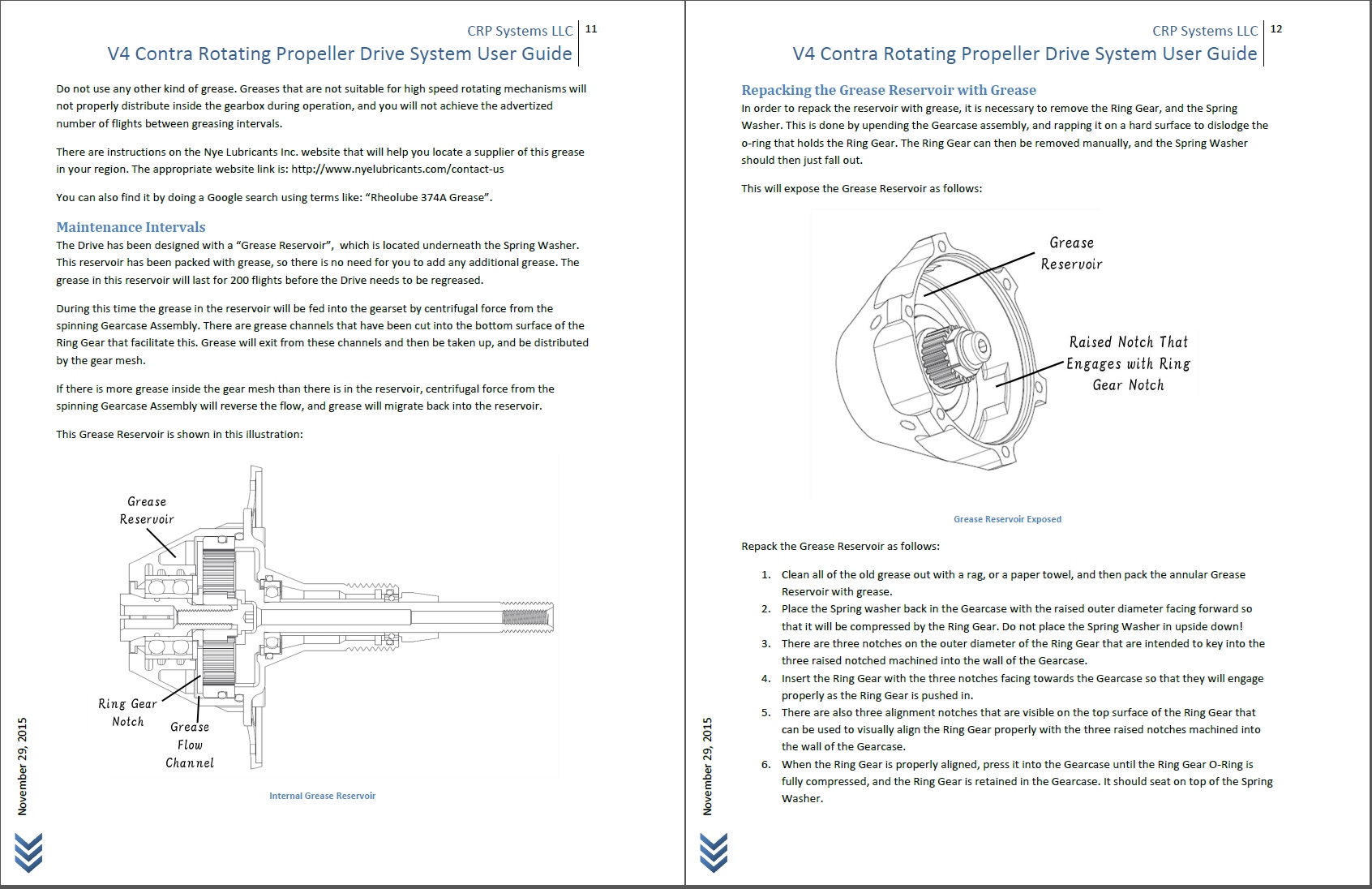

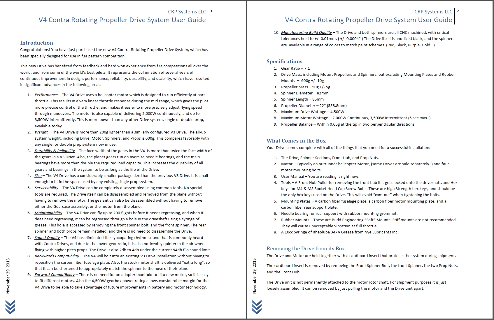

The V4 Manual is finished.
See attached for a first draft.
Brenner ...

Brenner,
Having never run a contra, I have to say your manual answers all my questions about theory of operation, mounting, use, and maintenance. How is the manufacture-ability of V4 vs V3? Any issues which might affect drive availability or spare parts moving forward?
Jeff

Originally Posted by Jeff Worsham
Brenner,
Jeff
Hey Jeff,
The manufacturability of the V4 is actually quite a bit better than the V3 Drive. This was one of the reason why we developed the V4 concept in the first place. The V4 has fewer parts, and we have developed roller burnishing methods to size the critical bearing bore dimensions, and the collapsible collet diameters.
The CNC machine that we are using to make our parts is brand new, so it holds tolerances very well. It is actually capable of holding +/-0.005mm (+/-0.0002") but we don't specify our parts that tight. The tightest tolerance we specify for CNC machining is +/-0.01mm, and then we use roller burnishing to get critical dimension tolerances down to +/-0.005mm. This means we are able to reliably hold a Cpk = 2.0 on all critical characteristics in the design. (Cpk=2 means that the part tolerance is twice the manufacturing process capability..)
As far as spare parts are concerned, moving forward we should have the same parts availability for the V4 as we have now for the V3. Right now we are challenged because we are committed to supporting our V3 Drive with spare parts, and at the same time we need to find money to invest in manufacturing our first batch of parts for the V4, and since we haven't actually sold any V4 drives yet, we are essentially using the revenue stream from one Drive to support two Drives.
However, this is a temporary problem that we have solved by reducing the size of our first batch of V4 parts. This makes parts quite a bit more expensive, but as soon as we start shipping V4 Drives, the additional revenue stream will let us manufacture more economical batch sizes.
Brenner ...

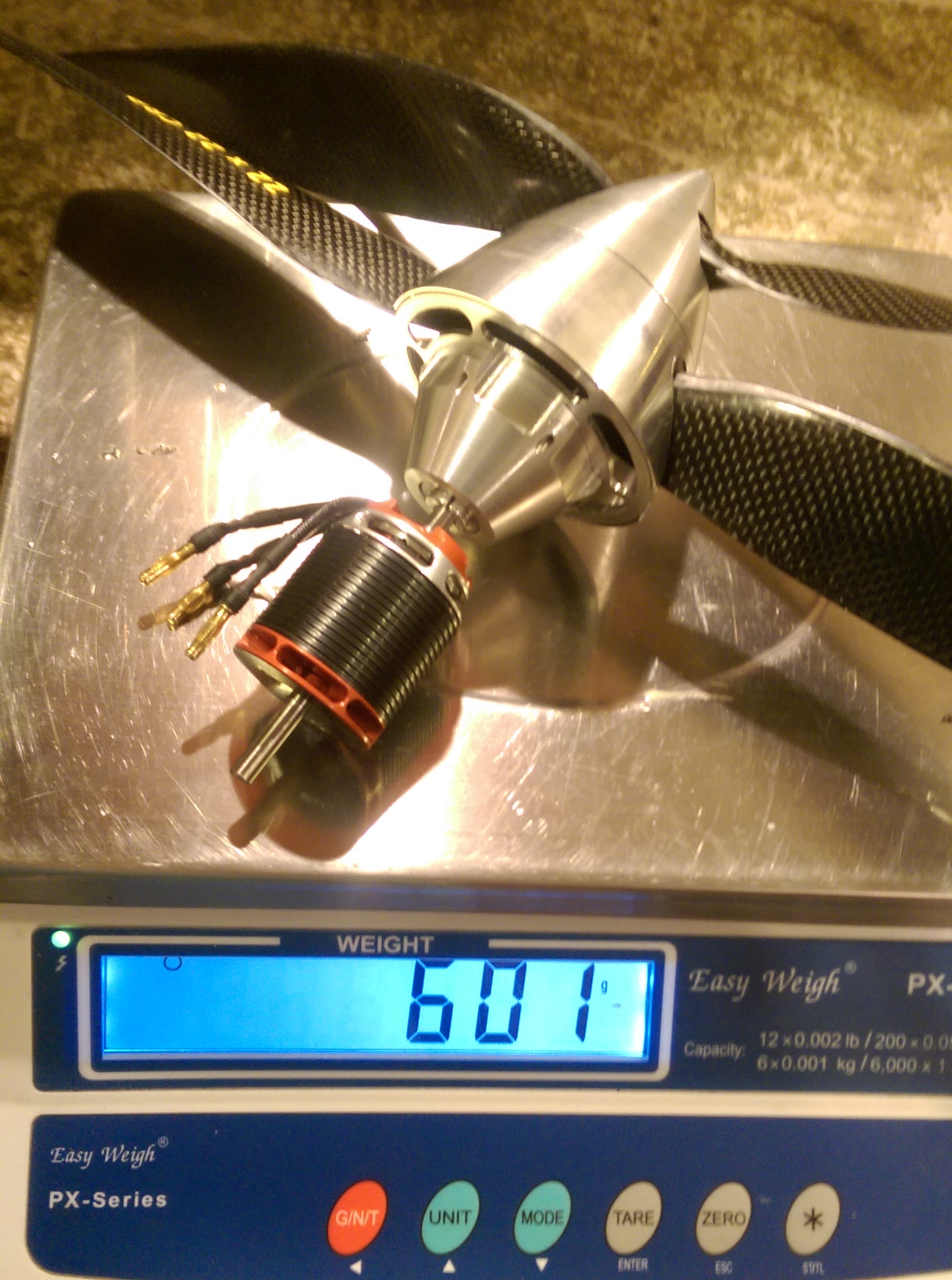

Hey Jason,
We are recommending the Budd Mount System. The rubber in these mounts is soft, but the stiffness of the mount is non-linear in that it stiffens up when the Drive is deflected.
This means that high rpm vibrations are isolated, but the drive is still mounted firmly in the plane.
The V4 will come with a complete set of mounts and carbon fiber mounting plates for this system.
Brenner ...
PS-> Here's a picture of the V4 on a scale. Proof that the total weight, including Drive, Spinners, and Props, is 600g
