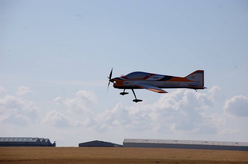

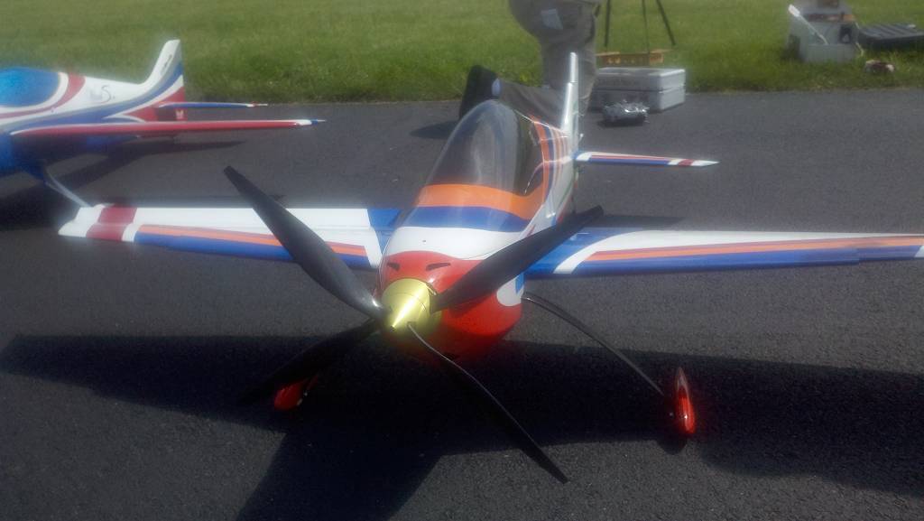

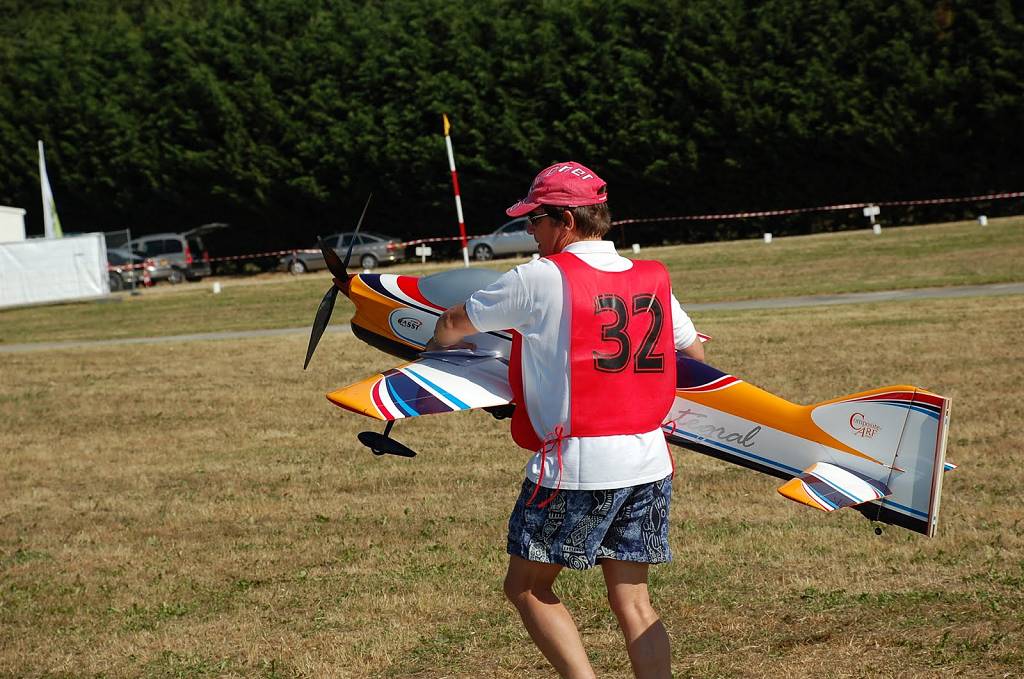

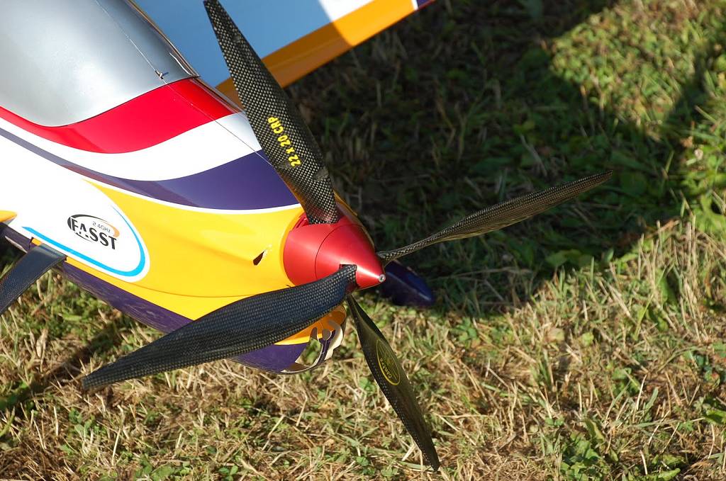

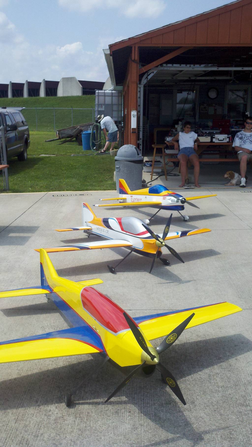

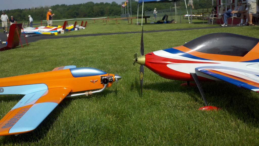

Here are some pictures of Contra setups here in the American Midwest, and one picture of Dmitry Zagitov's setup in Russia...

Hello Vince
Congratulations for your great championship.
Do you think it's easier with contrarotating prop ?
Claude

Hello Claude,
Thank you for your encouragement !
Is a mustang easier to drive than a 2 CV ? Hard to tell !
All I can say is that the mustang is more efficient.
Vincent ...
