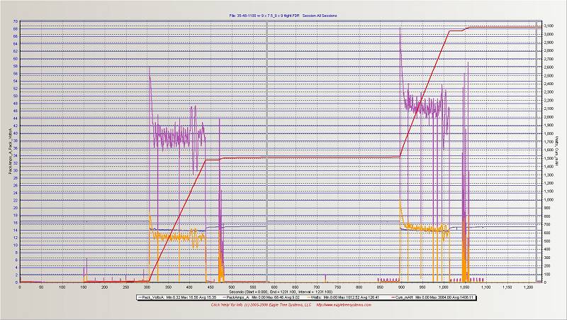

#32
Joined: Feb 2009
Posts: 86
From: Burlington, KY
Okay, flight session #2 provided my first onboard flight data. I used a TGS 9 x 7.5 prop on the 35-48-1100 on 4S 2350's. What I found out is what I expected. It wasn't enough prop. The speed was about the same as the shorter motor, but the current was down. This points to more available torque from the longer motor. I then changed the timing to high on the Pheonix ESC and it ran smoother and used even less battery. So, it is off to buy more props. The 35-48 certainly runs more efficient than the 35-42. Next set of tests will use the 9 x 7, 9 x 7.5, ad 9 x 9 APC. I may even try an 8.8 x 8.75 APC. The TGS prop was not very impressive. This weeks weather is looking promicing for more flight testing. I'll keep you posted.
I have attached the Eagle Tree Flight Data report. Estimated in flight speed is 94mph.
Take Care,

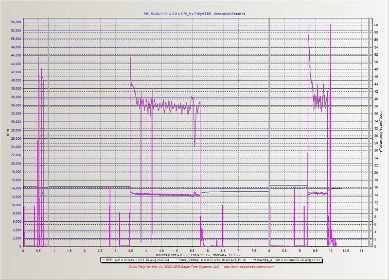

#33
Joined: Feb 2009
Posts: 86
Today I got some flights in between the rain storms. I flew using an 8.8 x 8.75 & the 9 x 7 APC "E". The flight with the 9 x 7 is after the second bar on the Data logger file. It is very close, but not there yet. It was about the same speed with both props. The 8.8 x 8.75 is my 428 prop of choice, but it works much better @ 20,000 than @ 13,000. The 9 x 7 "E" pulled much harder and accelerated much better. Hopefully the 9 x 7.5 & 9 x 9 APC "E" props will be here this week. The onboard data collector is a great tool. There is no substitute for live information.
Take care,
