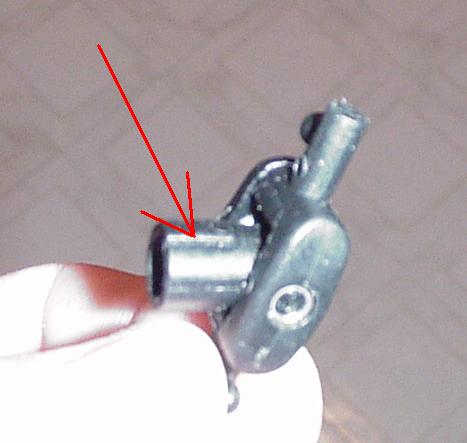

Old 06-26-2006 | 02:36 AM
Joined: Sep 2004
Posts: 787
From: LAKEWOOD, WA
Default RE: BLADE CP PROBLEM!! HELP
Hi
You may also want to check to see if this part of the head assembly isn't cracked.
Old 06-26-2006 | 07:21 AM
Joined: Apr 2006
Posts: 4
From: Mount Sidney, VA
No, its not craked, but it moves kinda bad, could that be it?
