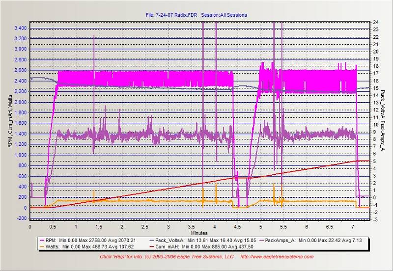

OK, I have a little update. CF blades rule. I have not had a chance to do much flying with them yet. but I hover tested last night. I put some radix CF 325mm mains on. The average amp draw dropped & from what I can tell from the eagle tree data before I was drawing ~180mAh for 1 minute of hovering in normal mode. With the new blades it was down to ~140mAh. I couldnt believe the differnce. The heli also seemed more responsive and more stablein hover. I love these blades...
Also I replaced my cooked tail servo with a futaba S9650. I like it so far but havent had a chance to test it out in backwards flight yet.
heres the eagle tree chart from my test hover with the radix blades: RPM sensor was buggin out ???

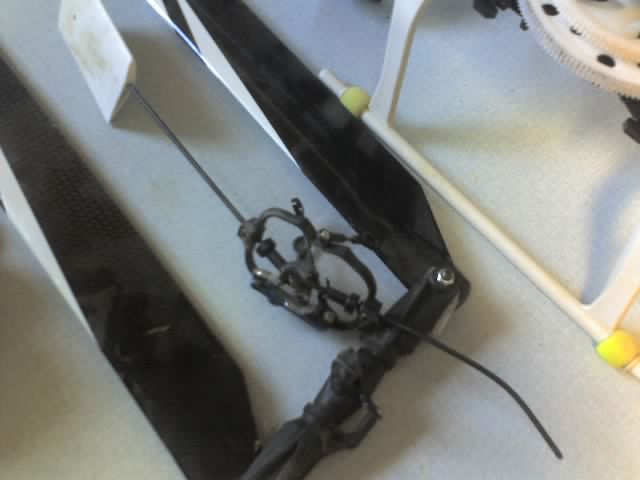

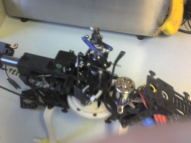

Oh...My MT has had her maiden crash.... And it was a real smack down.
I will be changing a few things I think in the rebuild so I will post when back in the air. Really loving the radix blades & the 9650.... gy401&s9650 are A+++++++++
Also is anyone else out there on RCU flying one of these??? Or are guizmo17 & I alone.
damage report:
blades, flybar, paddles, flybar control frame, spindle, main shaft, main gear, rotor head, blades grips, & pretty much every control link...err [:@] Hit hard inverted. [&o]
