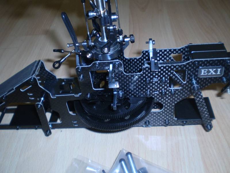

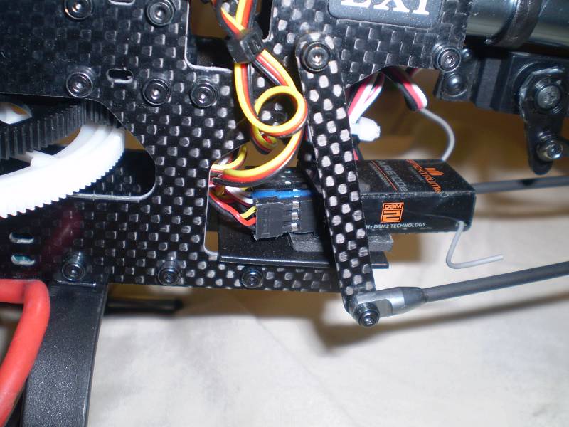

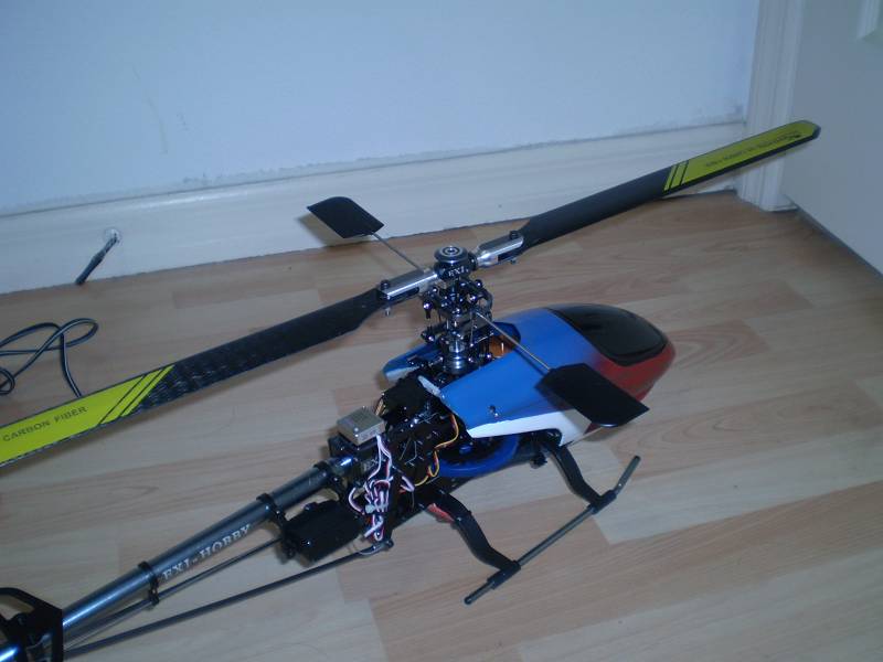

just got this on wednesday and just finished the my build. it did not came with any instructions whatsoever. took some pics of the servo placement and electronics placement. still lots of wires too clean up...but i'll clean it up after the maiden flight.
first impressions is excellent. the carbon frames is strong and looks great. metal head and tail looks and operate very nicely. this helicopter remains me of my mini titan. flys very similar as well. i'm going to fly it like i stole it
btw the hs65hb's in this heli all have metal gears. the metal gear kit is expensive for 16.95 each but worth every penny virtually making the servos indestructive
bad news is i chewed up my main gear after accidentaly flipping the idle up switch instead of timer switch. the scorpion esc soft start up truly does suck. all well no big deal. very nice heli.

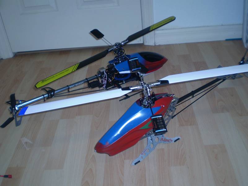

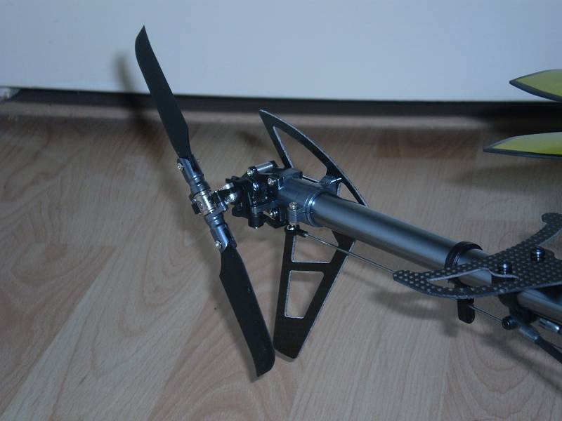

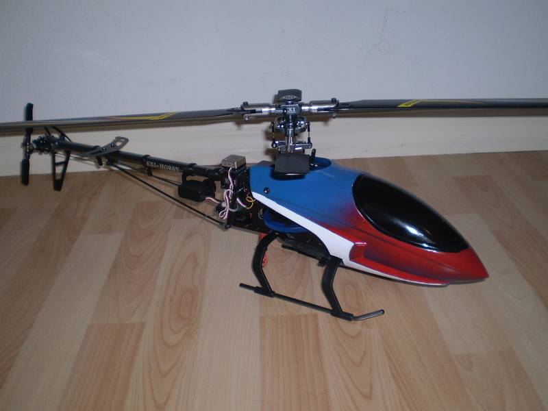

wow. this helicopter flys nice. main shaft, and feathering shafts are the same as the thunder tiger mini titan e325. trex 450 main gears are compatible.

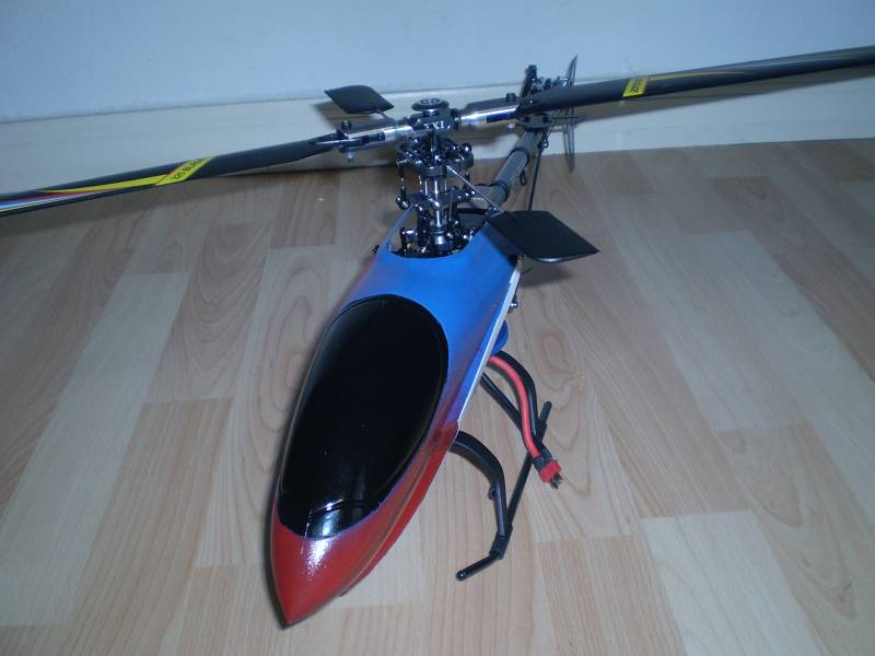

just came back from the park with the exi 450 pro. WoW.... nice and smooth. flys very much like the mini titan e325 except its even better. did plenty flips and rolls and a few tic tocs, loops and she begs for more.
i get a vid going next time i take her out. maybe today after the lipo finish charging.
i skipped the flybar weights to make it more agile.
i tried the plastic blades[:'(] they truly suck. couldnt even get them to track. i went with 315mm woodies i had laying around. much better than the woodies. last i checked xheli just sent me tracking info for the carbon fiber blades. should be here in a week.

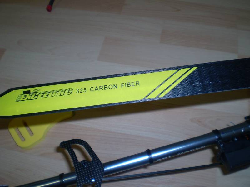

xheli just sent me my carbon blades that wasnt suppose to come with the kit but an error in the ad description. sweet....free carbon blades. what a deal i got for this bird. 119 bucks

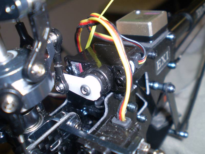

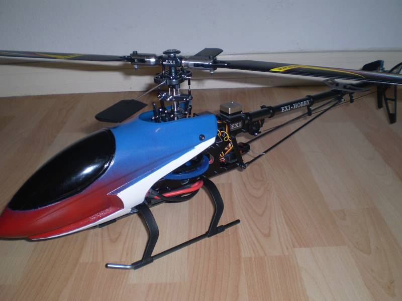

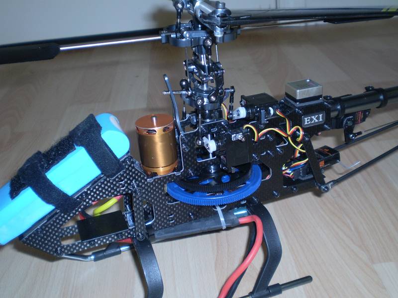

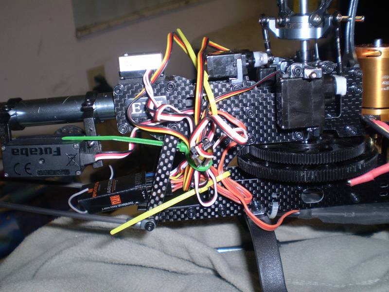

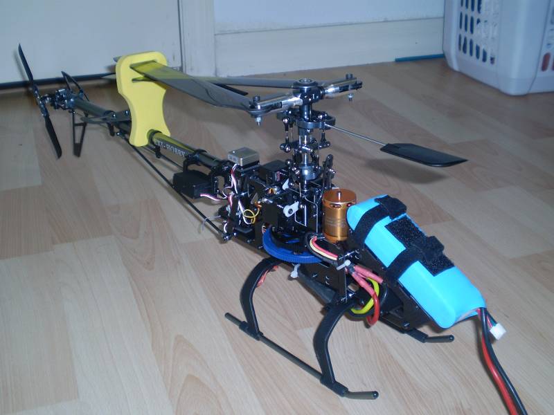

some more pictures of the electronic placements. she's all set-up. just weighed it. 2 lbs. my poseidon480 which runs on 4S is also 2 lbs.

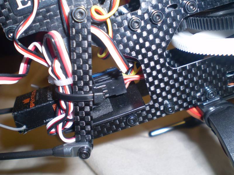

noobflyer01...Can you post pictures for connecting servo to rx? That would be a big help. Really appreciate of your work.
Old 01-22-2009, 06:25 PM
noobflyer01
Join Date: Feb 2008
Location: orlando, FL
Posts: 2,544
Default RE: exi 450 pro review
sure khongtac. i'll take some pics tomorrow when im home. the rear servo goes into elevator channel. the left servo i used for aileron servo, the right i used it as the pitch servo (aux channel for spektrum rx)
Old 01-23-2009, 09:55 AM
noobflyer01
Join Date: Feb 2008
Posts: 2,544
here's some pics of the receiver khongtac. not sure if this is what your after. are you having problems setting your's up? if so let me know what they are and see if i can help.

Because I didn't really figure out of left and right servos for the past few days, it drove me nuts bro. You were saying the left servo used for aileron channel but which channel the rx that you used for the right one...I bought the Spektrum AR7000. The AR7000 has 2 Aux channel.
Old 01-23-2009, 11:40 AM
noobflyer01
Join Date: Feb 2008
Posts: 2,544
khong try AUX1. as long as you get the elevator servo correct. it doesnt matter which servo is used for aileron and pitch. as you can easily correct this by programming.
what's your radio?
