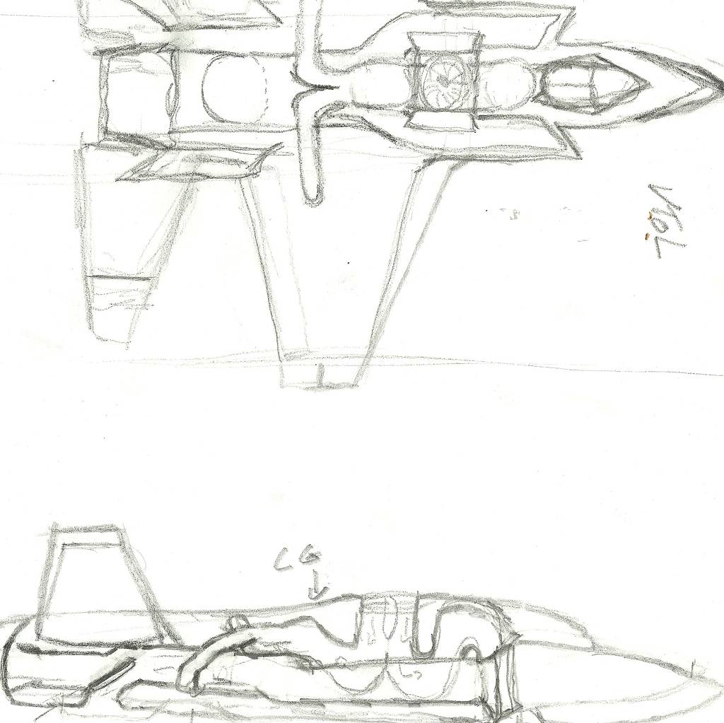

I'm curently working on a EDF V-TOL Aircraft & need to Know How to Acheive maximum thrust on 70mm Unit. Is it the # of fan blades, Motor with high KV or low. I'm looking to reach Around 5-6lbs of thrust for boath Edf units. Have no Clue where to start & need a Decent power plant. Can anyone help.
Sky,
Sounds like you have an interesting project.
Got photos? Drawings? Started building yet?
Old 07-24-2011 | 06:59 AM
Joined: Nov 2010
Posts: 6
From: Crysler, ON, CANADA
Default RE: High thrust 70mm EDF HELP !

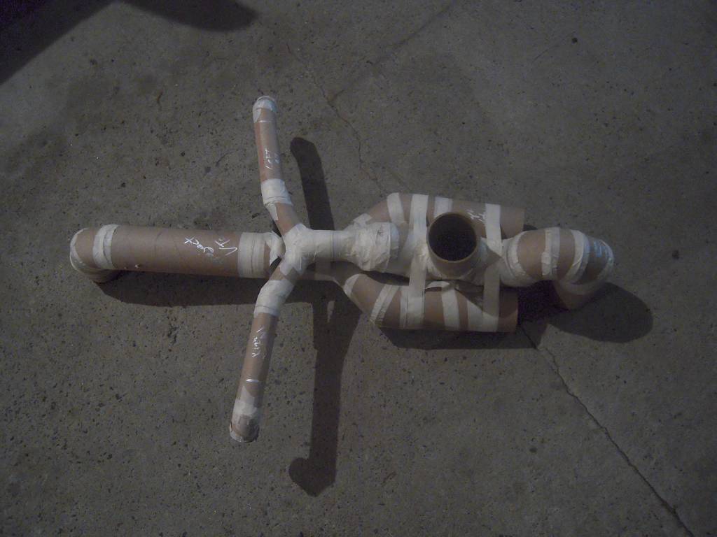

Just uploaded a few pics from my poject. This is version 1. If it works it will be making this desing in fiberblass. Anny feed back will be taken in cosideration to inprove it.

Looks interesting! EXTREME RC knows his chit... If you can keep the weight down it should be a really cool plane..
