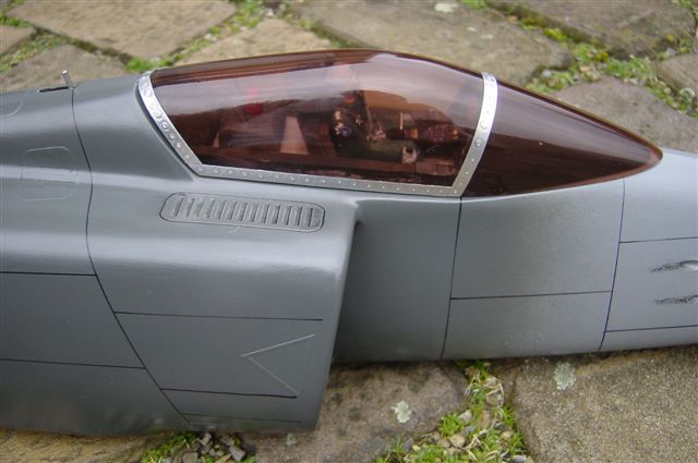

Old 02-26-2005 | 03:50 PM
  #33
Joined: Oct 2003
Posts: 63
From: Heemskerk, NETHERLANDS
Default RE: SUPER SNIPER
Hoi,
The Sniper is ready for the decals...
And after that job some weathering...
Grtz

Old 02-27-2005 | 12:14 PM
  #34
Joined: Nov 2004
Posts: 2
From: Orlando, FL
Beautiful sniper you have there Nickos.

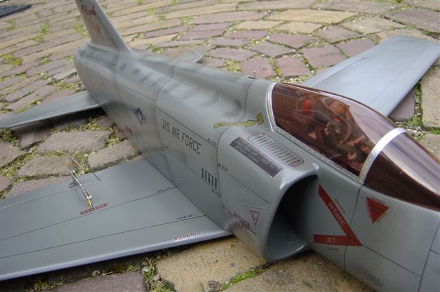

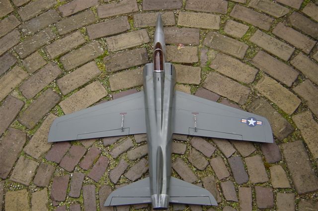

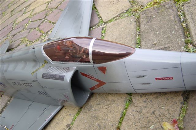

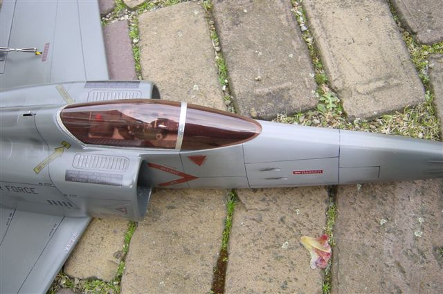

Old 03-09-2005 | 11:15 AM
  #36
Joined: Oct 2003
Posts: 63
Some new picture'swith the decals
grtz
