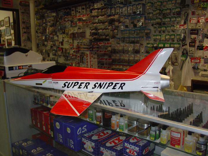

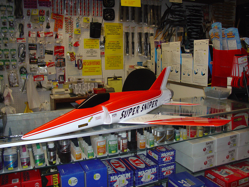

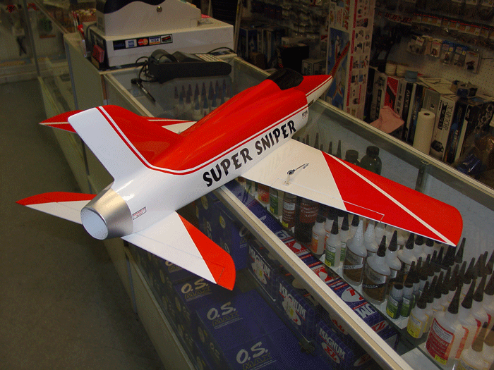

Hello All.
I thought you may be interested in seeing my freshly completed Super Sniper.
It was the all white version that I started with. I would like to say that this is one very nice and well thought out model jet.
My hat is off to HET.
Power is a mini 480, Kontronik 400 - 36 and a 3200 20C 3s Kokam. AUW is 38 oz.
I would like to add that Mark at Rt models and Markos at warbirds.com were very nice and very helpful to deal with. I highly recommend both of these guys . Great service, knowledge and excellent attitude.
Before any of you ask if I am a dealer the answer is yes. BUT, I have made an agreement with Mark and Markos that I will sell the Sniper in my store only and will not interfer with their mail order business.
All I can say is contact one of these guys and get one before they are all gone. []
[link]http://www.warbirds-rc.com/Merchant2/merchant.mvc?Screen=SFNT&Store_Code=W[/link]
[link]http://www.rtmodels.com/[/link]
I will post a flight report ASAP. (crazy Texas Weather) [:@]

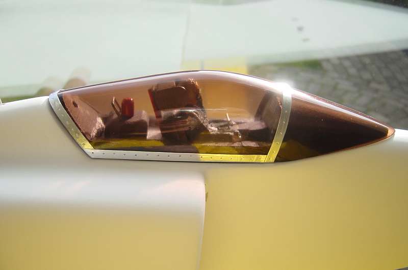

Hai,,
Did some work on de cockpit for the Sniper.
It's realy nice todo and looks cool i think.
Will make the Sniper with full detail's like an F16 or something.

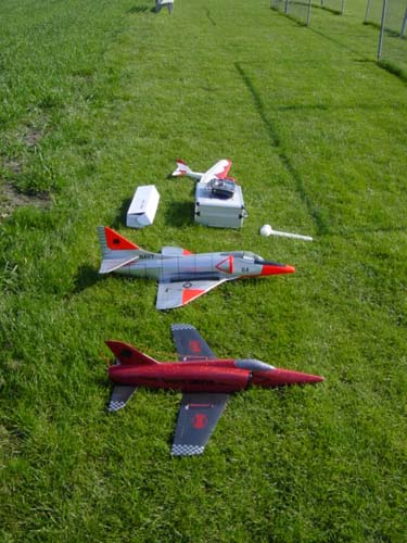

Larry,
Thank you and i'll post my picture's.
The A4 is an RBC kit.
The Sniper is an original Speedmodels kit (the glitter one)
Some picture's of the sniper and,
SAND the intake's smooth of the Sniper....
i'll also put some extra cooling in my airframe for the lipo's...
Grtz
Nickos

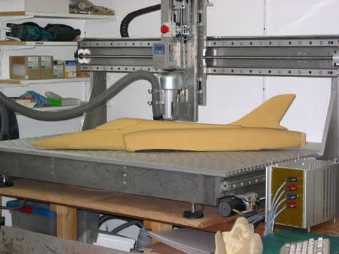

The new Sniper 90:
ID:	218524   Click image for larger version
ID:	218525   Click image for larger version

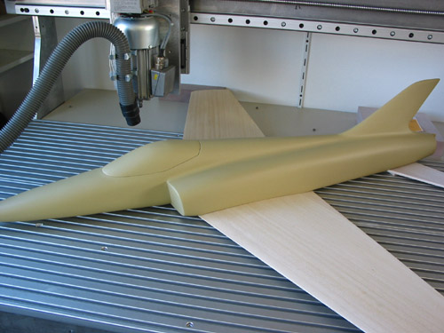

Fuselage & wing.
Model ready for finish with alu sheetmetal:

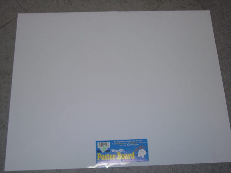

Yes, I am VERY anxious to fly my Super Sniper. I am new to electric jets and I have never used a bungee launch before. It is very difficult to get information on this subject. I believe that I have built a Dolly system that should work. I have been flying Ducted fan and turbines for many years and I will still fly my turbines but the electrics have really caught my attention. My planes MUST be high performance and fast or I get bored quickly.
The thrust tube that I made was not the one included with the kit. I found some very thin, lightweight mylar that I used. I simply made it fit the aft end of the fan tightly and the exit on the fuselage also tightly. After cutting and rolling it to shape, I simply taped it together. It worked very well and is extremely smooth and "slick". It can be purchased at hobby lobby craft stores and probably others. It is with the poster board material. It is the same as poster board but has this mylar coating so you can wipe off or remove what has been written on it. I take a picture of it, that is easier than trying to explain.
Please keep us posted as to the progress on the Sniper 90. I will want one when they are ready.

Maybe someone can help you with a bungee at the first flight.
Start straight against the wind.
For the Sniper 90 I am waiting for the alu sheetmetal.
I will show a picture when I have started.
In two weeks you can see the new Aggressor EDF 480.
This one will be smaller than the Sniper 480.
So it will be faster.
Nice stuff that poster board, I have never seen that.
Have a lot of fun.
