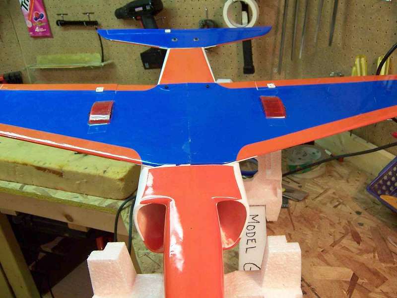

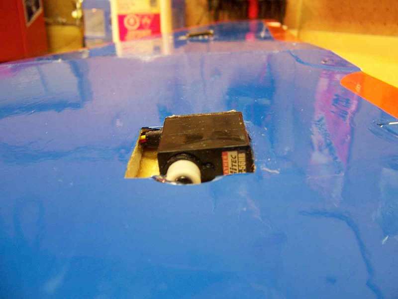

Just working on my Sniper and getting near the end. Can hardly wait to fly her. I thought I would pass on this building tip I found while trying to make the wing servos look a little more elegant.
I am using Hitec HS-56 in each wing panel for the ailerons. As you know they stick out below the surface level of the wing. Just before tossing out a used Old Spice anti-persperant container, I noticed the nice shape of the cap.
I cut the cap roughly in half and then sanded it down to the right height just so it covered over the servos. Pictures attached pretty much show the result. I think it looks cool, streamlined and didn't cost a cent.
Cheers,
Randy Smith, Calgary, AB
BTW, I'm using Mega 16/15/2, TP3S2P 4200, Phoenix-45, 480 mini fan.[img][/img]

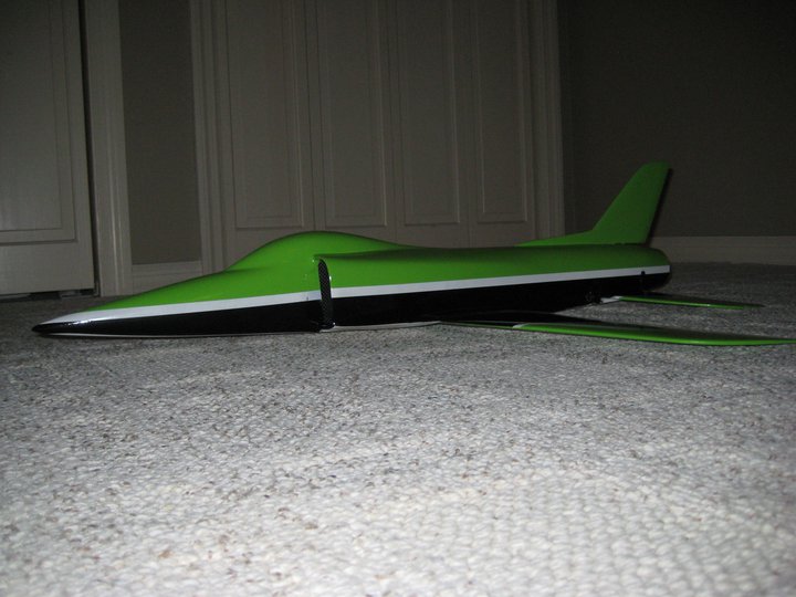

that sniper on 4s with 3600-3800kv, ( check out mega motors edf16 or 16/25/1.5r ) will really make it move out better then 3s
heres a pic of my phoenix. its a sporty like the sniper but way slicker and much faster
