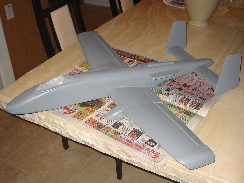

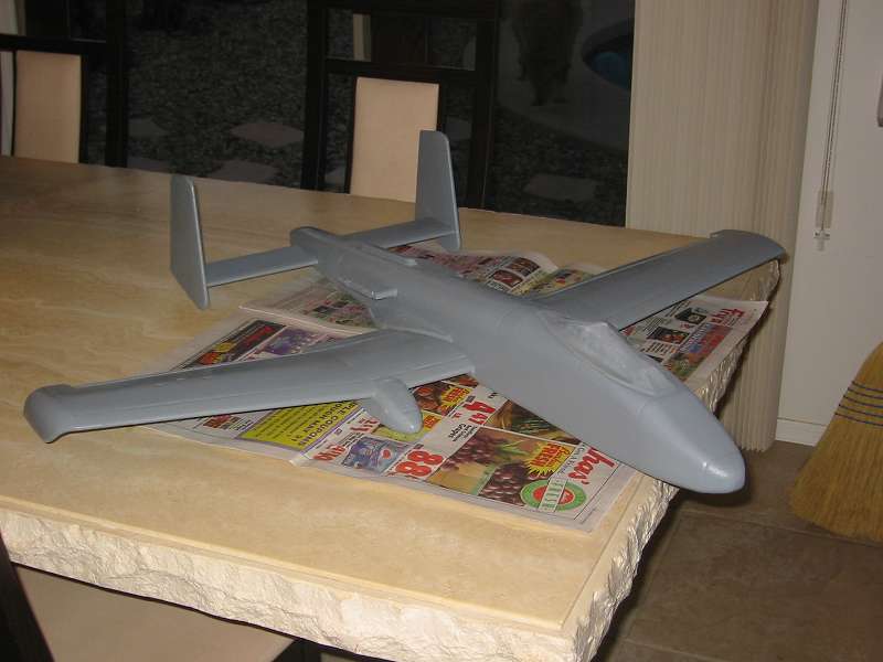

PIX as of tonight. I found this new spraypaint from krylon, its water based, latex. Went on nice too.

Old 05-28-2005 | 10:36 AM
CTulanko's Avatar
Joined: Feb 2004
Posts: 343
From: Cincinnati, OH
Default RE: EFLIGHTLINE A-10
Panther,
E-Flightline has a very good reputation and the combo A-10 you bought is an awesome flier! You will be very happy with it. I was going to suggest you stiffen up the wing with CF, but it looks like you already did so by glassing. I would be curious to your final weight and will agree with Larry...handlaunching is probably going to work fine.keep us up to date on your progress and maiden flight.
