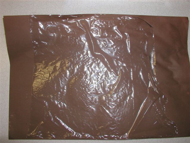

Here is a sequence of replies that describe the process I used. I'll use a receiver and a single servo to demonstrate the setup; you will probably need more electronics for the average setup; in all cases the servo, battery and ESC leads should exit the receiver wrapper together; the antenna wire should exit the opposite side; this will become clear later.
You will need a ~0.3m x ~0.3m piece of thin plastic wrap (Cling Wrap), and a strip of aluminum foil ~0.3m x ~0.05m.

Layout the electronics so the antenna and the servos/ESC/battery leads are stretched in opposite directions. Wrap the plastic around the receiver to provide insulation for all the electronic connections. Tape the ends of the plastic wrap. This creates a plastic "cocoon" around the receiver. Do not allow any wires to pass over the top of the receiver before exiting the end of the cocoon.
Posts: 62
From: North Yorkshire, UNITED KINGDOM
Wrap the aluminum foil strip around the plastic wrap cocoon several times; crimp the ends around the leads. You can tape the aluminum closed, too.
Good luck. Let me know if this works for you!
