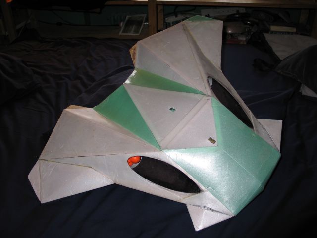

I have been working on a concept for some time, along the lines of the Horten wing. I have a set of GWS 75 and ten cell pack. My D-WAV-II “D" for Ductlings series is approx 22oz. 30"wing span. I’m afraid it will not take off. My knowledge of duct fans is limited. I am curious about brushless and Li-ion battery technology; could this be the direction for me?
A 30oz. thrust would probably do the trick. What is out there that might fit the bill?

Pretty cool looking project you got there![sm=thumbup.gif]
Do you have a pic of the whole model?

Now that is waaay outside the box!!! Very cool I hope my little contribution helps

Very interesting project. Nice to see something different.
"...A 30oz. thrust would probably do the trick. What is out there that might fit the bill? ..."
I don't know anything about the GWS75's. If it were me I'd use two MF480's, driven by HET typhoon 2W BL motors and 3S lipo's. With the simple ducting shown, that combination will deliver at least 17 oz per side.
Keep up the good work.
