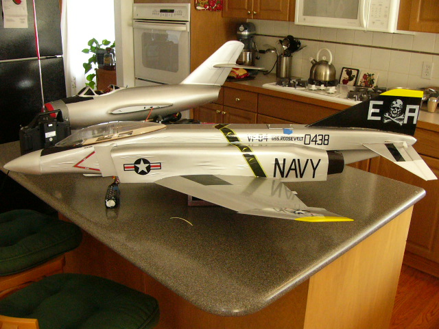

Here is a pic of my F-4

Mediq,
Good look F4. What power are you using? Are you using a bungee to launch? Or ROG?

Larry
I'm using
Mega motors 16/2 x2
hyperion 3s3700 20c x2
cc 60 x2
560 watts x2 @50 amps

mediq,
How do you get this beasty off the ground? Bungee, ROG or hand launch? What is the AUW?
How does it fly? I'm guessing the twin MF480's develop about 32~36 oz of thrust combined. What kind of duration? It looks like 4 minute flights, maybe 5 with throttle management.

The average is 5-7 min and I use a ramp with bungee set at 17lbs of pull

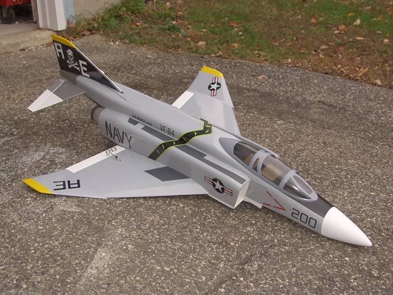

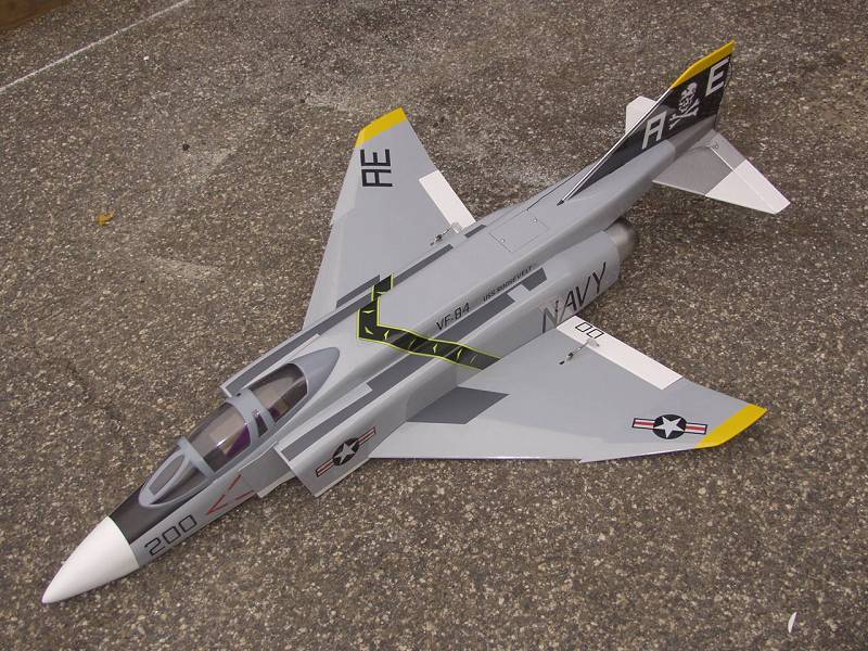

Here's a couple of pics of my HET F4. I stripped off the factory applied silver covering and used light grey and white UltraCote and a little paint here and there to dress it up. It looks great in the air!
