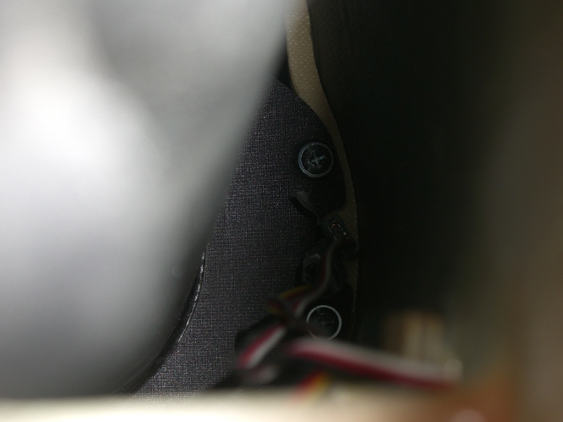

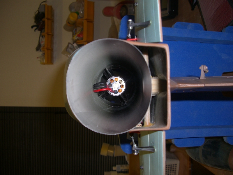

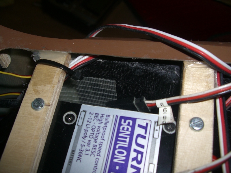

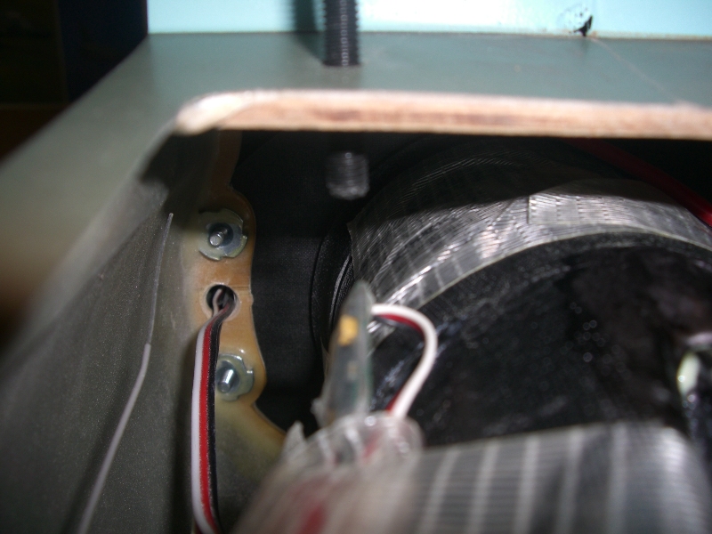

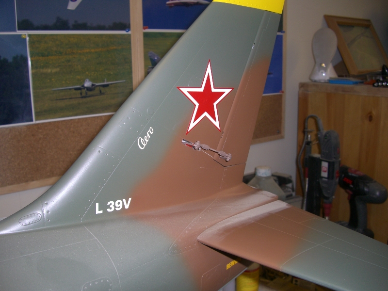

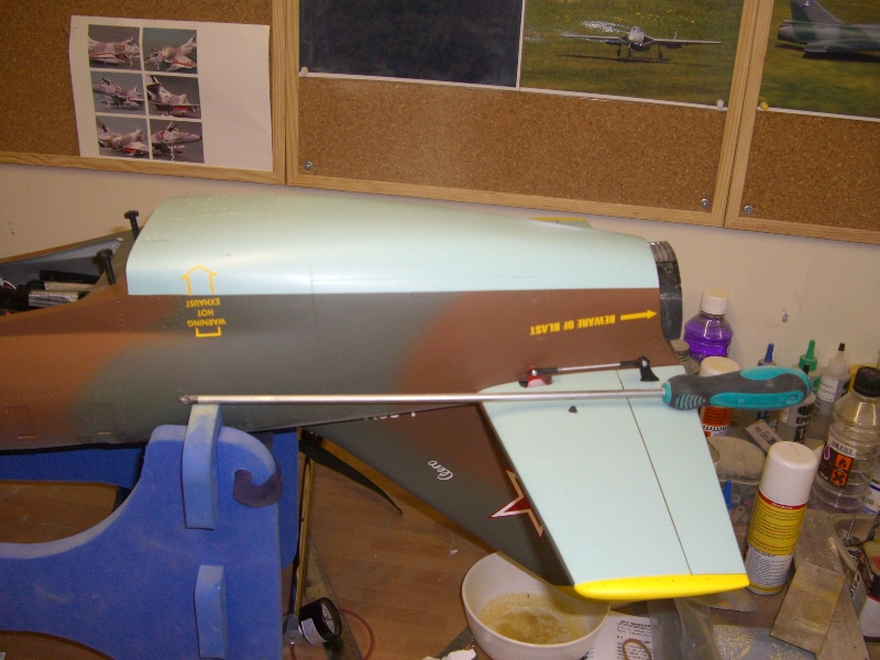

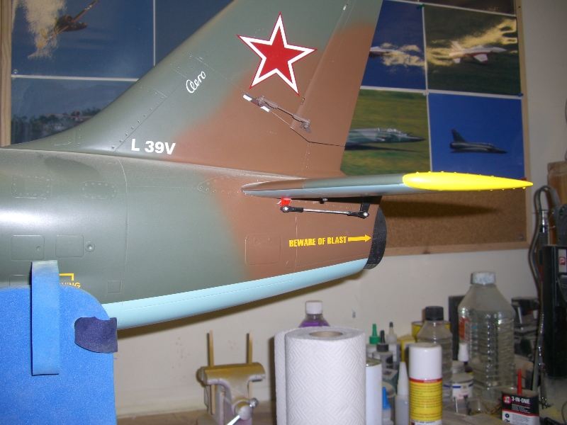

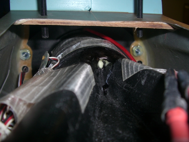

I've been asked to try and show how the fan is held in place using the formers supplied. I've included what I can and a few more. Hope this helps.
The swiss (red) version was my first one which I decided against doing the servos that way on the second.
Neil

Old 01-07-2010 | 03:18 AM
  #132
Posts: 560
Received 20 Likes on 15 Posts
From: Guildford, UNITED KINGDOM
Default RE: Savex L-39 as EDF
Hi Steve
Mine has an exit of 80mm when measured across. Its slightly oval so more like 75mm vertically.
