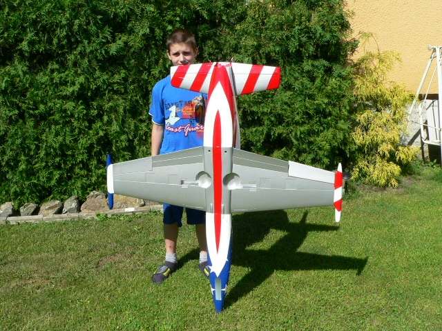

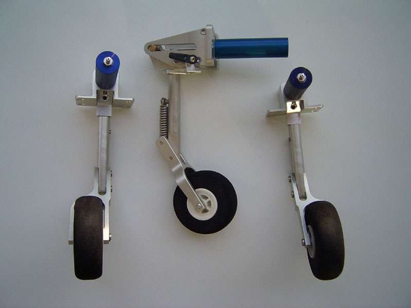

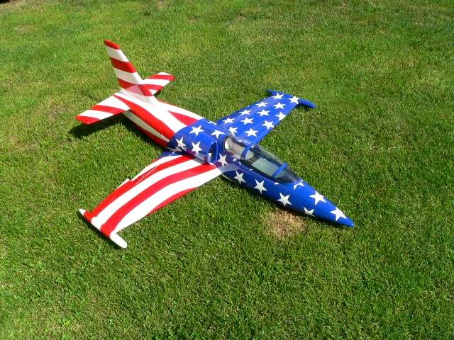

I got a quote from icare. They have one painted with all options in stock. Pictures "should" be attached if I did it right. Retracts look great. They should for $700. For a custom paint job they are saying 2-3 months for delivery.
Is this what you guys are paying?
Are you getting them painted or just silver and you paint?
What is the time from order until delivery?
Carl,
here a complete quote:
Base price: 549.00U$
with options add:
90mm edf ducting: 145.00U$
flaps:59.00U$
rudder: 42.00U$
ready for retracts: 59.00U$
pneumatic retract accessories: 82.00U$
pneumatic retract Jet-1A (complete): 699.00

Carl, you better grab that if they have in stock. I just spent $900 plus and 2 month wait from Savex for one with a paint job. If i would have known about one being available here in the states i would have bought regardless of paint scheme. The dollar exchange rate for euro killed me plus the receiving bank now charges you for the money transfer along with your bank. Due to the unknown bank charge on the other end i was not able to get the flaps as i ordered. So 900 and some dollars and i have to cut out my own flaps and servo well which means no live hinge.... Doug

I don't know Doug, this one is $860 and I'm having a hard time getting over the stripes going in different directions. Spending an extra $100 and getting a paint job you really like seems like not much considering I'll have nearly $2,000 in it after motor, esc, ubec, batteries, fan, etc.
How did you go about picking a custom paint job?

I misunderstood and thought you were paying $700 for the jet. That scheme is bit tough. Forget the $700 retracts too, get a set of spring-air 301's for about $200 and buy individual robart struts that slip on the 5/32" wire. They are about 35-40 bucks. I'll see if i have any pics of my turbine version. I got the Shipping notice from airfreight that the L-39 is on the way. You can always paint the wing to get rid of those stripes..... Doug P.S. You go on Savex site and click on the pictures, it tells you what number scheme it is so you can ask for it by No.
