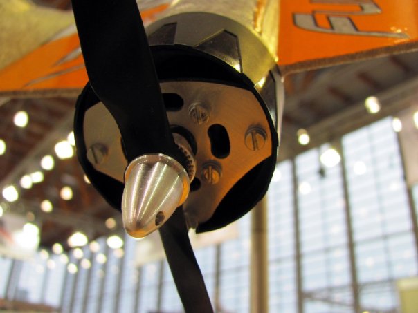

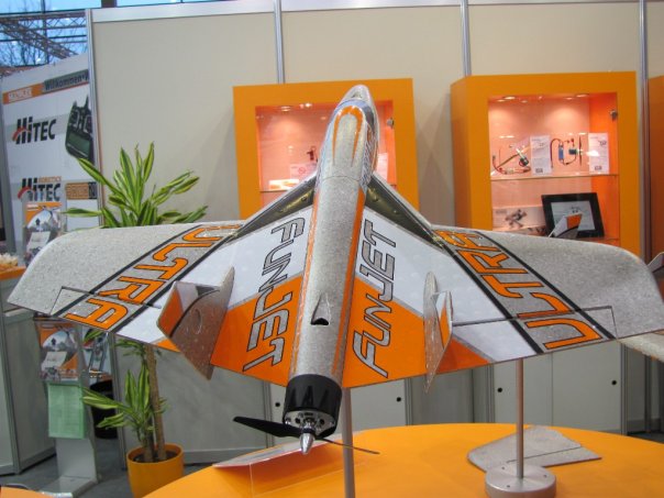

I'll be starting a new FJ shortly
Just so you'll know there is a new FunJet coming out in March 2010
Gee It kinda looks like the one I custom build..the wings minus the tip tanks..
Look at the motor mount plate.....looks like metal or silver plastic can't tell.....metal would be better.
Can't really tell much more I'll look for more pics. to post
CP
