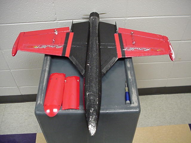

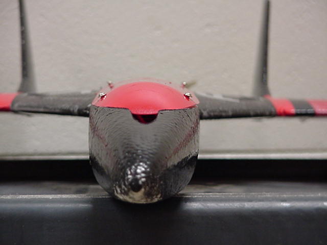

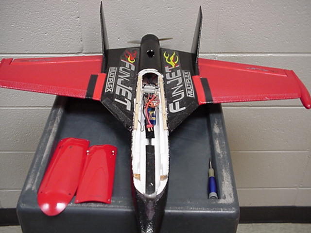

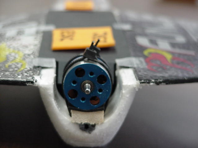

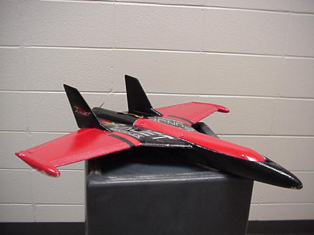

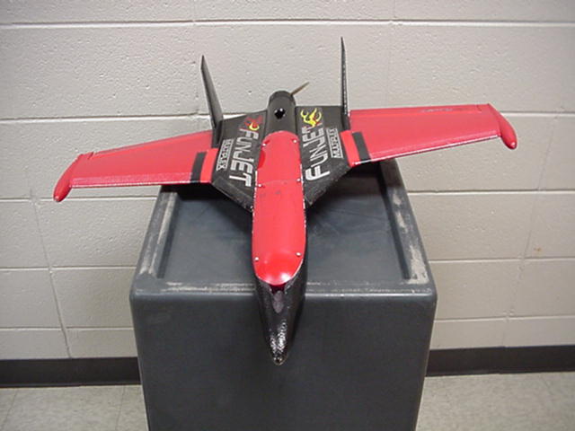

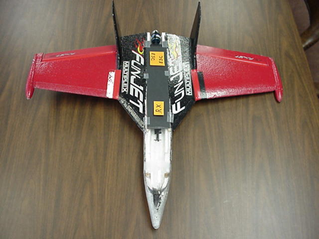

The Multiplex Funjet is a great plane. It is not a plane for a beginner. Highly mod. this plane can reach speeds of over 120mph.
I was looking for a current picture of my FJ before the ESC failed on Sunday 2-3-08 resulting in a crash and trashing the plane. I know I have them somewhere....................
Any way this thread is to get the FJ on RC universe.
If you fly a Parkzone Stryker and want to go from NASCAR to INDY Series then your at the right place!!!
I'm just a basic flyer-- I don't have a lot of electronic gizmos-I don't even have a Watts up meter - due to cost and income-but I do have access to them-the point is you can fly fast and fairly cheap if you work at it.
I usually have to purchase all parts over a long period of time, but I enjoy the RC world a lot.
I also like to improve on current planes by reducing the drag and upgrade the response by added balsa elevons and Carbon fiber to stiffen the plane.
The now wrecked FJ weighed in at 21 oz with 2100 ma batt. ready to toss
EX. The FJ that crashed 2-3-08 had been moded with a new and lower canopy and deck-balsa elevons and carbon fiber rods.
Powered by a e-flite 6 series 2700 kv motor ---apc 6x5.5 cut down to 5.5x5.5---3 cell polyquest 2100 ma.
Another guy at the field had a "stock" FJ with a mega 3000kv-- pylon racer prop-- same cell count- and we were just about even in speed-so I know I made a diff. in the plane.
OK your asking why did it crash -- I didn't put a large enough ESC in the plane -I over amped the ESC--won't make that mistake again. I knew it when I set up the plane-but the race was on and I couldn't let my plane be shown up--big ego!!!
Ok so this is the place for all FunJet pilots to share the secerts so all can have a great and FAST plane

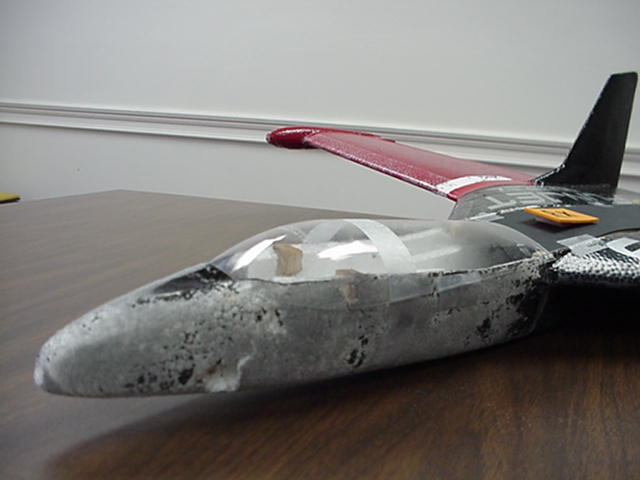

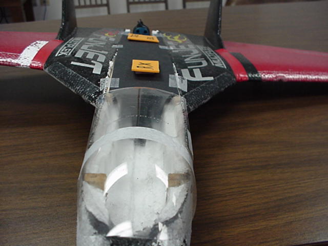

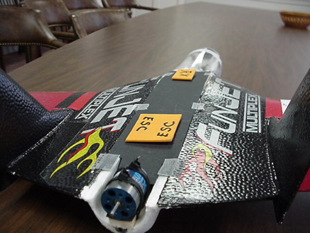

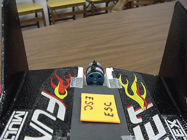

I think I recall your name on some of the older Stryker posts. I'm working on streamlined FJ. On the current one I replaced the stock canopy with a (don't LOL) with one made from a 3 liter soda bottle--cut to fit over the space. Added 6 places to screw it down. Much less drag. I even have enough space to run a 4c 3300ma batt.--drops right in. I have used this on all Strykers for the last 1 1/2 yrs.
I guess I'm going to post current photos as I can't find the old ones.
The new one, as I'm working the details out on paper, will have exposed motor like the Stryker. I have read many people discuss the shape of the motor mount area on thr FJ, as blocking air for the prop to bite. I agree. So I will try to solve this and hopefully made a faster plane with the same motor.
The goal(s)
1- increase speed by reducing drag
2-increase flying time at WOT
3- be able to change motors in under 3 minutes
4-increase the OMG factor by 2
Stay tuned it's going to be a different FJ

This is what I'm "remodeling too."
1- overall view and layout
2-side view
3-new exposed motor to improve cooling and prop bite=more speed- better performance
4-rear-ESC & motor--I will mount esc under the deck and place a scoop above to ram air around esc and exit in front of the motor
6-canopy -looking back--little larger canopy to start--for bigger batts.--may reduce height after testing
Have to patch the hole on the left front nose as the CF pushed thru. Will install 2 smaller tubes down the sides to replace the old 1 which I removed ( shattered)
I didn't look that close when it crashed as I was really mad and myself and the equipment. Now it's not really bad. Oh the rx wire was cut ??? I have to fix that --no problem there.
2-side view
