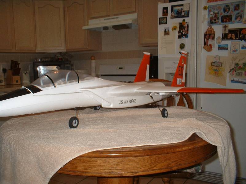

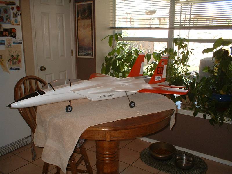

There is some hacking of foam to deal with( as far as the retracts go). The wiring quickly becomes a nightmare. My overall impression is its way overpriced for what it is. The test hop went smooth. It sounded like it was going mach 2 but its just kind of flew nothing spectacular as far as I was concerned. While it handled well its just not worth they money. I built it for the LHS they had a buyer but it just didn't live up to expectations in my book. Mike

Thanks for posting the great photos! I plan on building mine with out the retracts We don't have a paved runway.
