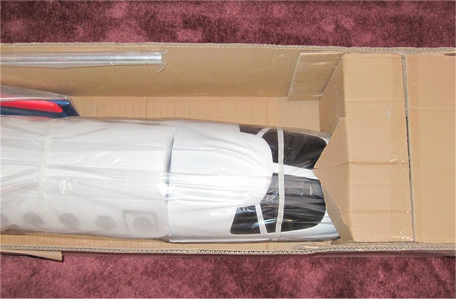

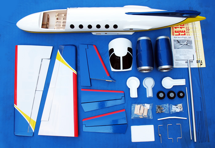

The Hero 100 Cessna 550 comes in a big 68" long box. The plane looked well packed and the parts were either wrapped in foam or plastic. I split the box photos in half to get a closer look. The fuselage spans the entire length of the box.
I'll get some parts photos after everything is unwrapped.

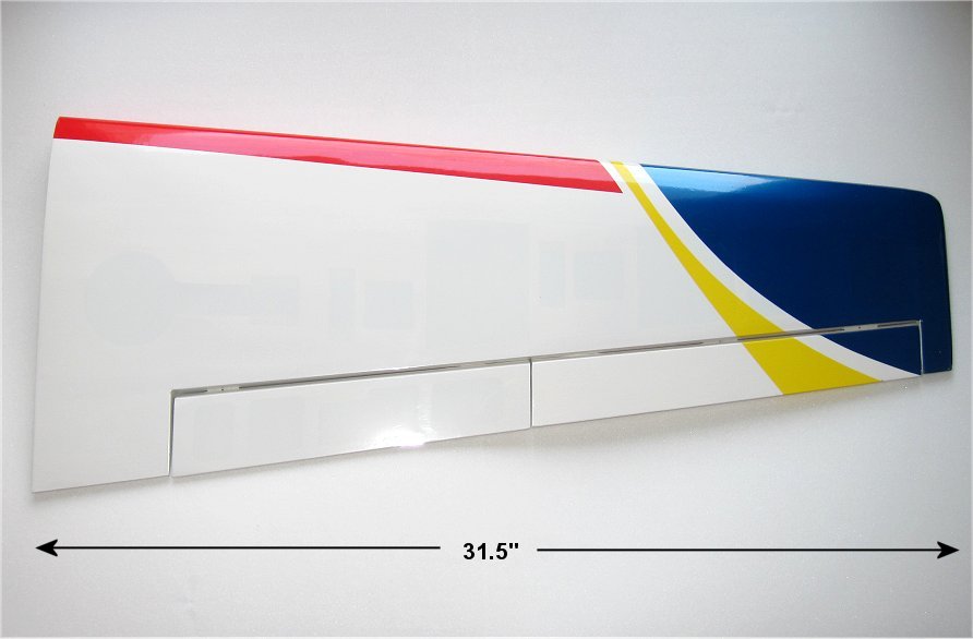

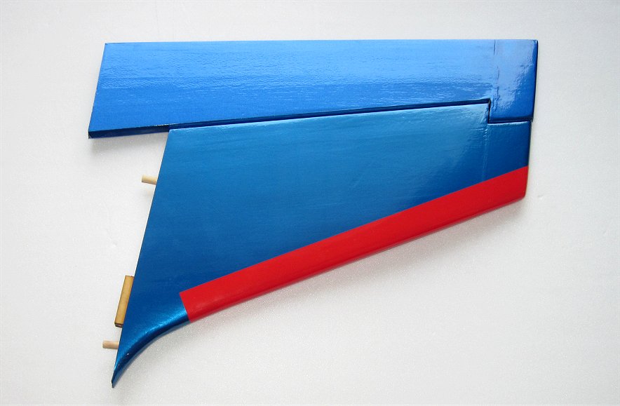

The wing halves measured 31.5" each. All the wood surfaces were perfectly covered without a single wrinkle. This was unexpected quality from a $200 ARF.
The control surfaces, like ailerons, rudder, and elevator halves, all had the hinge material inserted but needed to be glued with thin CA.

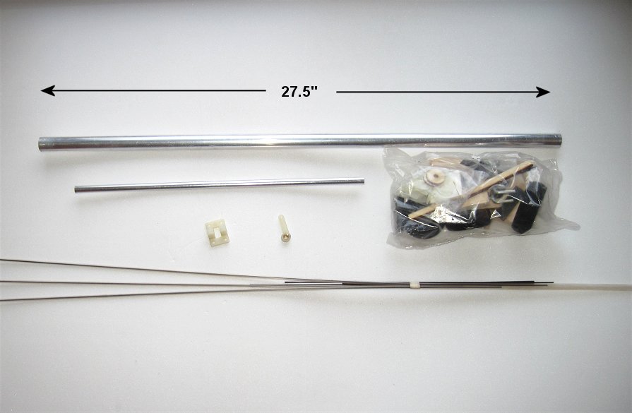

The main wing tube measured 27.5" across. I discovered another addition to the Version 2 kit, there were three wheel retract bays instead of two on the original kit.

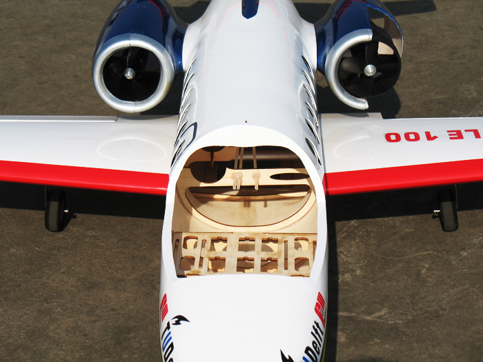

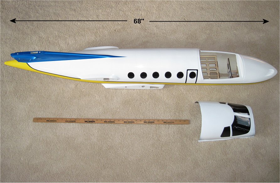

The large one-piece fuselage was 68" long. Most of the colors and decals had been applied. I will, however, be modifying the color scheme to match the full-scale Cessna Citation that this design mostly mimics. More to come on the scale-up process.

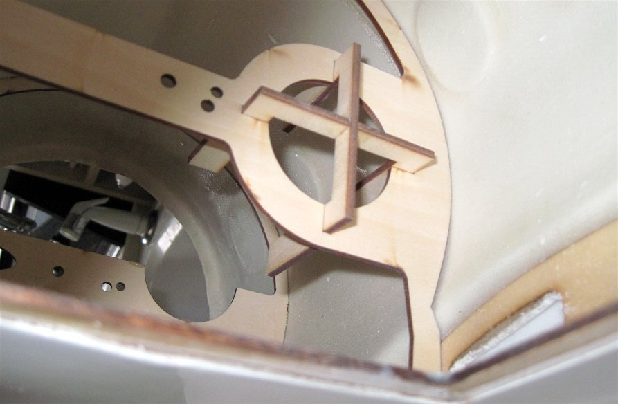

The formers, retract bays, and servo/battery bay appeared to be intact but I recommend doing a full inspection for strength of adhesion to the fiberglass body. I typically use the aerospace grade epoxy called [link=http://www.bvmjets.com/Pages/Catalog/vpoxy.htm]Vpoxy[/link] from BVM Jets to ensure a quality bond between fiberglass and other materials like wood or plastic.
Note the addition of the nose wheel retract cutout and retract bay in the Version 2 kits.
That's a good question.
I hadn't noticed the twist as I was taking photos. I plan to use Spring Air 301 retracts with Robart struts so I may need to make some changes.
I didn't see anything that would work for this model on the Nitro Planes Web site so I'll query John to see what they had in mind.
Thanks.
Thanks.

To finish up the parts photos, we have a decal sheet and a 10-page glossy manual with clear photos. The manual appears to be for Version 1 and shows using a steerable non-retractable nose wheel. This option, along with the wheels, still comes with Version 2 for those that don't build it with retracts. There is no cutout on the bottom of the fuselage in the manual and the canopy section has been crossed out with pen marks.
Overall, I think what you get for only $200 is a great value and I am excited to finally start this project after a 6 month wait. There are certain pitfalls with these lower cost fiberglass models from China but they can easily be overcome with some experience and skill. I'll be detailing some history on the full-scale plane that the Hero 100 was modeled after and reveal my 5000 watt power system and navigation lights that are visible in sunlight.

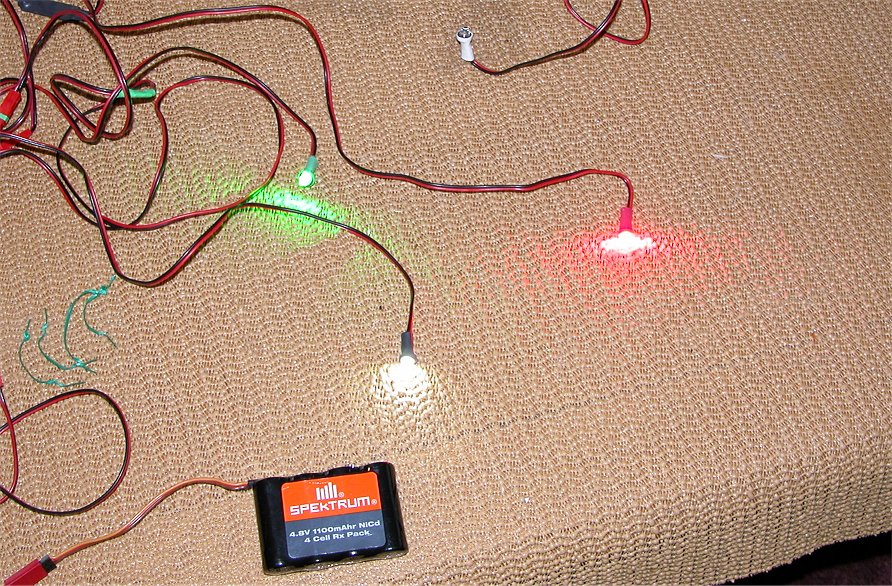

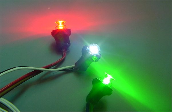

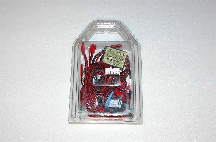

My navigation lights for the Cessna 550 are the EDR-117 LiteSys from [link=http://electrodynam.com/rc/EDR-117/index.shtml]Electro Dynamics[/link]. This plug and play lighting system for scale models uses the ED-SunVis Wide-angle lamps that are visible in sunlight.
I'm using the LiteSys Starter System with Transmitter-controlled switching for $119. It includes the following items.[ul][*] Red and Green Nav Lights[*] Red Beacon or White Strobe (select)[*] 4-way Distributor[*] Landing Light[*] Dual RC Switch
[/ul]
The dual RC Switch can either turn the lights on whenever the receiver hears the transmitter or by a spare channel.

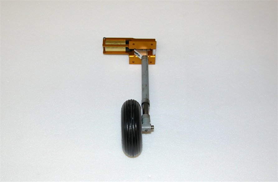

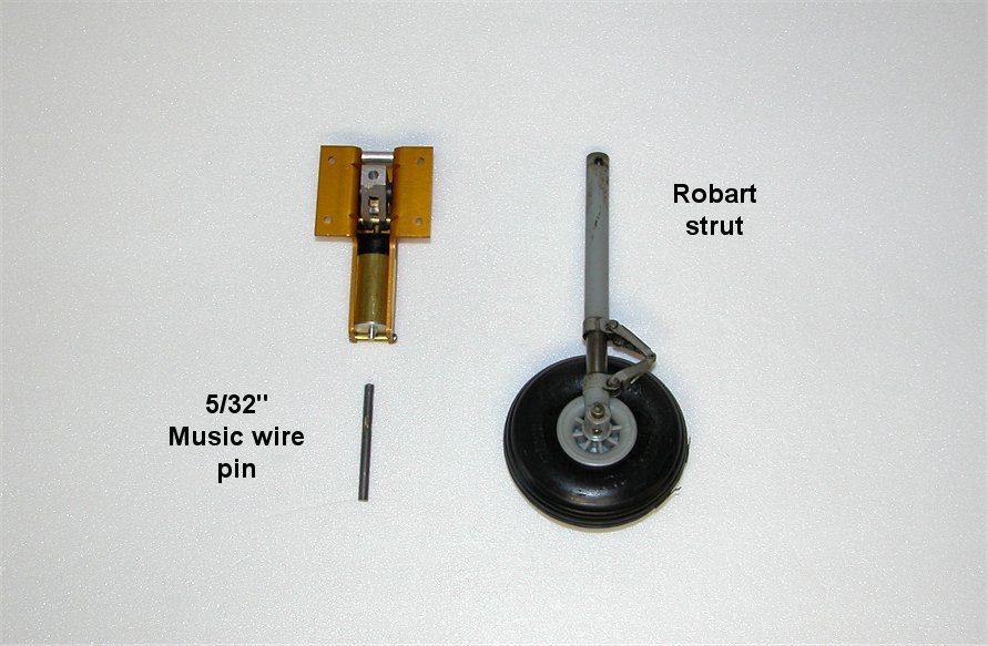

My retract choice is the Spring Air 301 Firewall Retract Set. These retracts use air pressure to go up and spring force to go down. I have successfully used these in the past on my Byron A-4 Skyhawk and feel they offer a good quality value with a great fail-safe mode of operation. If you loose the air pressure, the retracts lock down in the landing position. Carl Rich also proved that these retracts were a good size choice on the Version 1 Cessna. The 301 retracts can handle models up to 15-16lbs.
Instead of using the supplied wire mains, I'm using a pre-enjoyed set of Robart 501 struts with Dubro (275TL) 2-3/4" Treaded Lightweight Wheels. Any strut can be easily added by making your own 5/32" pin with a Dremel tool. The struts not only reduce bounce on landing but enhance the gear appearance by eliminating the skinny wire look.

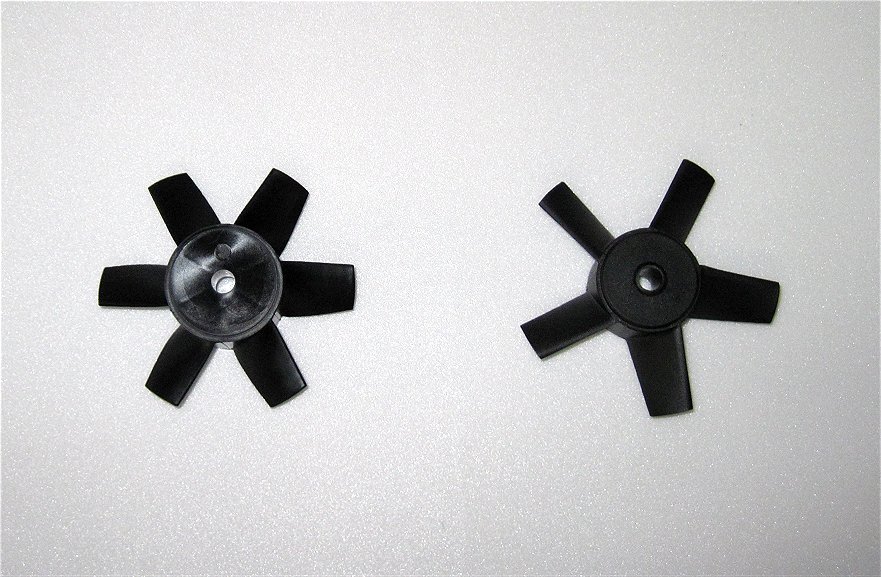

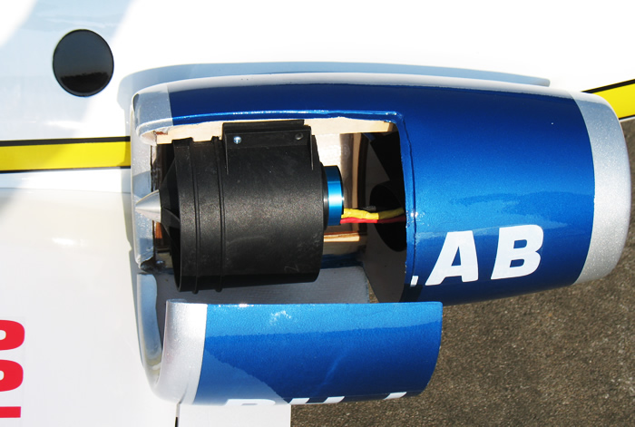

My original plan was to use Wemotec Midi Pro fans. When I received the new RC Lander metal DFs, I was very surprised at the quality of the machining. Further, it fit perfectly into the Hero 100 nacelle. I don't have any measurements on the fan yet so it the loading isn't sufficient then I will swap the rotor with the Midi Pro rotor. RC Lander is making clam shell mounts for these 90mm DFs so it will easily be held onto the platform in the nacelle.
The RC Lander rotor is only 5-blades compared to the Midi Pro 6-blade rotor but it does have a more aggressive pitch so perhaps the loading and thrust may be comparable. The rotor is made from some composite that is very hard and the quality was very high so that I did not see any flaws. I made the following weight measurements.[ul][*] 2-piece fan housing = 3.1oz[*] Rotor, spinner, and adapter = 1.4oz[*] Red tail cone = 1.6oz[/ul]
My power system components will be the following items...times two.[ul][*] Neu 1415/1.5Y inrunner motor[*] Castle Creations ICE 100 ESC[*] RC Lander 90mm DF[*] Two 4s 30C 4000mAh Blue Lipo packs in series
[/ul]

Greg you may want to measure that Landers diameter before you start to swap it, some versions of that fan have a rotor that is only 84mm or so.
Mark,
Here are some photos of the RC Lander 90mm DF using the Wemotec Midi Pro rotor and spinner. The 6-blade Midi Pro rotor is on the left and then mounted in the fan.
The shaft size and adapter screw are the same so it fits right on the Lander adapter. The Midi Pro rotor length is slightly smaller than the Lander rotor length by about 4mm.
So it still looks promising for a reasonable load on 8s with the Neu motor. If not, then the Midi Pros will provide a known 2500 watts per side with great efficiency.

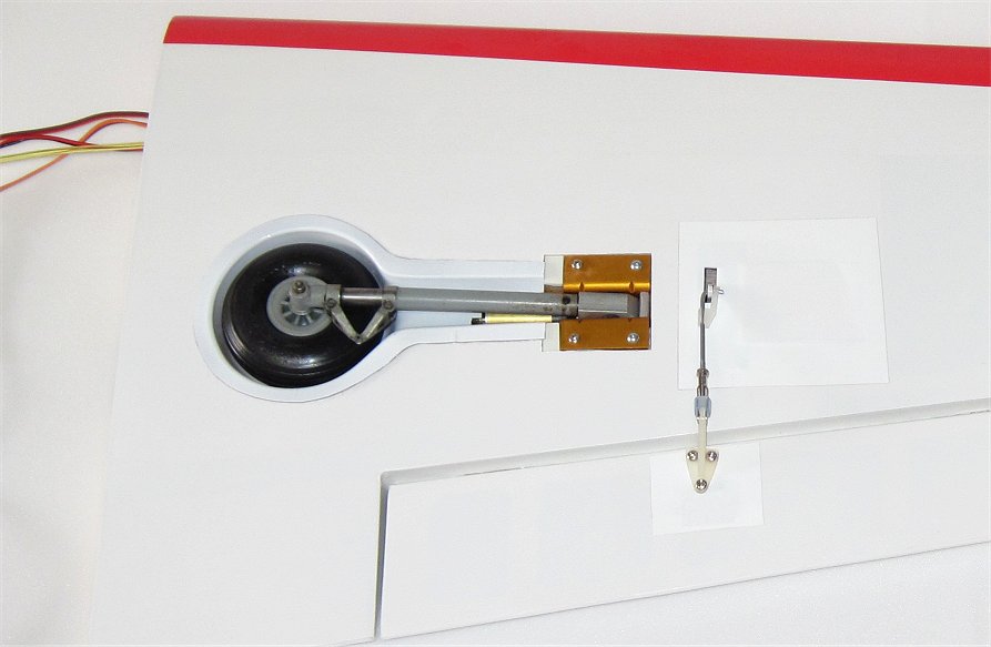

The first step of the assembly is to complete the wings. The Spring Air 301 retract installed easily after first making some minor cut adjustments. I also noticed that with a little modification, you could mount the flap and aileron servos sideways for a cleaner look. I used JR DS821 digital servos because they offer strong torque and great return to center for a reasonable price.
The flap servo mounted sideways after a few cuts with a Dremel tool and a small block of balsa underneath to raise it up flush with the surface. The aileron servo needed a tray running between the two ribs. I used a scrap piece of light plywood. To extend the servo wires, I used JR (JRPA102) 24" Heavy Duty Servo Extensions.
The plug and play navigation light easily mounted on the wing tip after drilling a hole from the end into the long open bay that travels the length of the wing.
By drilling a hole from the wheel well into the main bay that runs the length of the wing, all four lines could exit the normal opening that goes into the fuselage without further modification.
When I looked at the supplied hardware, I knew that I wanted to mount the control horns on the bottom side only for a cleaner look on the top of the wing. The control surfaces were plenty thick so I used the supplied wood screws instead of the intended machine screws that were meant to pass through the control surface. By pre-drilling some pilot holes for the control horns and using some CA, it created a strong hold that could not be seen from the top. I didn't think there was a long enough block in the flap for the outer most screw so I cut an opening in the covering and added a small piece of plywood.
One issue I had with the hardware was that the threaded ends of the aileron and flap control rods were too small for the plastic clevis. I used my own metric control rods from an old bulk pack ([link=http://www.hobby-lobby.com/18_better_rc_metal_clevises_with_11_rods_1042_prd1 .htm]HLH804[/link]) I bought from Hobby Lobby years ago. Since these control rods also came with a metal clevis, I used those instead of the supplied plastic clevis.

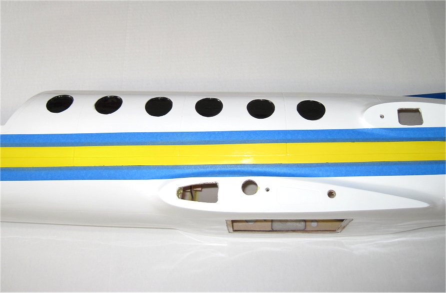

The yellow on the fuselage was re-painted with Valspar Gloss White (102S) Spray Enamel paint. First, the black lines were masked off and then the yellow area was sanded with #220 grit sandpaper. I then taped paper towels over the rest of the fuselage before spraying.
A red line will be painted in the center between the two black lines. The color will be close to the red covering used to eliminate the remaining yellow on the control surfaces.
