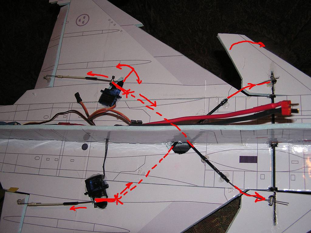

UPDATE!!
I've done it....
Found the proper way to connect 4 moving surfaces with 2 servos. Offcourse the easy way would have been to find the answere to what I was wanting to do by simply doing a search.. Believe me, I did search far and wide... It's realy preety simple, but since I had never done this... I didn't know where to begin. After several attempts and different ways of connecting the canards and still come to the surfaces not working the right way, I found it.
I don't know what people call this set up as I did not get the idea from Google. At this time all I can name it is " The Criss Cross and Under Connection".
My left and right canards are cross linked connected to both Elevons, but instead of being connected straight forward they cross themselves at center and also cross the fuse to the opposite side of aircraft body..
Look at the pictures..
__________________________________________________ _____________________________________
UPDATE!!
I've done it....

Joined: Jan 2008
Posts: 89
From: Houston, TX
Maybe this picture will show just how I have set this up..
I connected the Right elevon to the left canard. Tne right elevon is connected to the bottom of the control surface, using a double arm... I connected the left canards going from the top of the wing at the servo arm.. through the fuse and under the airplane to the bottom of the left canard. The left elevon is connected in the same fasion toi the right canard. When I give full up elevon, both canards also go up..
When I wige full down... both canards also go down.. When I give right bank... the right elevon and the left canard go up and left elevon and right canard go down.. Making this a top in the skies. Making this JAS-39 stop on a dime should be easy... Cobra anyone!!
