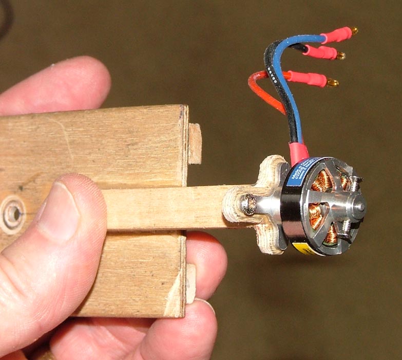

The one thing I haven't been able to figure out is how the prop mounts to the motor???? I'm sure that it will be intuitive once I have them both in my hand but from looking at the pictures of the motor, it seems like something is missing. Is the prop adapter optional - only used if you turn the shaft around as described in some areas? If anyone can provide some info in this regard I would certainly appreciate it.

The motor has a built-in prop saver, and the bearing tube is mounted at the rear.

Thank you Dr. Kiwi. So as I understand it, in the outrunners the whole case is what turns so the prop is centered on the small nub at the front in your picture and is held to the motor by elastic bands wrapped around the screws?

Yes, if you use the prop saver, that's how it works (surgical tube is good for making O-rings). This motor can also be mounted behind a firewall and the prop attached to the exposed shaft using a standard collet adapter. Here is a review with some more pictures and some performance data which might be useful to you: http://www.rcgroups.com/forums/showt...ht=e+flite+250

I've just realized that the E-flite 250 I tested 3yrs ago, and the one which is now available differ in that the "new" one has that exposed shaft sticking out of the bearing tube!
The one I tested could not be mounted behind a firewall.

Actually you are correct, it can be done with the new motor. Apparently you can release the shaft, reverse it and reinstall so that it comes out the front and then use the collet or set screw adapters. I have read more than one horror story on the net though about this going terribly wrong and resulting in a broken motor so I won't be trying that.

Looking at the photo it seems as if you can use a prop adapter on that motor shaft without altering anything.
