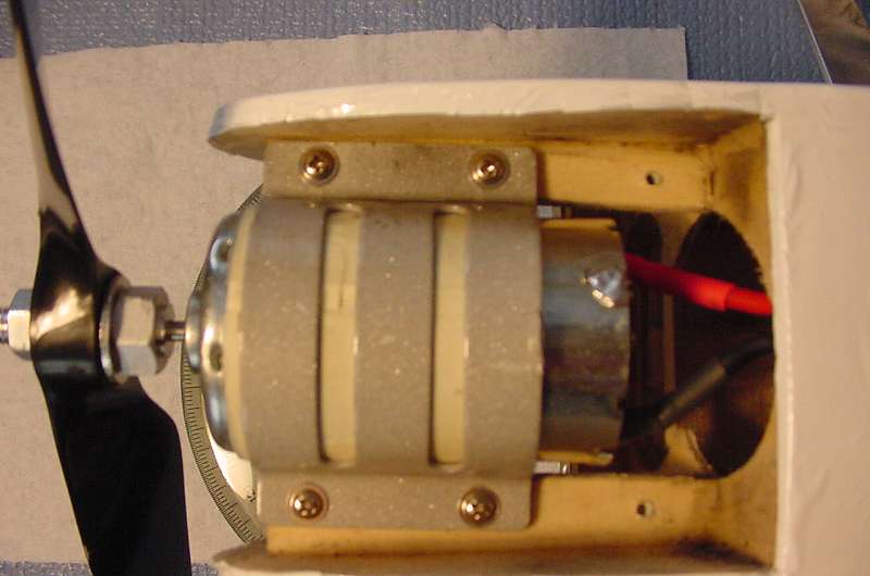

hey guys, i've jusr recently purchased the hobbico superstar ep with ailerons. the first thing i noticed is that the right thrust angle on the engine seems to be alittle too much. but then that is the question what is too much? does anyone have this bird and is it normal to have that much right thrust any info would be greatly appreciated thanks
Hi,
I do have the Superstar Ep (without Ailerons) and there is a noticable amount of right thrust on the motor. I am going to include a photo of mine for guidance. Hope this helps.
Joe
Joe

hi joe,
sure enough your right. my superstar looks exactly the same. i appreciate you sending the photo. i was getting alittle worried there for a minute. i've got the bird ready to fly but haven't had a nice day yet. hopefully this afternoon will be better. thnks again for all the help. aaron

Look at any glow trainer. They all have a signifigant amount of right thrust, as well as down thrust. I believe it's a function of the airplane's design, high-wing, flat-bottom airfoil. It's been my experience that they're more sensitive to changes in throttle than more aerobatic, neutrally stable types.

Hey Firestorm, you are really going to enjoy this plane. This was my first trainer, in fact, my only trainer. I loved it. Get some extra motors from Tower. They are about six to nine dollars each. I went through a few in the beginning. The plane now hangs in my pool room, the ceiling of which, has been turned into a hangigg airport. Still flys beautifully though. The amt of down thrust is normal for this plane.

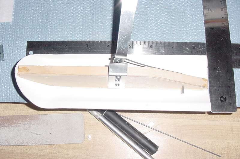

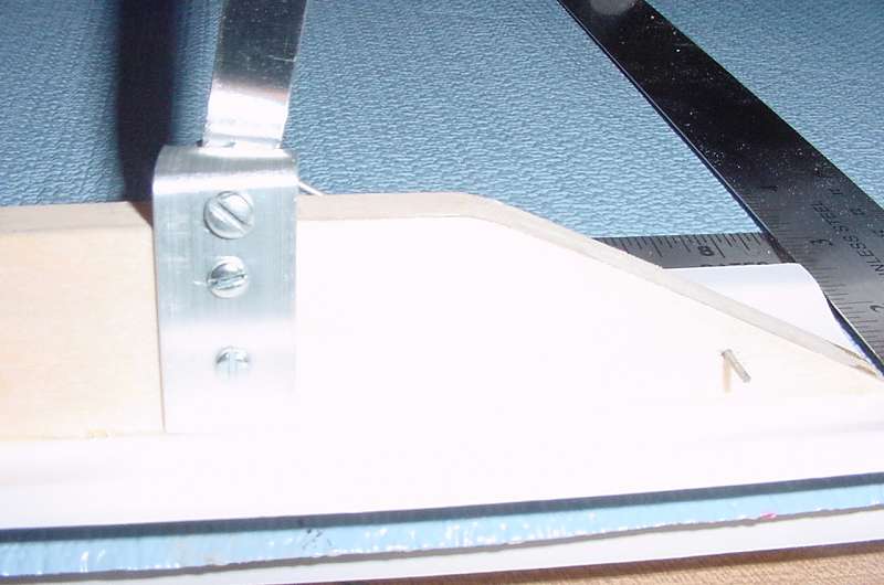

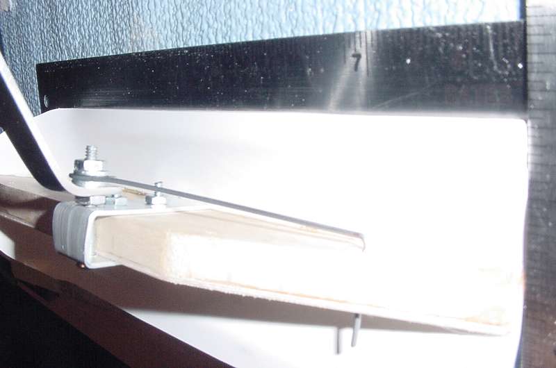

Hi Ten...
Yes, I made them. Piece of PVC gutter downspout with 1/2 inch pine and laminated with 1/16 ply (I used epoxy to secure to PVC). Heat gun helps form the PVC and I put one screw up front to secure it. Bracket is just flat bar aluminum secured with two bolts through the wood and a hole for axle. Spring is music wire with a loop on the axle screw end tightened with extra nuts to keep the skis at the correct angle. I had every intention of painting them but never got to it! Rather fly! I have probably made 100 landings with them this winter with no problems. Make some. Winter flying is really fun.
I bought a set of Dubro skis for another plane but didn't really care for the spring system. Looks like they have changed from ones I've seen at the field.
Joe
Joe
