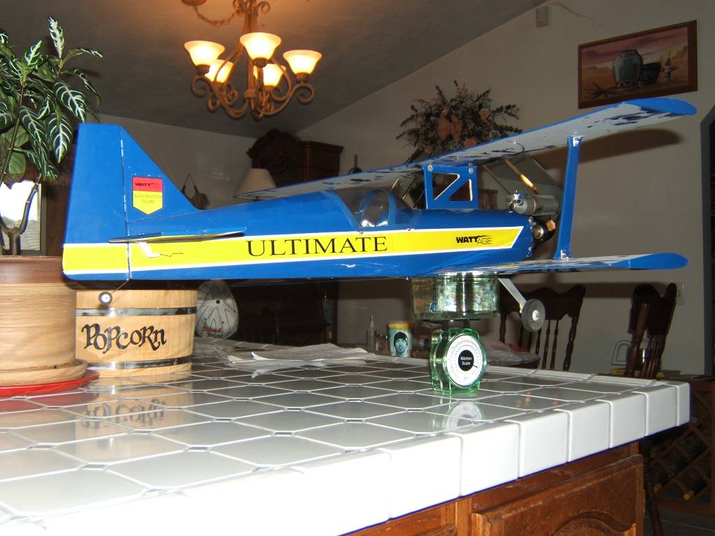

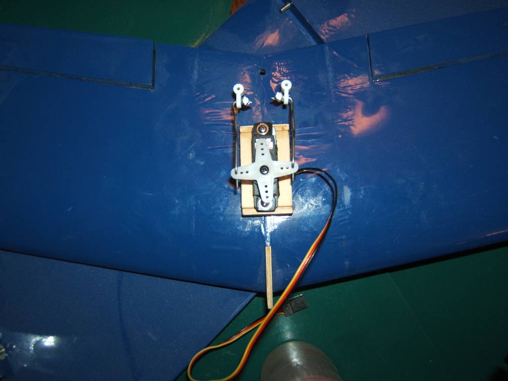

I had posted a while ago that I was going to convert a wattage ultimate biplane from electric to glow. well I finally got started on the swap. here's some pictures of the progress so far. I resest the firewall to try and off set the added weight of the glow engine that I'm using. as of now the fuse weighs 7oz with the motor mount installed.

progress report:
all electrical is in, tank is plumbed an mounted.
total weight of airframe - engine is 1lb 4.5oz
the donor engine is an old OS .25 FP, it weighed out at 10oz complete.
I figure the total flying weight full of fuel will be just over 2lbs.

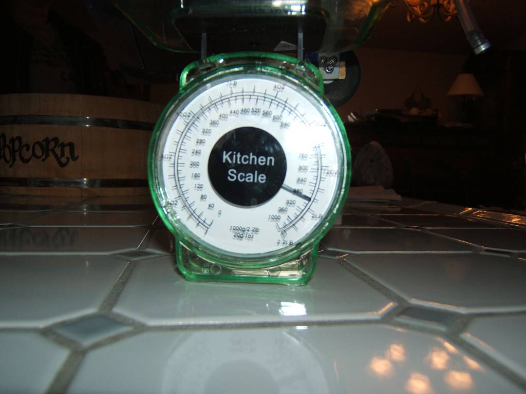

and here it is, the complete plane. as you can see sitting on the scale it weighs 1lb 15oz RTF.
I may make up a cowl for it but I haven't fully decided yet. what do you think?
