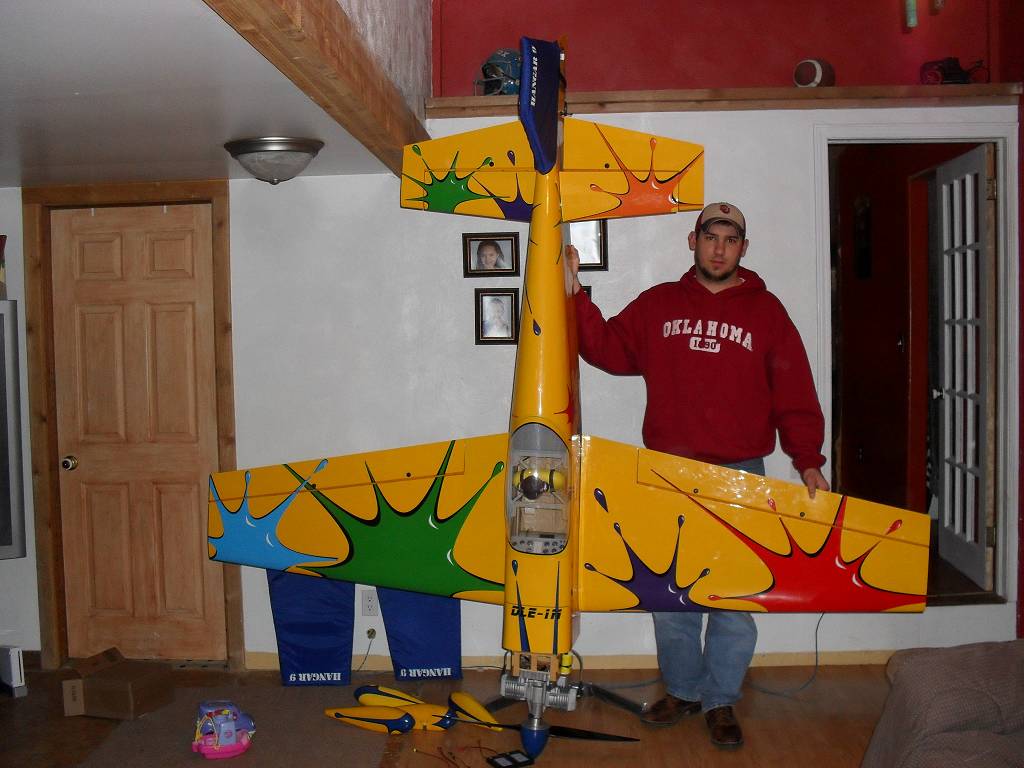

it was a gms .32
I pulled it off an extra and put on a power ten and all around it was better.. and it would have never left the ground with a .15
but tomatoes-potatoes yall sound like you got this under control
good luck on the build
I'll go back to what I know big planes
