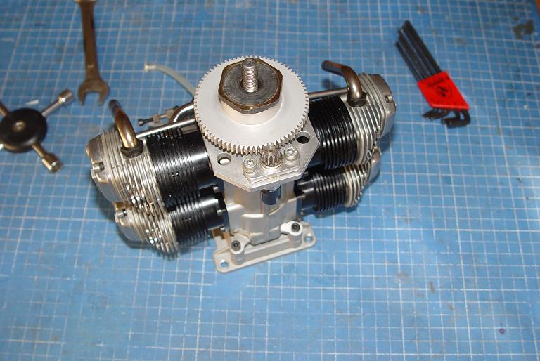

TODAY I RECEIVED A PEGASUS 320 4 CYLINDER, 4 STROKES ENGINES TO CONVERT TO GAS ENGINE
THE OWNER TOLD ME THE ENGINE HAS A LOT OF PROBLEMS WITH NITRO, EVERYTYIME ONE CYLINDER ORE MORE STOPS BURNING, IS EXPENSIVE IN FUEL. IT IS USING 20% NITRO AND OS F GLOWS, LETS START CORNVERSION
WISH ME LUCK PLEASE

You will need to make a distributor
OR use 2 separate twin ignitions, 2 sensors and 1 magnet. You basically treat the engine as 2 separate 2 cylinder flat twins

Yah Im am thinkin in it it, i think os easy use 2 twin ignitions I need to fit 2 sensosr oposite 180º If I use one ignition with distribuitor will operate it at very high frecuence, 4 times more faster than in a single enginefor example if I run the engine at 3600 rpom a single engine ignition will operate at 60hz but for the 4 cylinder will operate at 240 hz (switching )
now I have removed the main gar of the starter was very hard to began the convertion I damage the starter gear but I will not use it again

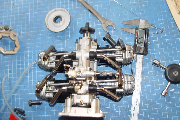

pic

Yes I started to make the trimming ring for the hub when I finished it I see a problem
I see the prop hub is not the original, the person who attach the gear for remote starter install a new one. The problem with it is that I think is very small diameter to support the prop, is god for a 10 inch prop but not for a 20 inch diameter prop
Ordering it will take more than one week to Mexico so I decide make a new one i finished it minutes ago, take me no more than hour making it Here are the pics hope you enjoy it

Could one use four magnets and sensors. Space the magnets and sensors lengthwise on the hub enough so they do not trigger the the other sensors? Yes it would fire on the exhaust stroke but that does not matter. If two opposed cylinders fire a the same time you would only need two sensors? If my scheme is workable you would only need one ignition with four HT leads.
Nice job on the hub. I need to get a nurling tool like that.

I will use 2 sensorrs one magnet and 2 twin gnitions
the sensorr are fitted 180ª oposite
one sensor is for the fron cilindes and the other is for the hback cylinders
I almost finished the sensor suport
regards
Max

sensor mount finished
almost ready to run

I make a time collar I use one magnet only Im aligning at 180º exactly opposite the sensors.
