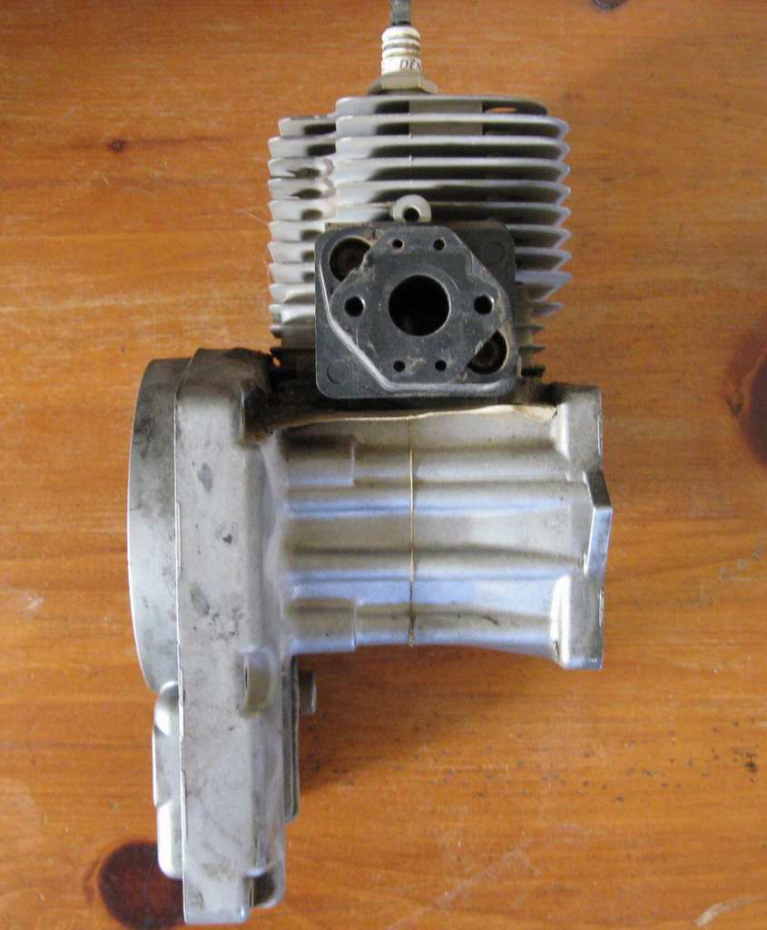

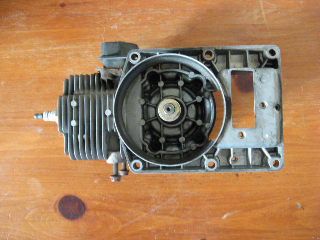

Look for the Echo engines from leaf blowers. I have both a 58cc and a 65cc that came from blowers. They run around 220 bucks from the small engine parts suppliers online. The engines from the blowers are very easy to convert, unlike some of the large chain saw engines.
I will try to post a pic of one after I get my daughter off to school this morning.

Here's some pics of a 65cc Echo shown exactly as it comes out of the back pack blowers. Easy conversion...

Hmmmm, don't ask me why they came out so big. I had trouble uploading them, and then when they did, they came out huge like that...
Anyway, here are a couple of pics of a 58cc Echo. It also came out of a backpack blower, and was an easy conversion. I did this one for Gas/Glow, and it turned a 20 x 10 prop at over 7000 rpms.
Good used backpack blowers are hard to find, but you can buy a new engine from the suppliers for about 220 bucks as I mentioned before. Less than an hours work cutting and dressing it up, add an ignition and a prop hub, an after market muffler, and you're done....

Thanks Av8tor, that's what I'm looking for. I'd like to use the mag. instead of ignition. Yours looks great! I'll look for Echo.........
