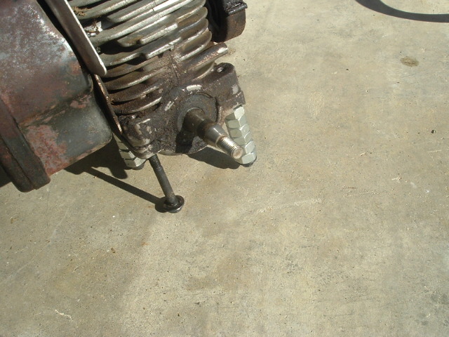

I just got from my son in-law, what I think is a Poulan 33, from a Wood Shark saw. We have already done the preliminary cut down but I'm at a loss on how to mount the engine to a plane. I plan on retaining the magneto but the coil tower mounts to the bottom of the engine and is kinda bulky.
Does anybody have some ideas to share.

If you are going to retain the coil, it will need to be in the same place as it is currently.
We need some pictures of the mounting possiblities?

I was wondering what sovent can I use to clean the engine that won't damage the rubber crank seal.

Old 01-08-2011 | 09:43 AM
Rcpilot's Avatar
My Feedback: (78)
Posts: 7,808
Received 9 Likes on 8 Posts
Default RE: POULAN Engines
ORIGINAL: Twin Star
Gas and an old tooth brush.
