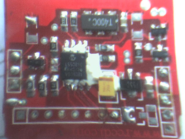

Hi
<span lang="en" id="result_box" class="short_text"><span class="hps">Look what</span> <span class="hps">you get</span> <span class="hps">for your money.</span></span>
<span lang="en" id="result_box"><span class="hps">I</span> <span class="hps">disassemble</span> <span class="hps">a</span> <span class="hps">RCexl</span> <span class="hps">original</span> <span class="hps">ignition.</span>
<span class="hps">I will show</span> <span class="hps">circuit.</span>
<span class="hps">I will show</span> <span class="hps">the original</span> <span class="hps">ignition</span> <span class="hps">curve.</span></span>

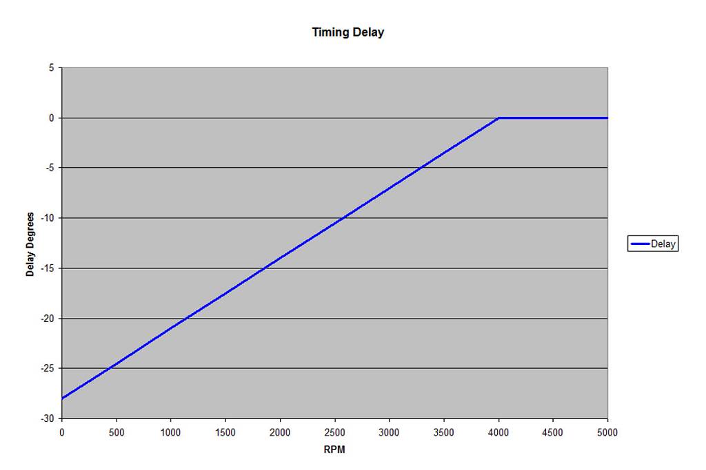

Hi Nyemi, is there any way to show us how to change the Excel sheet with Excel 2007?
I just installed it and am having problems figuring it out. We need an easy to use setup.
John
John

#48
Joined: Feb 2010
Posts: 133
From: szarvas, HUNGARY
<div><![if gte mso 9]><xml><w:latentstyles latentstylecount="267" defpriority="99" defqformat="false" defsemihidden="true" defunhidewhenused="true" deflockedstate="false"><w:lsdexception name="Normal" qformat="true" unhidewhenused="false" semihidden="false" priority="0" locked="false"></w:lsdexception><w:lsdexception name="heading 1" qformat="true" unhidewhenused="false" semihidden="false" priority="9" locked="false"></w:lsdexception><w:lsdexception name="heading 2" qformat="true" priority="9" locked="false"></w:lsdexception><w:lsdexception name="heading 3" qformat="true" priority="9" locked="false"></w:lsdexception><w:lsdexception name="heading 4" qformat="true" priority="9" locked="false"></w:lsdexception><w:lsdexception name="heading 5" qformat="true" priority="9" locked="false"></w:lsdexception><w:lsdexception name="heading 6" qformat="true" priority="9" locked="false"></w:lsdexception><w:lsdexception name="heading 7" qformat="true" priority="9" locked="false"></w:lsdexception><w:lsdexception name="heading 8" qformat="true" priority="9" locked="false"></w:lsdexception><w:lsdexception name="heading 9" qformat="true" priority="9" locked="false"></w:lsdexception><w:lsdexception name="toc 1" priority="39" locked="false"></w:lsdexception><w:lsdexception name="toc 2" priority="39" locked="false"></w:lsdexception><w:lsdexception name="toc 3" priority="39" locked="false"></w:lsdexception><w:lsdexception name="toc 4" priority="39" locked="false"></w:lsdexception><w:lsdexception name="toc 5" priority="39" locked="false"></w:lsdexception><w:lsdexception name="toc 6" priority="39" locked="false"></w:lsdexception><w:lsdexception name="toc 7" priority="39" locked="false"></w:lsdexception><w:lsdexception name="toc 8" priority="39" locked="false"></w:lsdexception><w:lsdexception name="toc 9" priority="39" locked="false"></w:lsdexception><w:lsdexception name="caption" qformat="true" priority="35" locked="false"></w:lsdexception><w:lsdexception name="Title" qformat="true" unhidewhenused="false" semihidden="false" priority="10" locked="false"></w:lsdexception><w:lsdexception name="Default Paragraph Font" priority="1" locked="false"></w:lsdexception><w:lsdexception name="Subtitle" qformat="true" unhidewhenused="false" semihidden="false" priority="11" locked="false"></w:lsdexception><w:lsdexception name="Strong" qformat="true" unhidewhenused="false" semihidden="false" priority="22" locked="false"></w:lsdexception><w:lsdexception name="Emphasis" qformat="true" unhidewhenused="false" semihidden="false" priority="20" locked="false"></w:lsdexception><w:lsdexception name="Table Grid" unhidewhenused="false" semihidden="false" priority="59" locked="false"></w:lsdexception><w:lsdexception name="Placeholder Text" unhidewhenused="false" locked="false"></w:lsdexception><w:lsdexception name="No Spacing" qformat="true" unhidewhenused="false" semihidden="false" priority="1" locked="false"></w:lsdexception><w:lsdexception name="Light Shading" unhidewhenused="false" semihidden="false" priority="60" locked="false"></w:lsdexception><w:lsdexception name="Light List" unhidewhenused="false" semihidden="false" priority="61" locked="false"></w:lsdexception><w:lsdexception name="Light Grid" unhidewhenused="false" semihidden="false" priority="62" locked="false"></w:lsdexception><w:lsdexception name="Medium Shading 1" unhidewhenused="false" semihidden="false" priority="63" locked="false"></w:lsdexception><w:lsdexception name="Medium Shading 2" unhidewhenused="false" semihidden="false" priority="64" locked="false"></w:lsdexception><w:lsdexception name="Medium List 1" unhidewhenused="false" semihidden="false" priority="65" locked="false"></w:lsdexception><w:lsdexception name="Medium List 2" unhidewhenused="false" semihidden="false" priority="66" locked="false"></w:lsdexception><w:lsdexception name="Medium Grid 1" unhidewhenused="false" semihidden="false" priority="67" locked="false"></w:lsdexception><w:lsdexception name="Medium Grid 2" unhidewhenused="false" semihidden="false" priority="68" locked="false"></w:lsdexception><w:lsdexception name="Medium Grid 3" unhidewhenused="false" semihidden="false" priority="69" locked="false"></w:lsdexception><w:lsdexception name="Dark List" unhidewhenused="false" semihidden="false" priority="70" locked="false"></w:lsdexception><w:lsdexception name="Colorful Shading" unhidewhenused="false" semihidden="false" priority="71" locked="false"></w:lsdexception><w:lsdexception name="Colorful List" unhidewhenused="false" semihidden="false" priority="72" locked="false"></w:lsdexception><w:lsdexception name="Colorful Grid" unhidewhenused="false" semihidden="false" priority="73" locked="false"></w:lsdexception><w:lsdexception name="Light Shading Accent 1" unhidewhenused="false" semihidden="false" priority="60" locked="false"></w:lsdexception><w:lsdexception name="Light List Accent 1" unhidewhenused="false" semihidden="false" priority="61" locked="false"></w:lsdexception><w:lsdexception name="Light Grid Accent 1" unhidewhenused="false" semihidden="false" priority="62" locked="false"></w:lsdexception><w:lsdexception name="Medium Shading 1 Accent 1" unhidewhenused="false" semihidden="false" priority="63" locked="false"></w:lsdexception><w:lsdexception name="Medium Shading 2 Accent 1" unhidewhenused="false" semihidden="false" priority="64" locked="false"></w:lsdexception><w:lsdexception name="Medium List 1 Accent 1" unhidewhenused="false" semihidden="false" priority="65" locked="false"></w:lsdexception><w:lsdexception name="Revision" unhidewhenused="false" locked="false"></w:lsdexception><w:lsdexception name="List Paragraph" qformat="true" unhidewhenused="false" semihidden="false" priority="34" locked="false"></w:lsdexception><w:lsdexception name="Quote" qformat="true" unhidewhenused="false" semihidden="false" priority="29" locked="false"></w:lsdexception><w:lsdexception name="Intense Quote" qformat="true" unhidewhenused="false" semihidden="false" priority="30" locked="false"></w:lsdexception><w:lsdexception name="Medium List 2 Accent 1" unhidewhenused="false" semihidden="false" priority="66" locked="false"></w:lsdexception><w:lsdexception name="Medium Grid 1 Accent 1" unhidewhenused="false" semihidden="false" priority="67" locked="false"></w:lsdexception><w:lsdexception name="Medium Grid 2 Accent 1" unhidewhenused="false" semihidden="false" priority="68" locked="false"></w:lsdexception><w:lsdexception name="Medium Grid 3 Accent 1" unhidewhenused="false" semihidden="false" priority="69" locked="false"></w:lsdexception><w:lsdexception name="Dark List Accent 1" unhidewhenused="false" semihidden="false" priority="70" locked="false"></w:lsdexception><w:lsdexception name="Colorful Shading Accent 1" unhidewhenused="false" semihidden="false" priority="71" locked="false"></w:lsdexception><w:lsdexception name="Colorful List Accent 1" unhidewhenused="false" semihidden="false" priority="72" locked="false"></w:lsdexception><w:lsdexception name="Colorful Grid Accent 1" unhidewhenused="false" semihidden="false" priority="73" locked="false"></w:lsdexception><w:lsdexception name="Light Shading Accent 2" unhidewhenused="false" semihidden="false" priority="60" locked="false"></w:lsdexception><w:lsdexception name="Light List Accent 2" unhidewhenused="false" semihidden="false" priority="61" locked="false"></w:lsdexception><w:lsdexception name="Light Grid Accent 2" unhidewhenused="false" semihidden="false" priority="62" locked="false"></w:lsdexception><w:lsdexception name="Medium Shading 1 Accent 2" unhidewhenused="false" semihidden="false" priority="63" locked="false"></w:lsdexception><w:lsdexception name="Medium Shading 2 Accent 2" unhidewhenused="false" semihidden="false" priority="64" locked="false"></w:lsdexception><w:lsdexception name="Medium List 1 Accent 2" unhidewhenused="false" semihidden="false" priority="65" locked="false"></w:lsdexception><w:lsdexception name="Medium List 2 Accent 2" unhidewhenused="false" semihidden="false" priority="66" locked="false"></w:lsdexception><w:lsdexception name="Medium Grid 1 Accent 2" unhidewhenused="false" semihidden="false" priority="67" locked="false"></w:lsdexception><w:lsdexception name="Medium Grid 2 Accent 2" unhidewhenused="false" semihidden="false" priority="68" locked="false"></w:lsdexception><w:lsdexception name="Medium Grid 3 Accent 2" unhidewhenused="false" semihidden="false" priority="69" locked="false"></w:lsdexception><w:lsdexception name="Dark List Accent 2" unhidewhenused="false" semihidden="false" priority="70" locked="false"></w:lsdexception><w:lsdexception name="Colorful Shading Accent 2" unhidewhenused="false" semihidden="false" priority="71" locked="false"></w:lsdexception><w:lsdexception name="Colorful List Accent 2" unhidewhenused="false" semihidden="false" priority="72" locked="false"></w:lsdexception><w:lsdexception name="Colorful Grid Accent 2" unhidewhenused="false" semihidden="false" priority="73" locked="false"></w:lsdexception><w:lsdexception name="Light Shading Accent 3" unhidewhenused="false" semihidden="false" priority="60" locked="false"></w:lsdexception><w:lsdexception name="Light List Accent 3" unhidewhenused="false" semihidden="false" priority="61" locked="false"></w:lsdexception><w:lsdexception name="Light Grid Accent 3" unhidewhenused="false" semihidden="false" priority="62" locked="false"></w:lsdexception><w:lsdexception name="Medium Shading 1 Accent 3" unhidewhenused="false" semihidden="false" priority="63" locked="false"></w:lsdexception><w:lsdexception name="Medium Shading 2 Accent 3" unhidewhenused="false" semihidden="false" priority="64" locked="false"></w:lsdexception><w:lsdexception name="Medium List 1 Accent 3" unhidewhenused="false" semihidden="false" priority="65" locked="false"></w:lsdexception><w:lsdexception name="Medium List 2 Accent 3" unhidewhenused="false" semihidden="false" priority="66" locked="false"></w:lsdexception><w:lsdexception name="Medium Grid 1 Accent 3" unhidewhenused="false" semihidden="false" priority="67" locked="false"></w:lsdexception><w:lsdexception name="Medium Grid 2 Accent 3" unhidewhenused="false" semihidden="false" priority="68" locked="false"></w:lsdexception><w:lsdexception name="Medium Grid 3 Accent 3" unhidewhenused="false" semihidden="false" priority="69" locked="false"></w:lsdexception><w:lsdexception name="Dark List Accent 3" unhidewhenused="false" semihidden="false" priority="70" locked="false"></w:lsdexception><w:lsdexception name="Colorful Shading Accent 3" unhidewhenused="false" semihidden="false" priority="71" locked="false"></w:lsdexception><w:lsdexception name="Colorful List Accent 3" unhidewhenused="false" semihidden="false" priority="72" locked="false"></w:lsdexception><w:lsdexception name="Colorful Grid Accent 3" unhidewhenused="false" semihidden="false" priority="73" locked="false"></w:lsdexception><w:lsdexception name="Light Shading Accent 4" unhidewhenused="false" semihidden="false" priority="60" locked="false"></w:lsdexception><w:lsdexception name="Light List Accent 4" unhidewhenused="false" semihidden="false" priority="61" locked="false"></w:lsdexception><w:lsdexception name="Light Grid Accent 4" unhidewhenused="false" semihidden="false" priority="62" locked="false"></w:lsdexception><w:lsdexception name="Medium Shading 1 Accent 4" unhidewhenused="false" semihidden="false" priority="63" locked="false"></w:lsdexception><w:lsdexception name="Medium Shading 2 Accent 4" unhidewhenused="false" semihidden="false" priority="64" locked="false"></w:lsdexception><w:lsdexception name="Medium List 1 Accent 4" unhidewhenused="false" semihidden="false" priority="65" locked="false"></w:lsdexception><w:lsdexception name="Medium List 2 Accent 4" unhidewhenused="false" semihidden="false" priority="66" locked="false"></w:lsdexception><w:lsdexception name="Medium Grid 1 Accent 4" unhidewhenused="false" semihidden="false" priority="67" locked="false"></w:lsdexception><w:lsdexception name="Medium Grid 2 Accent 4" unhidewhenused="false" semihidden="false" priority="68" locked="false"></w:lsdexception><w:lsdexception name="Medium Grid 3 Accent 4" unhidewhenused="false" semihidden="false" priority="69" locked="false"></w:lsdexception><w:lsdexception name="Dark List Accent 4" unhidewhenused="false" semihidden="false" priority="70" locked="false"></w:lsdexception><w:lsdexception name="Colorful Shading Accent 4" unhidewhenused="false" semihidden="false" priority="71" locked="false"></w:lsdexception><w:lsdexception name="Colorful List Accent 4" unhidewhenused="false" semihidden="false" priority="72" locked="false"></w:lsdexception><w:lsdexception name="Colorful Grid Accent 4" unhidewhenused="false" semihidden="false" priority="73" locked="false"></w:lsdexception><w:lsdexception name="Light Shading Accent 5" unhidewhenused="false" semihidden="false" priority="60" locked="false"></w:lsdexception><w:lsdexception name="Light List Accent 5" unhidewhenused="false" semihidden="false" priority="61" locked="false"></w:lsdexception><w:lsdexception name="Light Grid Accent 5" unhidewhenused="false" semihidden="false" priority="62" locked="false"></w:lsdexception><w:lsdexception name="Medium Shading 1 Accent 5" unhidewhenused="false" semihidden="false" priority="63" locked="false"></w:lsdexception><w:lsdexception name="Medium Shading 2 Accent 5" unhidewhenused="false" semihidden="false" priority="64" locked="false"></w:lsdexception><w:lsdexception name="Medium List 1 Accent 5" unhidewhenused="false" semihidden="false" priority="65" locked="false"></w:lsdexception><w:lsdexception name="Medium List 2 Accent 5" unhidewhenused="false" semihidden="false" priority="66" locked="false"></w:lsdexception><w:lsdexception name="Medium Grid 1 Accent 5" unhidewhenused="false" semihidden="false" priority="67" locked="false"></w:lsdexception><w:lsdexception name="Medium Grid 2 Accent 5" unhidewhenused="false" semihidden="false" priority="68" locked="false"></w:lsdexception><w:lsdexception name="Medium Grid 3 Accent 5" unhidewhenused="false" semihidden="false" priority="69" locked="false"></w:lsdexception><w:lsdexception name="Dark List Accent 5" unhidewhenused="false" semihidden="false" priority="70" locked="false"></w:lsdexception><w:lsdexception name="Colorful Shading Accent 5" unhidewhenused="false" semihidden="false" priority="71" locked="false"></w:lsdexception><w:lsdexception name="Colorful List Accent 5" unhidewhenused="false" semihidden="false" priority="72" locked="false"></w:lsdexception><w:lsdexception name="Colorful Grid Accent 5" unhidewhenused="false" semihidden="false" priority="73" locked="false"></w:lsdexception><w:lsdexception name="Light Shading Accent 6" unhidewhenused="false" semihidden="false" priority="60" locked="false"></w:lsdexception><w:lsdexception name="Light List Accent 6" unhidewhenused="false" semihidden="false" priority="61" locked="false"></w:lsdexception><w:lsdexception name="Light Grid Accent 6" unhidewhenused="false" semihidden="false" priority="62" locked="false"></w:lsdexception><w:lsdexception name="Medium Shading 1 Accent 6" unhidewhenused="false" semihidden="false" priority="63" locked="false"></w:lsdexception><w:lsdexception name="Medium Shading 2 Accent 6" unhidewhenused="false" semihidden="false" priority="64" locked="false"></w:lsdexception><w:lsdexception name="Medium List 1 Accent 6" unhidewhenused="false" semihidden="false" priority="65" locked="false"></w:lsdexception><w:lsdexception name="Medium List 2 Accent 6" unhidewhenused="false" semihidden="false" priority="66" locked="false"></w:lsdexception><w:lsdexception name="Medium Grid 1 Accent 6" unhidewhenused="false" semihidden="false" priority="67" locked="false"></w:lsdexception><w:lsdexception name="Medium Grid 2 Accent 6" unhidewhenused="false" semihidden="false" priority="68" locked="false"></w:lsdexception><w:lsdexception name="Medium Grid 3 Accent 6" unhidewhenused="false" semihidden="false" priority="69" locked="false"></w:lsdexception><w:lsdexception name="Dark List Accent 6" unhidewhenused="false" semihidden="false" priority="70" locked="false"></w:lsdexception><w:lsdexception name="Colorful Shading Accent 6" unhidewhenused="false" semihidden="false" priority="71" locked="false"></w:lsdexception><w:lsdexception name="Colorful List Accent 6" unhidewhenused="false" semihidden="false" priority="72" locked="false"></w:lsdexception><w:lsdexception name="Colorful Grid Accent 6" unhidewhenused="false" semihidden="false" priority="73" locked="false"></w:lsdexception><w:lsdexception name="Subtle Emphasis" qformat="true" unhidewhenused="false" semihidden="false" priority="19" locked="false"></w:lsdexception><w:lsdexception name="Intense Emphasis" qformat="true" unhidewhenused="false" semihidden="false" priority="21" locked="false"></w:lsdexception><w:lsdexception name="Subtle Reference" qformat="true" unhidewhenused="false" semihidden="false" priority="31" locked="false"></w:lsdexception><w:lsdexception name="Intense Reference" qformat="true" unhidewhenused="false" semihidden="false" priority="32" locked="false"></w:lsdexception><w:lsdexception name="Book Title" qformat="true" unhidewhenused="false" semihidden="false" priority="33" locked="false"></w:lsdexception><w:lsdexception name="Bibliography" priority="37" locked="false"></w:lsdexception><w:lsdexception name="TOC Heading" qformat="true" priority="39" locked="false"></w:lsdexception></w:latentstyles></xml><![endif]><![if gte mso 10]><style type="text/css"> Style Definitions */table.MsoNormalTable{mso-style-name:"Normál táblázat";mso-tstyle-rowband-size:0;mso-tstyle-colband-size:0;mso-style-noshow:yes;mso-style-priority:99;mso-style-qformat:yes;mso-style-parent:"";mso-padding-alt:0cm 5.4pt 0cm 5.4pt;mso-para-margin-top:0cm;mso-para-margin-right:0cm;mso-para-margin-bottom:10.0pt;mso-para-margin-left:0cm;line-height:115%;mso-pagination:widow-orphan;font-size:11.0pt;font-family:"Calibri","sans-serif";mso-ascii-font-family:Calibri;mso-ascii-theme-font:minor-latin;mso-fareast-font-family:"Times New Roman";mso-fareast-theme-font:minor-fareast;mso-hansi-font-family:Calibri;mso-hansi-theme-font:minor-latin;}</style><![endif]></div><![if gte mso 9]><xml><w:latentstyles deflockedstate="false" defunhidewhenused="true" defsemihidden="true" defqformat="false" defpriority="99" latentstylecount="267"><w:lsdexception locked="false" priority="0" semihidden="false" unhidewhenused="false" qformat="true" name="Normal"></w:lsdexception><w:lsdexception locked="false" priority="9" semihidden="false" unhidewhenused="false" qformat="true" name="heading 1"></w:lsdexception><w:lsdexception locked="false" priority="9" qformat="true" name="heading 2"></w:lsdexception><w:lsdexception locked="false" priority="9" qformat="true" name="heading 3"></w:lsdexception><w:lsdexception locked="false" priority="9" qformat="true" name="heading 4"></w:lsdexception><w:lsdexception locked="false" priority="9" qformat="true" name="heading 5"></w:lsdexception><w:lsdexception locked="false" priority="9" qformat="true" name="heading 6"></w:lsdexception><w:lsdexception locked="false" priority="9" qformat="true" name="heading 7"></w:lsdexception><w:lsdexception locked="false" priority="9" qformat="true" name="heading 8"></w:lsdexception><w:lsdexception locked="false" priority="9" qformat="true" name="heading 9"></w:lsdexception><w:lsdexception locked="false" priority="39" name="toc 1"></w:lsdexception><w:lsdexception locked="false" priority="39" name="toc 2"></w:lsdexception><w:lsdexception locked="false" priority="39" name="toc 3"></w:lsdexception><w:lsdexception locked="false" priority="39" name="toc 4"></w:lsdexception><w:lsdexception locked="false" priority="39" name="toc 5"></w:lsdexception><w:lsdexception locked="false" priority="39" name="toc 6"></w:lsdexception><w:lsdexception locked="false" priority="39" name="toc 7"></w:lsdexception><w:lsdexception locked="false" priority="39" name="toc 8"></w:lsdexception><w:lsdexception locked="false" priority="39" name="toc 9"></w:lsdexception><w:lsdexception locked="false" priority="35" qformat="true" name="caption"></w:lsdexception><w:lsdexception locked="false" priority="10" semihidden="false" unhidewhenused="false" qformat="true" name="Title"></w:lsdexception><w:lsdexception locked="false" priority="1" name="Default Paragraph Font"></w:lsdexception><w:lsdexception locked="false" priority="11" semihidden="false" unhidewhenused="false" qformat="true" name="Subtitle"></w:lsdexception><w:lsdexception locked="false" priority="22" semihidden="false" unhidewhenused="false" qformat="true" name="Strong"></w:lsdexception><w:lsdexception locked="false" priority="20" semihidden="false" unhidewhenused="false" qformat="true" name="Emphasis"></w:lsdexception><w:lsdexception locked="false" priority="59" semihidden="false" unhidewhenused="false" name="Table Grid"></w:lsdexception><w:lsdexception locked="false" unhidewhenused="false" name="Placeholder Text"></w:lsdexception><w:lsdexception locked="false" priority="1" semihidden="false" unhidewhenused="false" qformat="true" name="No Spacing"></w:lsdexception><w:lsdexception locked="false" priority="60" semihidden="false" unhidewhenused="false" name="Light Shading"></w:lsdexception><w:lsdexception locked="false" priority="61" semihidden="false" unhidewhenused="false" name="Light List"></w:lsdexception><w:lsdexception locked="false" priority="62" semihidden="false" unhidewhenused="false" name="Light Grid"></w:lsdexception><w:lsdexception locked="false" priority="63" semihidden="false" unhidewhenused="false" name="Medium Shading 1"></w:lsdexception><w:lsdexception locked="false" priority="64" semihidden="false" unhidewhenused="false" name="Medium Shading 2"></w:lsdexception><w:lsdexception locked="false" priority="65" semihidden="false" unhidewhenused="false" name="Medium List 1"></w:lsdexception><w:lsdexception locked="false" priority="66" semihidden="false" unhidewhenused="false" name="Medium List 2"></w:lsdexception><w:lsdexception locked="false" priority="67" semihidden="false" unhidewhenused="false" name="Medium Grid 1"></w:lsdexception><w:lsdexception locked="false" priority="68" semihidden="false" unhidewhenused="false" name="Medium Grid 2"></w:lsdexception><w:lsdexception locked="false" priority="69" semihidden="false" unhidewhenused="false" name="Medium Grid 3"></w:lsdexception><w:lsdexception locked="false" priority="70" semihidden="false" unhidewhenused="false" name="Dark List"></w:lsdexception><w:lsdexception locked="false" priority="71" semihidden="false" unhidewhenused="false" name="Colorful Shading"></w:lsdexception><w:lsdexception locked="false" priority="72" semihidden="false" unhidewhenused="false" name="Colorful List"></w:lsdexception><w:lsdexception locked="false" priority="73" semihidden="false" unhidewhenused="false" name="Colorful Grid"></w:lsdexception><w:lsdexception locked="false" priority="60" semihidden="false" unhidewhenused="false" name="Light Shading Accent 1"></w:lsdexception><w:lsdexception locked="false" priority="61" semihidden="false" unhidewhenused="false" name="Light List Accent 1"></w:lsdexception><w:lsdexception locked="false" priority="62" semihidden="false" unhidewhenused="false" name="Light Grid Accent 1"></w:lsdexception><w:lsdexception locked="false" priority="63" semihidden="false" unhidewhenused="false" name="Medium Shading 1 Accent 1"></w:lsdexception><w:lsdexception locked="false" priority="64" semihidden="false" unhidewhenused="false" name="Medium Shading 2 Accent 1"></w:lsdexception><w:lsdexception locked="false" priority="65" semihidden="false" unhidewhenused="false" name="Medium List 1 Accent 1"></w:lsdexception><w:lsdexception locked="false" unhidewhenused="false" name="Revision"></w:lsdexception><w:lsdexception locked="false" priority="34" semihidden="false" unhidewhenused="false" qformat="true" name="List Paragraph"></w:lsdexception><w:lsdexception locked="false" priority="29" semihidden="false" unhidewhenused="false" qformat="true" name="Quote"></w:lsdexception><w:lsdexception locked="false" priority="30" semihidden="false" unhidewhenused="false" qformat="true" name="Intense Quote"></w:lsdexception><w:lsdexception locked="false" priority="66" semihidden="false" unhidewhenused="false" name="Medium List 2 Accent 1"></w:lsdexception><w:lsdexception locked="false" priority="67" semihidden="false" unhidewhenused="false" name="Medium Grid 1 Accent 1"></w:lsdexception><w:lsdexception locked="false" priority="68" semihidden="false" unhidewhenused="false" name="Medium Grid 2 Accent 1"></w:lsdexception><w:lsdexception locked="false" priority="69" semihidden="false" unhidewhenused="false" name="Medium Grid 3 Accent 1"></w:lsdexception><w:lsdexception locked="false" priority="70" semihidden="false" unhidewhenused="false" name="Dark List Accent 1"></w:lsdexception><w:lsdexception locked="false" priority="71" semihidden="false" unhidewhenused="false" name="Colorful Shading Accent 1"></w:lsdexception><w:lsdexception locked="false" priority="72" semihidden="false" unhidewhenused="false" name="Colorful List Accent 1"></w:lsdexception><w:lsdexception locked="false" priority="73" semihidden="false" unhidewhenused="false" name="Colorful Grid Accent 1"></w:lsdexception><w:lsdexception locked="false" priority="60" semihidden="false" unhidewhenused="false" name="Light Shading Accent 2"></w:lsdexception><w:lsdexception locked="false" priority="61" semihidden="false" unhidewhenused="false" name="Light List Accent 2"></w:lsdexception><w:lsdexception locked="false" priority="62" semihidden="false" unhidewhenused="false" name="Light Grid Accent 2"></w:lsdexception><w:lsdexception locked="false" priority="63" semihidden="false" unhidewhenused="false" name="Medium Shading 1 Accent 2"></w:lsdexception><w:lsdexception locked="false" priority="64" semihidden="false" unhidewhenused="false" name="Medium Shading 2 Accent 2"></w:lsdexception><w:lsdexception locked="false" priority="65" semihidden="false" unhidewhenused="false" name="Medium List 1 Accent 2"></w:lsdexception><w:lsdexception locked="false" priority="66" semihidden="false" unhidewhenused="false" name="Medium List 2 Accent 2"></w:lsdexception><w:lsdexception locked="false" priority="67" semihidden="false" unhidewhenused="false" name="Medium Grid 1 Accent 2"></w:lsdexception><w:lsdexception locked="false" priority="68" semihidden="false" unhidewhenused="false" name="Medium Grid 2 Accent 2"></w:lsdexception><w:lsdexception locked="false" priority="69" semihidden="false" unhidewhenused="false" name="Medium Grid 3 Accent 2"></w:lsdexception><w:lsdexception locked="false" priority="70" semihidden="false" unhidewhenused="false" name="Dark List Accent 2"></w:lsdexception><w:lsdexception locked="false" priority="71" semihidden="false" unhidewhenused="false" name="Colorful Shading Accent 2"></w:lsdexception><w:lsdexception locked="false" priority="72" semihidden="false" unhidewhenused="false" name="Colorful List Accent 2"></w:lsdexception><w:lsdexception locked="false" priority="73" semihidden="false" unhidewhenused="false" name="Colorful Grid Accent 2"></w:lsdexception><w:lsdexception locked="false" priority="60" semihidden="false" unhidewhenused="false" name="Light Shading Accent 3"></w:lsdexception><w:lsdexception locked="false" priority="61" semihidden="false" unhidewhenused="false" name="Light List Accent 3"></w:lsdexception><w:lsdexception locked="false" priority="62" semihidden="false" unhidewhenused="false" name="Light Grid Accent 3"></w:lsdexception><w:lsdexception locked="false" priority="63" semihidden="false" unhidewhenused="false" name="Medium Shading 1 Accent 3"></w:lsdexception><w:lsdexception locked="false" priority="64" semihidden="false" unhidewhenused="false" name="Medium Shading 2 Accent 3"></w:lsdexception><w:lsdexception locked="false" priority="65" semihidden="false" unhidewhenused="false" name="Medium List 1 Accent 3"></w:lsdexception><w:lsdexception locked="false" priority="66" semihidden="false" unhidewhenused="false" name="Medium List 2 Accent 3"></w:lsdexception><w:lsdexception locked="false" priority="67" semihidden="false" unhidewhenused="false" name="Medium Grid 1 Accent 3"></w:lsdexception><w:lsdexception locked="false" priority="68" semihidden="false" unhidewhenused="false" name="Medium Grid 2 Accent 3"></w:lsdexception><w:lsdexception locked="false" priority="69" semihidden="false" unhidewhenused="false" name="Medium Grid 3 Accent 3"></w:lsdexception><w:lsdexception locked="false" priority="70" semihidden="false" unhidewhenused="false" name="Dark List Accent 3"></w:lsdexception><w:lsdexception locked="false" priority="71" semihidden="false" unhidewhenused="false" name="Colorful Shading Accent 3"></w:lsdexception><w:lsdexception locked="false" priority="72" semihidden="false" unhidewhenused="false" name="Colorful List Accent 3"></w:lsdexception><w:lsdexception locked="false" priority="73" semihidden="false" unhidewhenused="false" name="Colorful Grid Accent 3"></w:lsdexception><w:lsdexception locked="false" priority="60" semihidden="false" unhidewhenused="false" name="Light Shading Accent 4"></w:lsdexception><w:lsdexception locked="false" priority="61" semihidden="false" unhidewhenused="false" name="Light List Accent 4"></w:lsdexception><w:lsdexception locked="false" priority="62" semihidden="false" unhidewhenused="false" name="Light Grid Accent 4"></w:lsdexception><w:lsdexception locked="false" priority="63" semihidden="false" unhidewhenused="false" name="Medium Shading 1 Accent 4"></w:lsdexception><w:lsdexception locked="false" priority="64" semihidden="false" unhidewhenused="false" name="Medium Shading 2 Accent 4"></w:lsdexception><w:lsdexception locked="false" priority="65" semihidden="false" unhidewhenused="false" name="Medium List 1 Accent 4"></w:lsdexception><w:lsdexception locked="false" priority="66" semihidden="false" unhidewhenused="false" name="Medium List 2 Accent 4"></w:lsdexception><w:lsdexception locked="false" priority="67" semihidden="false" unhidewhenused="false" name="Medium Grid 1 Accent 4"></w:lsdexception><w:lsdexception locked="false" priority="68" semihidden="false" unhidewhenused="false" name="Medium Grid 2 Accent 4"></w:lsdexception><w:lsdexception locked="false" priority="69" semihidden="false" unhidewhenused="false" name="Medium Grid 3 Accent 4"></w:lsdexception><w:lsdexception locked="false" priority="70" semihidden="false" unhidewhenused="false" name="Dark List Accent 4"></w:lsdexception><w:lsdexception locked="false" priority="71" semihidden="false" unhidewhenused="false" name="Colorful Shading Accent 4"></w:lsdexception><w:lsdexception locked="false" priority="72" semihidden="false" unhidewhenused="false" name="Colorful List Accent 4"></w:lsdexception><w:lsdexception locked="false" priority="73" semihidden="false" unhidewhenused="false" name="Colorful Grid Accent 4"></w:lsdexception><w:lsdexception locked="false" priority="60" semihidden="false" unhidewhenused="false" name="Light Shading Accent 5"></w:lsdexception><w:lsdexception locked="false" priority="61" semihidden="false" unhidewhenused="false" name="Light List Accent 5"></w:lsdexception><w:lsdexception locked="false" priority="62" semihidden="false" unhidewhenused="false" name="Light Grid Accent 5"></w:lsdexception><w:lsdexception locked="false" priority="63" semihidden="false" unhidewhenused="false" name="Medium Shading 1 Accent 5"></w:lsdexception><w:lsdexception locked="false" priority="64" semihidden="false" unhidewhenused="false" name="Medium Shading 2 Accent 5"></w:lsdexception><w:lsdexception locked="false" priority="65" semihidden="false" unhidewhenused="false" name="Medium List 1 Accent 5"></w:lsdexception><w:lsdexception locked="false" priority="66" semihidden="false" unhidewhenused="false" name="Medium List 2 Accent 5"></w:lsdexception><w:lsdexception locked="false" priority="67" semihidden="false" unhidewhenused="false" name="Medium Grid 1 Accent 5"></w:lsdexception><w:lsdexception locked="false" priority="68" semihidden="false" unhidewhenused="false" name="Medium Grid 2 Accent 5"></w:lsdexception><w:lsdexception locked="false" priority="69" semihidden="false" unhidewhenused="false" name="Medium Grid 3 Accent 5"></w:lsdexception><w:lsdexception locked="false" priority="70" semihidden="false" unhidewhenused="false" name="Dark List Accent 5"></w:lsdexception><w:lsdexception locked="false" priority="71" semihidden="false" unhidewhenused="false" name="Colorful Shading Accent 5"></w:lsdexception><w:lsdexception locked="false" priority="72" semihidden="false" unhidewhenused="false" name="Colorful List Accent 5"></w:lsdexception><w:lsdexception locked="false" priority="73" semihidden="false" unhidewhenused="false" name="Colorful Grid Accent 5"></w:lsdexception><w:lsdexception locked="false" priority="60" semihidden="false" unhidewhenused="false" name="Light Shading Accent 6"></w:lsdexception><w:lsdexception locked="false" priority="61" semihidden="false" unhidewhenused="false" name="Light List Accent 6"></w:lsdexception><w:lsdexception locked="false" priority="62" semihidden="false" unhidewhenused="false" name="Light Grid Accent 6"></w:lsdexception><w:lsdexception locked="false" priority="63" semihidden="false" unhidewhenused="false" name="Medium Shading 1 Accent 6"></w:lsdexception><w:lsdexception locked="false" priority="64" semihidden="false" unhidewhenused="false" name="Medium Shading 2 Accent 6"></w:lsdexception><w:lsdexception locked="false" priority="65" semihidden="false" unhidewhenused="false" name="Medium List 1 Accent 6"></w:lsdexception><w:lsdexception locked="false" priority="66" semihidden="false" unhidewhenused="false" name="Medium List 2 Accent 6"></w:lsdexception><w:lsdexception locked="false" priority="67" semihidden="false" unhidewhenused="false" name="Medium Grid 1 Accent 6"></w:lsdexception><w:lsdexception locked="false" priority="68" semihidden="false" unhidewhenused="false" name="Medium Grid 2 Accent 6"></w:lsdexception><w:lsdexception locked="false" priority="69" semihidden="false" unhidewhenused="false" name="Medium Grid 3 Accent 6"></w:lsdexception><w:lsdexception locked="false" priority="70" semihidden="false" unhidewhenused="false" name="Dark List Accent 6"></w:lsdexception><w:lsdexception locked="false" priority="71" semihidden="false" unhidewhenused="false" name="Colorful Shading Accent 6"></w:lsdexception><w:lsdexception locked="false" priority="72" semihidden="false" unhidewhenused="false" name="Colorful List Accent 6"></w:lsdexception><w:lsdexception locked="false" priority="73" semihidden="false" unhidewhenused="false" name="Colorful Grid Accent 6"></w:lsdexception><w:lsdexception locked="false" priority="19" semihidden="false" unhidewhenused="false" qformat="true" name="Subtle Emphasis"></w:lsdexception><w:lsdexception locked="false" priority="21" semihidden="false" unhidewhenused="false" qformat="true" name="Intense Emphasis"></w:lsdexception><w:lsdexception locked="false" priority="31" semihidden="false" unhidewhenused="false" qformat="true" name="Subtle Reference"></w:lsdexception><w:lsdexception locked="false" priority="32" semihidden="false" unhidewhenused="false" qformat="true" name="Intense Reference"></w:lsdexception><w:lsdexception locked="false" priority="33" semihidden="false" unhidewhenused="false" qformat="true" name="Book Title"></w:lsdexception><w:lsdexception locked="false" priority="37" name="Bibliography"></w:lsdexception><w:lsdexception locked="false" priority="39" qformat="true" name="TOC Heading"></w:lsdexception></w:latentstyles></xml><![endif]><![if gte mso 10]><style type="text/css"> Style Definitions */table.MsoNormalTable{mso-style-name:"Normál táblázat";mso-tstyle-rowband-size:0;mso-tstyle-colband-size:0;mso-style-noshow:yes;mso-style-priority:99;mso-style-qformat:yes;mso-style-parent:"";mso-padding-alt:0cm 5.4pt 0cm 5.4pt;mso-para-margin-top:0cm;mso-para-margin-right:0cm;mso-para-margin-bottom:10.0pt;mso-para-margin-left:0cm;line-height:115%;mso-pagination:widow-orphan;font-size:11.0pt;font-family:"Calibri","sans-serif";mso-ascii-font-family:Calibri;mso-ascii-theme-font:minor-latin;mso-fareast-font-family:"Times New Roman";mso-fareast-theme-font:minor-fareast;mso-hansi-font-family:Calibri;mso-hansi-theme-font:minor-latin;}</style><![endif]><p class="MsoNormal">Hi CDI gr8flyer55.
Yes.
I will soon show phases, with pictures.
The phases are described:
1.Enter your ignition curve green lane.( Excel= E4E259 line).
2.Optimize 'RETLW value "(Excel = K1).
It is that "ASM RETLW value (hex)" (Excel = NO4 - NO259) line.
Do not be a "00FF" greater.(1 table value register=8 bit=00FFmax value).
3.Take ASM file.
4.Copy into 'RETLW ASM value (hex) "(Excel = NO4 - NO259 line).
5.Modify "RETLW value " ASM. "NOP" number, reducing or increasing.
Example:
0.019mS=19uS=16NOP (In the present case, ASM file).
0.023mS=23uS=20NOP.
0.015mS=15uS=12NOP.
6.Modify "ASM 458-917 RPM delay value " ASM "NOP" number, reducing or increasing.
The blue line, "1" value.(Excel=I260—I515).
Example:
0.018mS=18uS=12NOP (In the present case, ASM file).
0.023mS=23uS=17NOP.
0.015mS=15uS=9NOP .
7. Enter the output time "dwell". In the present case, ASM file:1296uS .
8. Enter the RPM limiter value.
The EXCEL P4 - P81 line and the C4 - C81 help. In the present case, ASM file:9973RPM=C27—P27.
9. Create HEX file using compiler.
