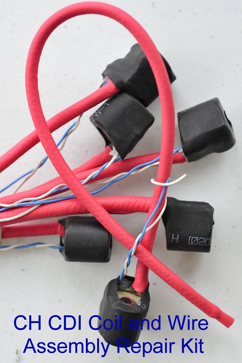

If you want , I can send you coils,and CH HV boad to be able to test as a real deal.
In my opinion and that is just mine is to get read of the LED. keep it simple. If you need to time the engine...use a dedicated device or use the ignition to get the spark
at the desired angle BTDC.

@ Adrian, are your sparkcoils the same I mention into the link a few pages ago ?
I have also buy a very small grey ignition coil from Roy (S/S Machine & Engineering) but this coil didn't work at high rpm.
It quit at 6 or 8,000 rpm and didn't start again without switching off the power.

They look the same to me we can buy into the Netherlands.
http://heetgasmodelbouw.ridders.nu/W...kst_engels.htm
After buying the device you have to isolate it otherwise the you distroy the coil.
I think I have given the coil from Roy away, I can't find him anymore.

The coil in the pictures above looks a lot like the one John sent me. His coil is already potted in epoxy and seems to throw some very long killer sparks. I believe he has a good source for them.

A CDI-ignitioncoil is make to produce small very intensive sparks - not long sparks (not great distance between the leads !!)
