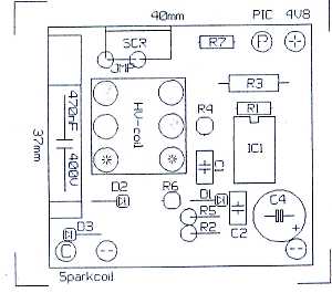

For a few years ago w don't have neodeenmagnets
We use the black less stronger magnets, you can see it on every older engine.
We use still the same hallsensor and the same components fot the HV-board.
So the only we have change is the neodeenmagnet.
I think this kind of magnets are much to strong for the sensor.
Inside the sensor there is also electrocs and thats very small.
Maybe we distroy with the neodeenmagnets a part inside the sensor ??
I think John is also over the years gone use the *super* magnets.
With the simple boards there are no problems, but now we use advance boards with microprocessors it can be a problem.

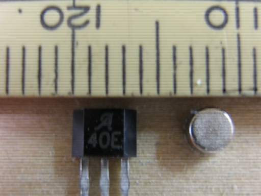

Mmmm, after some tests I found a little problem.
Magnetic tape have a NSNSNSNSNSNSNSNS at one side of the tape.
Depending of the size of the tape the NS can be 1mm or 5 mm or maybe more distance from each other
I have tape there is only 2mm between N and S, so I have to find me other tape.

On the hallsensor there is the next codes.
1026
9868
A (looks gotic)
20E
This sensor is much to sensitive, but with a peace of magnetic tape behinde the sensor you can make it less sensitive.
With the magnet John use, the sensor is switching within 20 mm.
If I put a little peace of magnetic tape behinde the sensor it will be 3 till 5 mm befor the sensor is switching.

This is the A3240 from allegro and the magnet I use. (3mm x 1 mm)

The a3240e will be the same i use a1120e, this is showing on the website.
They change the typenumbers, but the function isnt change.
But I still have some questions about the sensitive.
20 mm distance to switch is not wat i like.
Even with the tape the sensor pickup the magnet very fast.
I dont have any idea wat sensor will be the best.
Also use the black magnets can be positive, even to use tape.

Without a peace of magnet tape behinde the sensor, the switch time (on) of the sensor is ~30 degrees.
If I put a peace of magnetic tape behinde de sensor, the switch itme (on) of the sensor is only ~12 degrees.
A other positive effect of the tape, the sensor is shut off by the magnet at the backside of the sensor.
There are sopme articles on internet who discribe this.

John, have you try Jakes timersoftware with a LED or bulb instead of a HV-board ?
If the problem with Jakes software is there, you must have the same problem with a LED or bulb.
The LED or bulb have to stay on, same like the timer the HV-board is set on.
This test cost less, the (HV) transistor can't be damaged.

I start to make a stronger HV-board and hope also more reable.
No transistors and the HV will be shut off when spark is given and Voltage is high enough.
It will be a very small board and also less components, like your board.
The cost will be the same, there are no exotic components on it.
I only have to build a test unit, hope this weekend to be done.

My 2 cents in the kitty.
Well this is my first post on this web site but, I've been around for a while. I also have built several ignitions, mind you they were for drag racing and msd inductive with 40 amp coilcharging. Anyway, I agree with John that a one-shot should be used in this circuit (timing) along with a lot more filtering around the cpu and on the HV board. I see some people are trying to make this work without using an oscilliscope which is almost impossible. I also agree with John that there is a bug in the code with regrards to the ringing when the magnet is parked under the hall effect.
The big thing about hall-effects is that they are not like a inductive pickup where there is a rise and fall in the signal and there is no signal if the magnet is not moving. The hall-effect will remain on so long as the magnet is at the pickup, so the cpu sees on,now is the cpu looking for a 'change' or just 'on'. If it is looking for 'on' then this could cause ringing. With MegaSquirt we get a lot of cpu resets from noise, I;m not saying this is a problem here but, from the schematics I've looked at there is almost no signal filtering on the HV board other than pull-up and pull-down resistors which will amplify any noise though the coupling cap. I would put a 5.6v zener between the signal and groundnext tothe scr gate to pull away over voltsand C7 should be a polarized cap tohelp with surges.
All ignition coils produce ringing and it is not always easy to get rid of. Some circuits make use of a 'clamp' or a low ohmage current resistor, what works best depends on the circuit. All hall-effects have a gauss (g)rating that determines when the switch will pickup and drop out, this in turn determines the strength of the magnet needed and the distance between sensor and magnet.
