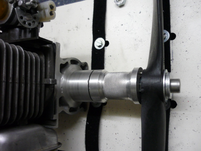

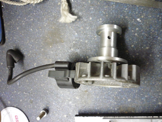

One of the HV boards has all the parts on the board, but I just bent the leads over to hold the parts in place. Be sure to check parts placement since I did it quickly to pack up the rest of the box.
I like how you trimmed the excess crankcase material from the Homie !! A first class job as always, looking good!
I just use a small grinder, but you used a lathe or milling machine the way the finish looks. My engines are always done in a hurry so I can test, I never take the time to dress them up like you have done.
My hall sensor gets mounted with a worm gear hose clamp so I can adjust the sensor timing, but it holds up very well for me. Other engines have places to use a bolt on mount which I will try to post a picture of for you. Again, not only way to do it, but it works.

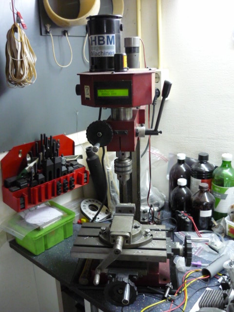

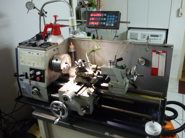

Becaus I have all the time untill ariving the parts, I can spent more time to the Homie.
The big work is now done........and everthing is now stopped for a 3mm (?) magnet I missing.
The smallest magnet I can get is a neodeen 5mm super magnet I can't use.
I have to find out where I can get a normal 3mm (?) magnet, maybe little train shop ?
It's a small lathe, 40cm (16") between the centers and the mill is a cheap Chinese one.
Nothing special, but I can do wat I want to do with the toys

I think I sent you 2 of the 3/16" diameter x 1/16" thick rare earth magnets in the box. I buy them 2 at a time from Radio Shack. Not sure if you have Radio Shack stores in The Netherlands. Either way, you will have 2 of them when you get the goodies!!
Nice equipment you have there Rob! I have a small Harbor Freight 7 inch lathe, and a Taig Micro lathe which I use as a milling machine.
John
