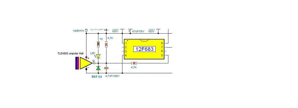

Joined: Jul 2010
Posts: 404
From: Alkmaar, NETHERLANDS
There must be a resistor to + power of 1 kOkm to keep the pin high and 100n to ground to filter the swtchmoment.
The pin is now open and pickup dirt.

Same to the table switch, put a resistor between power and the pin to keep the pin high.
Inside the PIC there are also pulldown resistors, but they don't work allways.
If using the intern pulldwon resoistor there will be over the pin and ground a resistant, a spike Voltage can set the pin high.
When pin high, the pin is switching, thats not wat you want, so make the pin high with a real resistor.

Hi John
<span lang="en" class="short_text" id="result_box"><span class="hps">I'm glad</span> <span class="hps">I could help</span> <span class="hps">you.
</span></span>
<span lang="en" class="short_text" id="result_box"><span class="hps"><span lang="en" id="result_box"><span class="hps">I</span> <span class="hps">ask you</span><span>,</span> <span class="hps">circuit diagram</span><span>.</span>
<span class="hps">What you're</span> <span class="hps">using</span> <span class="hps">the new</span> <span class="hps">software.
</span></span></span></span><span lang="en" id="result_box"><span class="hps">Because</span> <span class="hps">100nF</span> <span class="hps">capacitor,</span><span> high value, </span></span><span lang="en" id="result_box"><span><span lang="en" id="result_box"> <span class="hps">the Hall</span> <span class="hps">input</span><span>.</span></span></span><span>
</span></span><span lang="en" class="short_text" id="result_box"><span class="hps alt-edited">Fair good</span> <span class="hps">value:</span></span> 2,2nF-10nF
<span lang="en" id="result_box"><span class="hps">The</span> <span class="hps">100nF</span> <span class="hps">capacitor</span><span>:</span></span><span lang="en" class="short_text" id="result_box"><span class="hps">Change</span> <span class="hps alt-edited">ignition timing</span> <span class="hps">value.(</span></span><span lang="en" class="short_text" id="result_box"><span class="hps"><span lang="en" class="short_text" id="result_box"><span class="hps">Delays</span> <span class="hps">in the</span> <span class="hps">Hall</span> <span class="hps">signal)</span></span>!!!!</span></span>
Circuit me, so working. See the picture.(<span lang="en" id="result_box" class="short_text"><span class="hps">I am using:4,7nF+4,7Kohm, </span></span><span lang="en" id="result_box" class="short_text"><span class="hps"><span lang="en" id="result_box" class="short_text"><span class="hps">LED</span><span>, resistor</span><span>, not</span> <span class="hps">necessary</span><span>.</span></span>)
</span></span>
<span lang="en" class="short_text" id="result_box"><span class="hps">You</span> <span class="hps">circuit</span><span>, what</span> <span class="hps">works</span><span>?</span></span>
</span></span>
</span></span>

Nyemi, I am using a ready made ignition board, I only have to solder parts to it. I have no real schematic, but is the same as RCexl version 2 ignition. I will draw one as soon as I get time. Right now, doing repairs for customers, very busy.
Timer board is what is posted in the forum, ignition is basic RCexl CH ignition and are reliable.

Nyemi, your code is working very good!
Jake's code sometimes makes a misfire at high speed and timing changes slightly. Both work but your sensor input routine is more reliable for this circuit. I added Rob's switch filters to be sure of no problems and it works nice. Good job ! :-)
John

Slowly we finish the project, the time will be there for a real schematic and PCB.
I can't draw "something" and don't want to read 792 post back to see wat will be changed.
I want to start with the timerboard and "connect" the HV-board to it.
If some one will break the boards, HV and timer serperated, it must be possible.
Also for repair it can be very easy to break the boards a part.
Or make a sandwitch PCB to safe space into your box.

I can given you 50 more sites of CDI after 40 years work on it
Most CDI's on internet don't work, you need a couple of good people like we have now to make a good CDI.
PIC / AVR software is old or is not opensource, even so the hardware......all secret in epoxy boxes.
We want to make a CDI / TCI you can use with any engine, only changing the software / hardware.
The biggest problem is a reable HV-board with enough power and more professional.
It have to use less power, switch off when spark and switch off if ignitioncapacitor is full loaded.
If you put a candle under pressure the spark will be smaller if the pressure will be higher.
Our engines are low pressure, only race engine (they have allready a CDI) are high pressure.
We want also something more witch cheap factory ignitions don't have, like realtime monitoring.
We can all buy a cheap, 25 US$, CDI and our engines run better.
But I think when we can do more with the CDI and program, we can let the engine run like a rabbit [>:]
If we can make the CDI small, we can also make it bigger.......and can use them for real (mini) bikes / carts / aso.
BTW 1, my father was offroadracer, I grow up with a world champion (Hans Spaan) and my fist project I send to a electronicmagazine was in 1972, a transistor ignition and win a multimeter with the designe
There was good thinking about the prices......now one of the winners have thoose equipment, we al build with a wet finger [:-]
BTW 2, there is only one problem.....I stock in 2stroke, thats wat I like !
