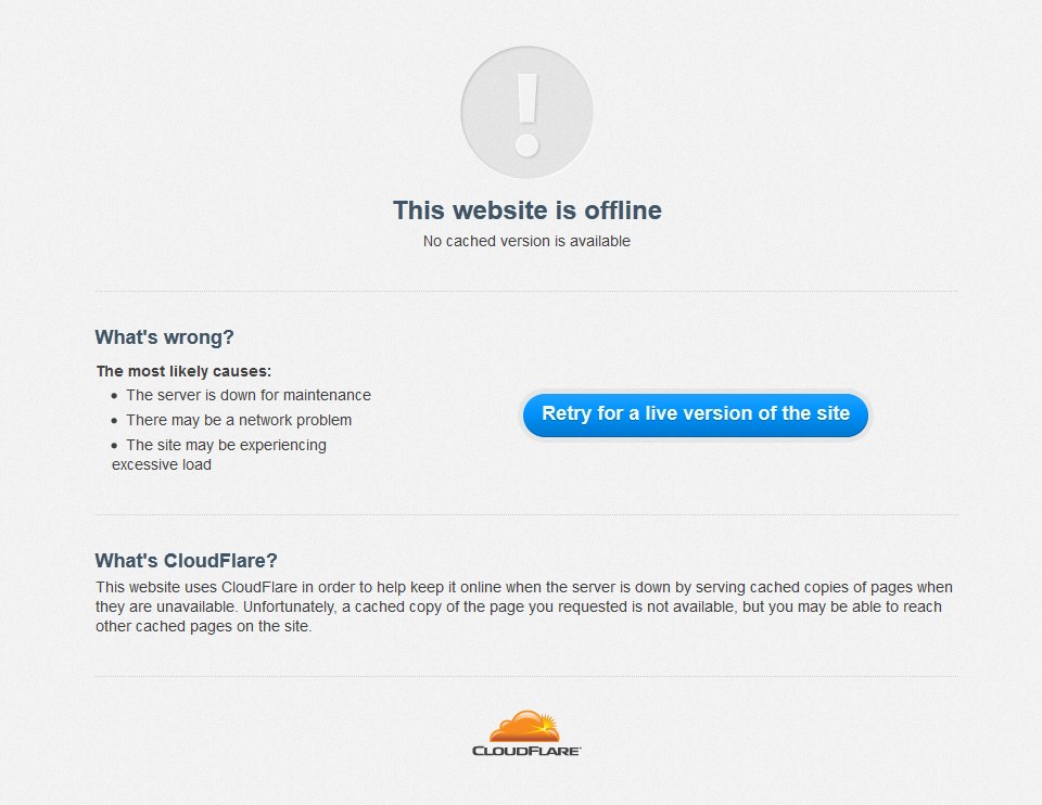

I got this message, but when I hit BLUE BUTTON, it started downloading ....
Any restriction of access from Japan, or my browser is a problem?
Anyway I got your file.
Jay.
Jay.

That's strange... I tried adding that Cloudflare thing since it was free and my host was pushing it. It's supposed to make things faster and MORE reliable! Guess it's just a bunch of crap.
I'm not aware of any location restrictions, except for India. I banned their country because they hacked me not too long ago. It's possible that some of the banned India IPs are blocking some people. If this happens you'll just have to email me for the file, I'm not going to let Indians hack me again.
If anyone else has trouble with it please email or PM me. If it causes more problems I'll have to get rid of Cloudflare or look over the banned IPs again.
