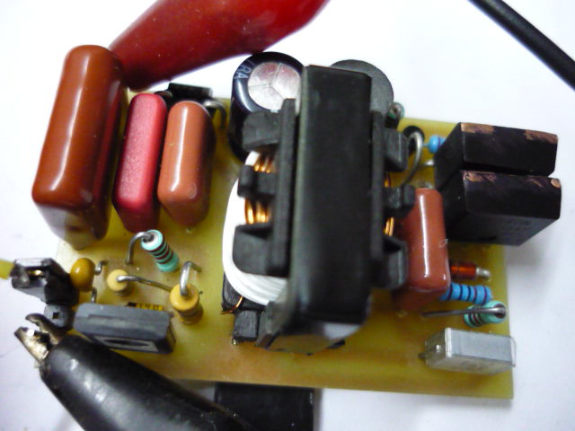

Jeff, I received some circuit boards in the mail from someone I sold ignition and timer kits to a while back. They are factory made, double sided good plated boards. I think they are very well made and can't wait to add components and test them. Wanted to post the bare board picture first so everyone can have a look before I do that.
If the picture doesn't look good, I'll take another. Let me know.
John
